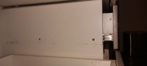

A Bunnings assistant suggested I tighten screws of dropping Kaboodle soft close draws. I have removed one draw. The screws just dropped out. How do I replace them when the holes are obviously now too big. Bigger screws? If so what size? Glue? Plugs? Are there custom sized for this Kaboodle problem? The assistant said the screws
need tightening every few years. Is this right? Can it be avoided?

Due to the dynamic loads a drawer will face, it is certainly possible that the screws for drawer runners will work themselves loose over time. This is unfortunately unavoidable as chipboard is made up of wood pulp that has been glued together.  As the team member has suggested it is good to tighten the screws periodically if you see any movement.
With drawer runners, your repair options are somewhat limited because the chipboard is fairly thin and any screw you use can't protrude from the other side of the chipboard.
My suggestion is to fill the holes with Builders Bog following the manufacturer's instructions for use. Once sufficiently dry, predrill a small hole in the builders bog that is slightly smaller in diameter than the thread of the screw. If you need assistance sizing a drill bit for pre-drilling, I'd suggest taking the screw to the Tool Shop and asking one of the team members for assistance.
Once predrilled, the drawers can be reinstalled using either Zenith 8G x 15mm Galvanised Button Head Stitching Timber Screws or the screws provided with the drawer runners.
