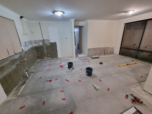

Hi all, i hope someone can shed light regarding render finishing of the kitchen wall.
Here in WA, based on research, we use hardwall/lime plaster after concrete render.
My question is that, are there other alternatives i can use prior to painting?
Concerned about the curing time, as apparently, above is 4-6 weeks?
Is there anyway to fast track that, or are there other alternative? Currently comparing Davco Render or Dunlop Acylic Render as both curing times are only 7days?
Thank you all.
