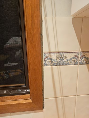

Hello! We have just moved into our new house and are finding unfinished areas all over the place like this replaced window with old tiles and a gap between. I'm about to paint the tiles to give a little refresh and want to fill in this gap- what would be the best filler to use? Preferably something I can paint over with the tile paint too?

I propose using Selleys 475g No More Gaps Interior Multipurpose Gap Filler. It can be painted over with either water or oil-based paint and is easy to use. Please note that this product requires the use of a caulking gun in order for you to apply it.
Here is a handy step-by-step guide: How To Silicone Seal A Bath (the techniques used are applicable to your project)
