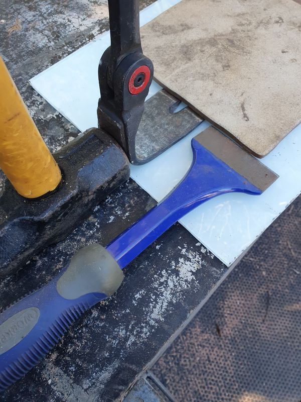

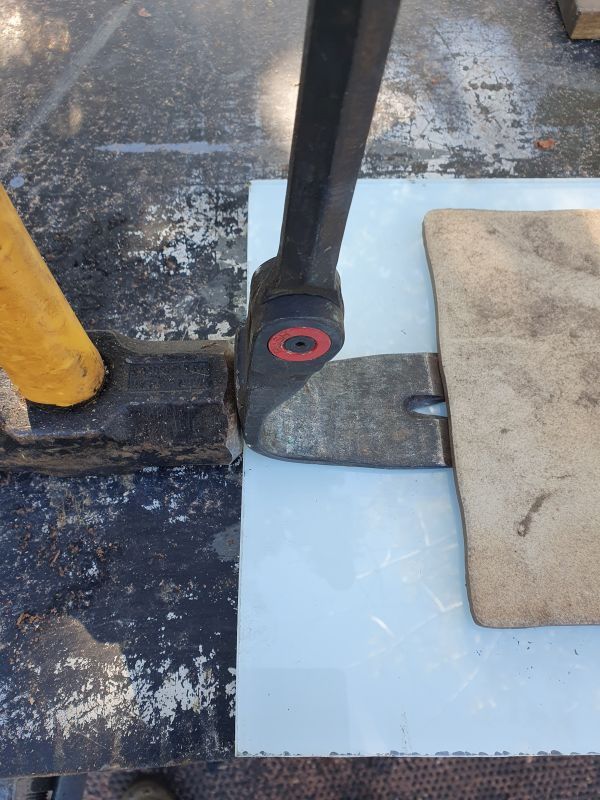

I am no tiler.
But I would think the adhesive on the white tiles would not have stuck that brilliantly to the polished surface of those old red tiles?
Dunno.
So maybe they will lift easily?
I personally would try a Cresent pry-bar with hammer.
If no success, move onto bigger guns.
