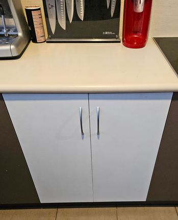

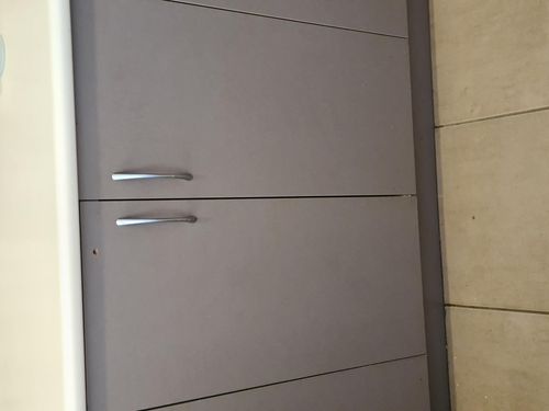

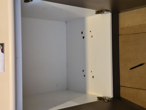

Thanks @EricL
Here are the photos of the cupboard area, still have holes in the bottom from a previous fixed bin. Sizes of the doors are 330 x 750 and the internal dimension of the cupboard 640 x 700, not sure why the photos don't want to be the right way around

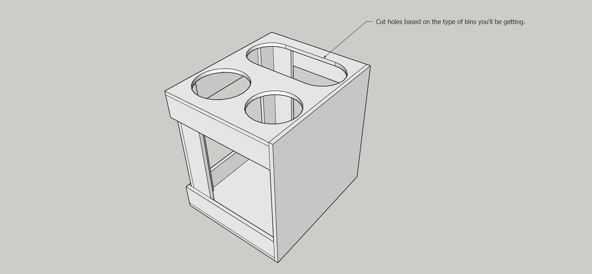

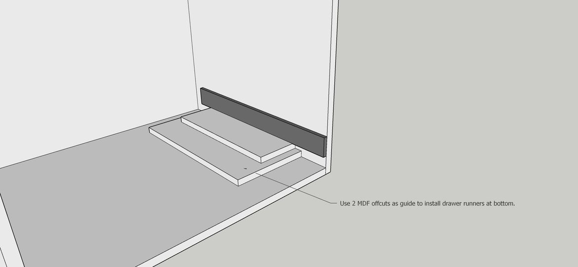

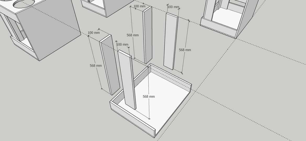

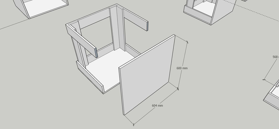

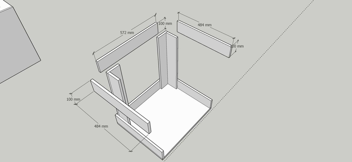

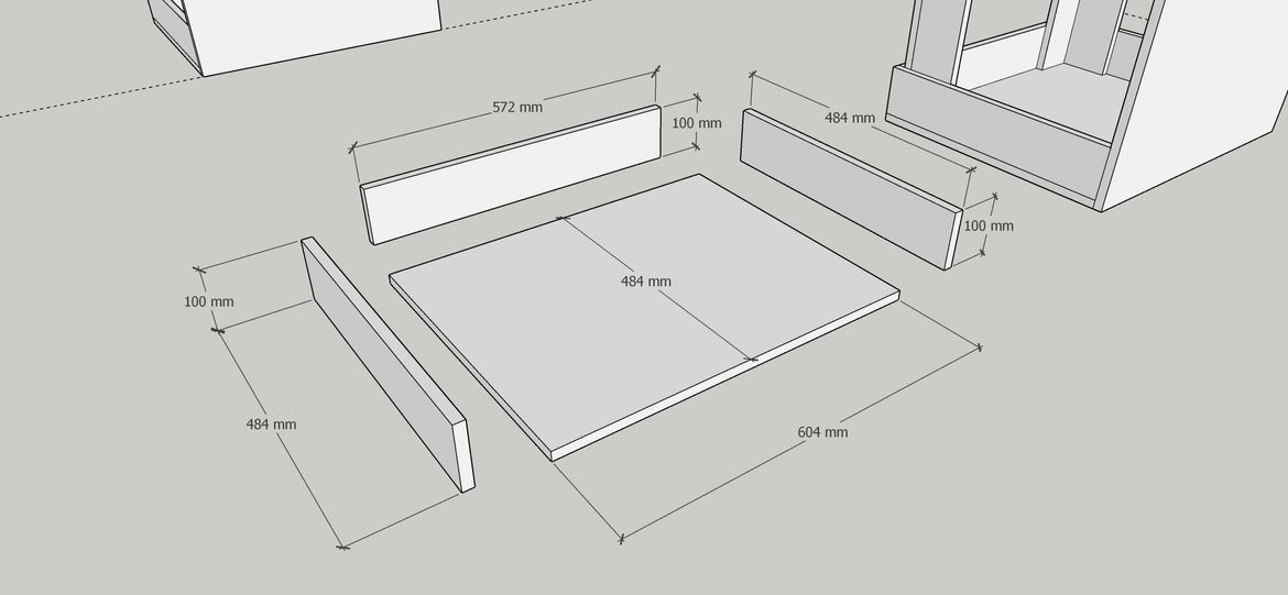

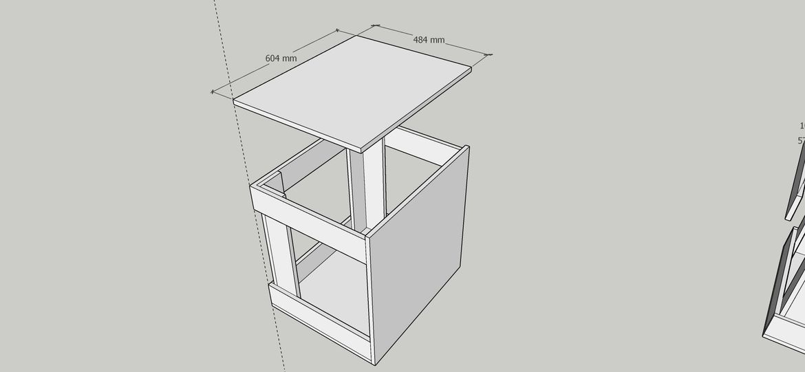

Hello @lockers
Thank you for your patience, here is the plan for your pull-out bin assembly. You'll need a single panel of 2400 x 1200mm 16mm MDF Panel Standard. I suggest gluing all the parts together with Gorilla 532ml Wood Glue. Any surface or end that joins together must be glued, be generous with its application. I recommend using Zenith 8G x 30mm Countersunk Rib Head Chipboard Screws in the 100 pack set.
My best tip for this assembly is to drill pilot holes and counter sink them to prevent splitting the MDF. If your drill has a torque feature, lower its setting so that it does not overdrive the screw and split the panel. Your kitchen doors can then be installed from the other side of the assembly. Make sure your doors are 16mm thick otherwise the screw tip will drill through the door. If in doubt use a shorter screw.

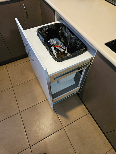

Hi @EricL and DIYers
So finally pulled my finger out and did the bin drawer using the easy to follow instructions from EricL. The doors look a little out of place at present as we are about to redo the kitchen with cabinet and bench top paints, so I though rather than remove the doors again when we do the reno I will just do them first. Thanks for all the help and especially Eric with the plans.
Re: How to create a slide-out bin cupboard?
Hello @lockers
Thank you very much for posting that update on your slide out bin project. That looks very nicely done and the best part about this particular design is that if you ever need to upgrade or change your bin, the top part that holds the bin can be taken out and a new one put in place.
