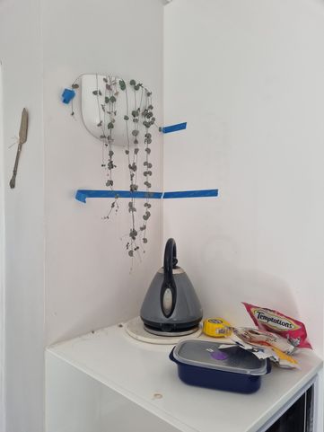

I was just wondering if anyone had any pointers on what to use for a DIY floating shelf. There are no studs behind the wall so it would be fixed to the plaster with measurements of L 400 x W 200 - blue tape to map it out. I ideally wanted to use a wood light in colour. Happy for any recommendations for the best way to complete this - and if floating shelf's are the way to go? i love the look but unsure if will be stable enough?
