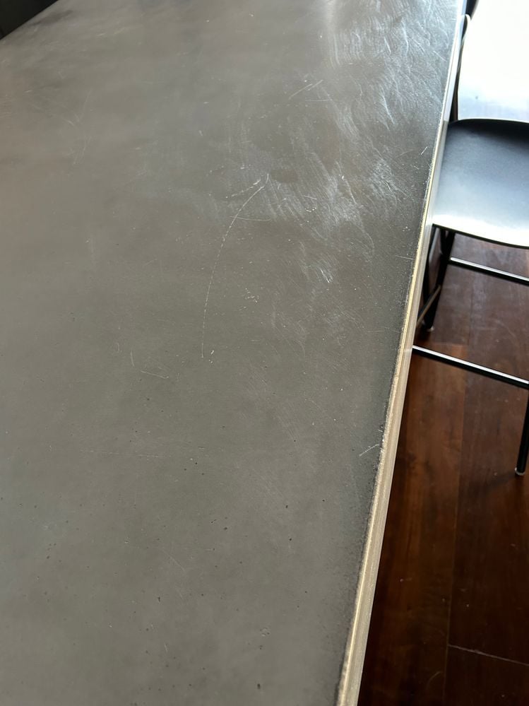

How to buff out sandpaper marks on resin?
I have a concrete kitchen bench which is finished with a resin. It has scratches and I asked the maker how to fix them. he suggested a light sand with 400 sandpaper and finish with a 600. It has now very visible scratches from the sandpaper. Can I buff them out with the Ryobi or is there a product that I could apply and rub in?
Re: How to buff out sandpaper marks on resin?
Welcome to the Bunnings Workshop community @KathyB2. It's brilliant to have you join us, and many thanks for your question about removing scratches from resin.
Were you able to remove the original scratches with the 400-grit sandpaper? If so, were you able to remove the 400-grit scratches with the 600-grit sandpaper? If so, you need to keep progressing to remove the 600-grit scratches. Around the 1200-grit mark there will be no discernable scratch marks. You must remove all the previous scratches before moving on to the next grit. I'd suggest you pick up this pack which includes the 800 and 1200-grit.
Once you hit 1200-grit, you can look at buffing the surface if you desire a gloss finish.
