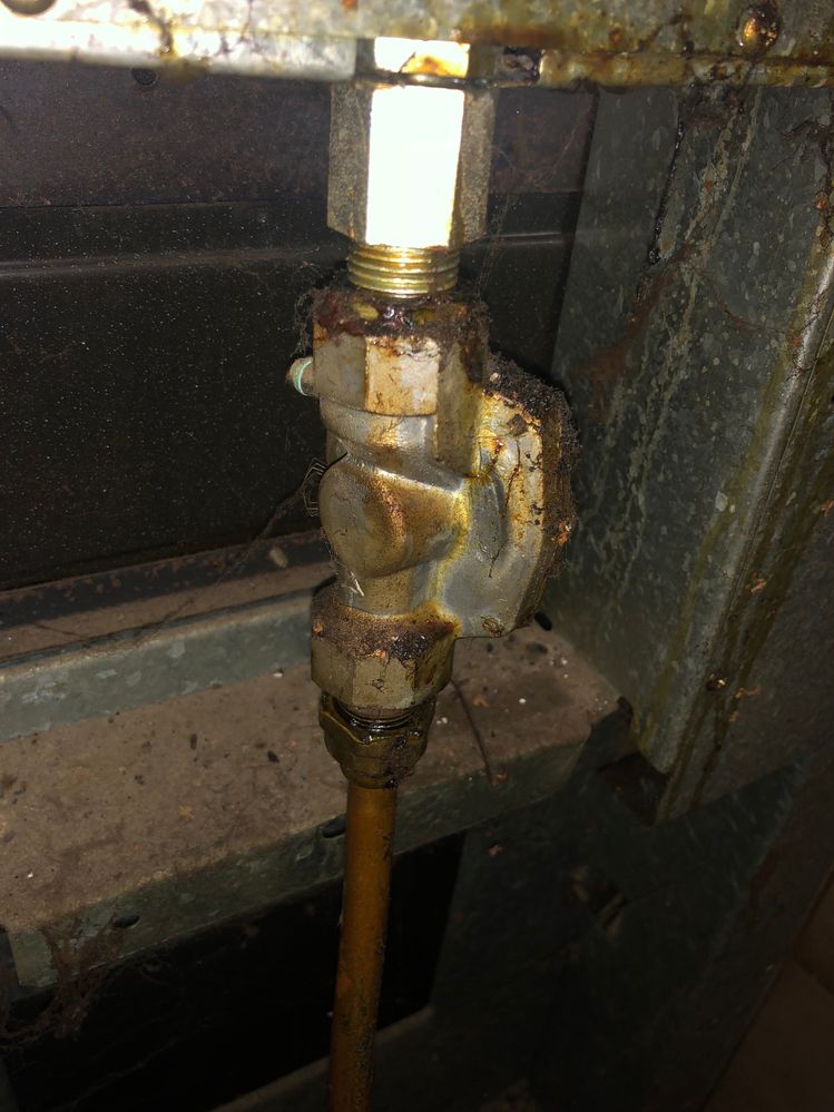

It has an old Westinghouse Old Kooka gas stove pictured below. Things are pretty dirty behind there (as you can see) so I was hoping to disconnect it, move it out and give the area a good clean/paint. Can the disconnection be done by me or does a licensed gas fitting technician need to be involved?
If it's safe for me to do, apart from turning off the gas at the front of the house, which of the two threads am I unscrewing at (upper or lower), and do I need any special equipment other than the appropriate size spanner?

All this should be done by a licenced gas fitter of course.

As per @Brad's helpful message, always use a licensed gasfitter for any installation, repairs or renovations involving gas work. Don’t ever undertake gas work yourself or to use a tradesperson who does not have specialist gas knowledge and skills.

That's very helpful thanks Brad! Licensed gas fitter it is!

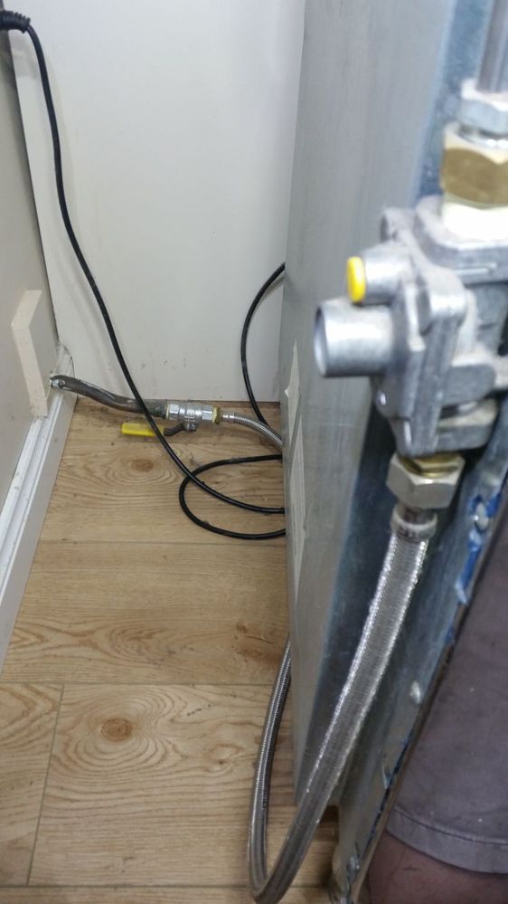

Hi Rohan.
I'd also consider getting rid of the rigid vertical copper pipe by using a flexible hose and adding a tap so you don't have to turn the gas off at the mains for future renovations or an oven change. A fexible hose allows more movement for positioning, cleaning and access to the trapdoor to the meth lab.
