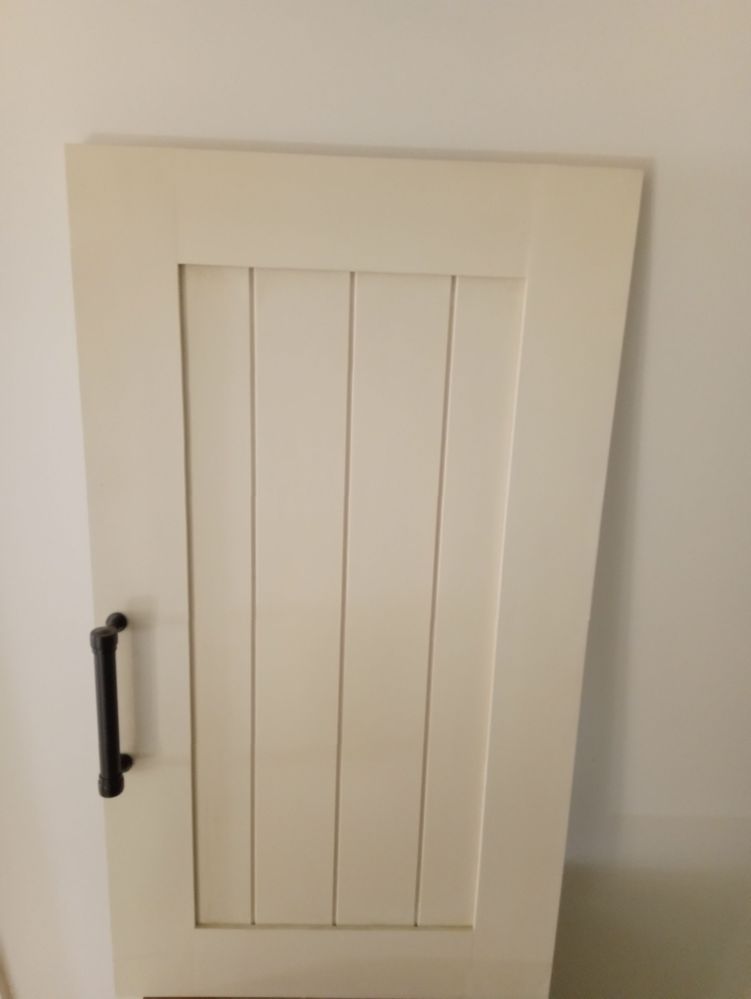

Yes, here is a picture of a prototype I did to see if I liked it (I happened to have a spare door from the original kitchen build):
Alas, it also proved you are correct in that the extra thickness will cause fouling. However I was able to prevent the fouling by adjusting the hinge, this depends on your particular hinge, but if you want to try it simply clamp a small piece of the proposed trim, say, in the bottom left hand corner of a door that swings out to the left, or to the bottom right of the door if it swings out to the right - that will give you an idea by how much the trim fouls the adjacent door, then adjust the hinges to suit (on mine that is the adjustment screw nearest you). If that looks like preventing the fouling, than hold another small piece of the trim on the adjacent door and adjust again to suit. Alas this does change the spacing between doors which may or may not be acceptable.
In truth this technique appears to be most suited to framed cabinets, and I assume yours are European style non framed. Cheers.
