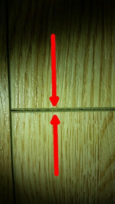

Looking for tips on closing gaps in floating floor panels - don't wanna pull it all apart and start again. There's just a few of them in a hallway near the kitchen. This is where we started and where most errors appeared as we were complete novices at the time with regards to floating floor.
Hard to see on the photograph - but they're (the gaps) probably only half a millimetre.
They're 10mm boards and not of a high quality. As we learnt we got better and had no problems, but when we went back to where we started we could see where we went wrong.

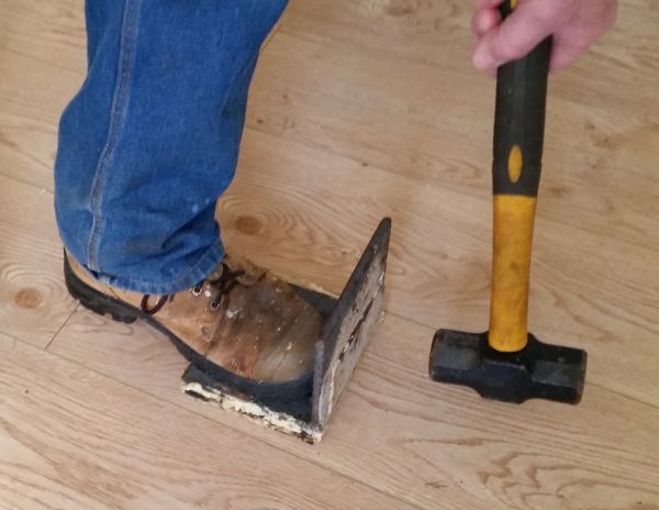

I'm thinking of utilising friction > large L plate steel, rubber and a sledgehammer.  :smile:

Your picture tells me that it is really not 'that' noticeable and with luck it may even fall into place over time.

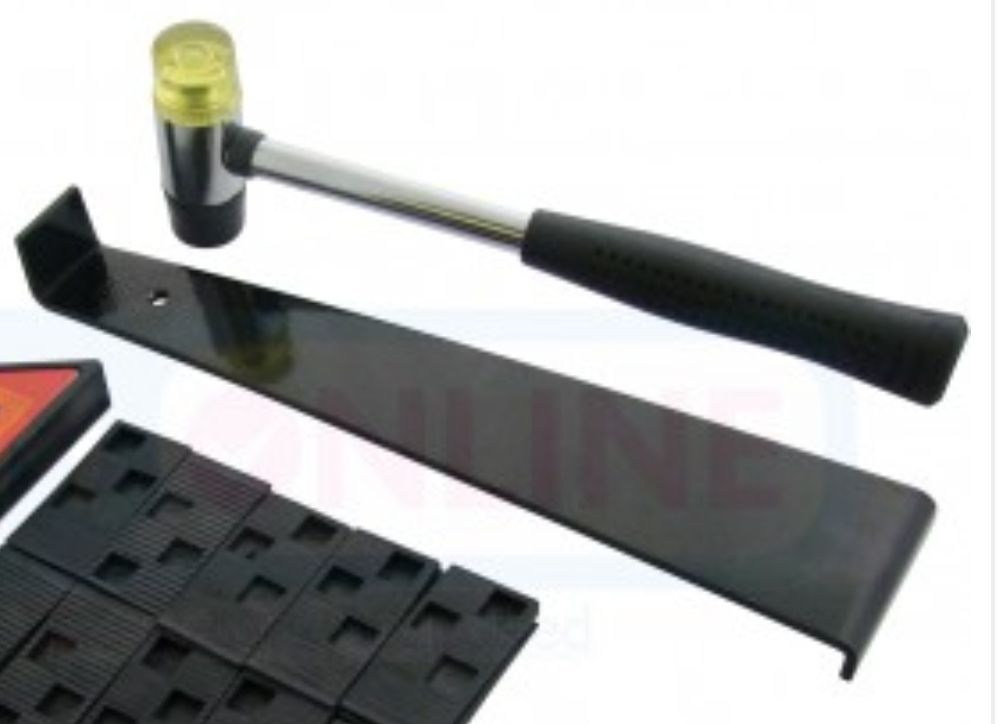

PJA - what's a "Z-Brace?"

@ProjectPete"Sometimes you can get lucky with those gaps/joins and give them sort of a sliding kick with your heel going toward the joint to knock it into place."
Based on that idea I found a solid (10 mm thick ) piece of angle iron and glued a 12 mm thick piece of rubber to one end with polyurethane glue from Bunnings..
By standing on it and smacking the other face with a hammer I thought I could shift the board. But no  - the only thing that shifted was me - just not enough friction between the rubber and the board.
About to give up but then tried washing the rubber surface with turps - which made it tacky and sticky.
Managed to close the gap! :bigsmile:
The only thing is that sticky rubber surface is only good for one smack - you need to keep reapplying the turps as the rubber surface quickly becomes contaminated with dirt/dust.

Z Brace is the black thing next to the hammer Screenshot_20180909-200436_Chrome.jpg
