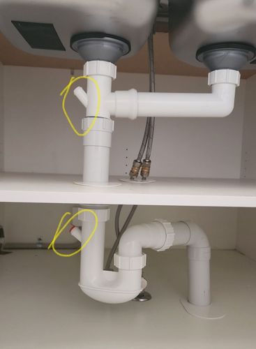

Turns out, the waste spigot undersink hasn't been drilled out (although it had a small red cap on it).
My Query:
1. Can I go ahead and drill out the waste spigot undersink so that dishwasher drain can be connected to it ? Or is it something
that only a licensed plumber "should" do?

Congratulations on moving into your new home and installing your dishwasher! The good news is yes, you can drill into the spigot so that you can connect your dishwasher outlet. My only tip is to drill carefully so that you don't accidentally over drill into the side of the spigot. Just remember to drill just enough that it allows the water to flow out freely.
However, if you don't have the necessary tools or wish to have a professional trades person do it. Then it's best to hire a plumber to do it for you.

I am planning to use a 13mm drill (hope it would be sufficient).
Can you please also advise if I can use any one of the spigots? (I'd rather prefer the top one as it give me more room/access for drilling the spigot out).

Using a 13mm should be correct if it fits inside the spigot. Also, drilling out and connecting onto the top spigot would be fine; just make sure that the height complies with your dishwasher installation guide.
