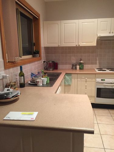

The time has come for the big kitchen renovation - but I'm not sure our current plan is utilising the space efficiently. This is our kitchen & dining area and we like to sit around the table, so we need space for 2 adults & 2 kids to sit. We want to keep the costs down so we're looking to keep the dishwasher, sink, & oven in the same locations. See photo for our planned layout & room dimensions, with island extended out to form a table with bar seats. I'm thinking that the island would be cupboards (as shown), plus 400mm drawers (couldn't add them in kaboodle). The door on the left goes outside, the doorway at the bottom of the plan goes to the lounge. Any suggestions for how this space could be better utilised?

Thanks @MitchellMc! We had thought about removing that wall but ruled it out because (1) cost and (2) the lounge isn’t much bigger than the kitchen, and the doorway is already partially covered by a couch, so we didn’t think we’d gain much by removing the wall.
Love the rendering. I see your point about having an island as a main dining area - combining kitchen & dining in a small house is very tricky!
