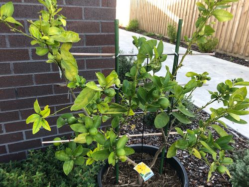

I have a question re lemon trees.
I bought this tree almost 2 years ago. For some reason, this year the tree has gone haywire and is constantly flowering and making lemons. I have been constantly pulling off the tiny little “lemon bulbs” so the tree can concentrate on growing the existing lemons on the tree.
You can see the leaves on half the tree is quite yellow (with green veins), which saw me add more fertiliser (and that I suspect send the tree into more flowering/lemon producing mode).
How do I fix the yellow/green leaf issue as I don’t think it’s fertiliser issue (pellet fertiliser for lemons I bought from Bunnings). Is it also a bad idea to throw the tiny lemonlets back into the pot (my thinking was, the tree spent the energy to create these things, throwing them back into the same soil, the tree can take the nutrients back??)

Could you please let us know what the fertiliser was, how much you applied and when you applied it? It would also be helpful to know how often and for how long you water the plant, and how much direct sunlight it receives throughout the day.
I suspect it is a nitrogen or magnesium deficiency causing the veiny and blotchy looking leaves. However, after applying a complete fertiliser like Scotts Osmocote 500g Citrus & Fruit Controlled Release Fertiliser at the prescribed rate, I would expect to see some improvement after a few weeks.

I bought this fertiliser - the words “premium fruit and citrus food” and “lasts 2 months” was the decider in getting this fertiliser (first time I tried growing lemons).
I shook maybe 2 handfuls out and spread them around the outer ring on the pot earlier this week. It’s east facing atm so gets the afternoon sun until the sun sets so I would say good few hours. I guess I can move it further to the front where it will get all day sun but then it’s not as protected from the winds. It gets watered every 3 days. It gets watered when the leaves of my chilli plant starts to droop. I usually count to 10 for each plant before moving to next pot in my watering.
Should I remove more tiny lemons so the tree isn’t expending so much energy?

Black marvel is applied at 50 grams per square meter, so two handfuls, roughly 75 grams each, would be more than enough. In fact, if you can, I'd recommend tipping the pot upside down and removing some as that would be close to twelve times the amount needed. Three-quarters of a tablespoon would be sufficient. As you only applied it earlier this week, I wouldn't expect to see any improvement as yet.
The amount of sun it is receiving, although not optimal, should be enough to keep the plant healthy. However, I would suggest you change your watering regime to once a week as a thorough soaking until the water runs out the bottom of the pot. Only water if when you stick your finger in the pot, the soil is dry.
The plant is producing fruit because it is able to, but you can remove the fruit if you wish, and that will store more energy. The production of fruit is not directly related to the yellowing of the leaves.
You could try some Yates 500ml Citrus Cure Zinc & Manganese Chelate at the prescribed rate on the packaging as the plant might be deficient in those elements.
Let me mention @Adam_W and @Noelle to see if they can offer their diagnosis.

Hi @Rach23
@MitchellMc has given you sound advice re the Black Magic and also the zinc and manganese chelate product from Yates. The yellowing of the leaves with green veins makes me think there may be a magnesium deficiency present. If the fertiliser and other treatments don't make any improvement to the tree's appearance, try good old-fashioned Epsom Salts (magnesium sulfate) at the rate of 1 dessertspoon dissolved in 9L (standard watering can) of water.
Citrus in pots need a couple of good soakings per week over the warmer months - water until excess drains out the base of the pot each time. Over the cooler months, do the finger test before watering - if the top of the mix is dry to the second knuckle, add water.

Thanks @Noelle @MitchellMc for the advice!! Will keep an eye on it and if the fertiliser and the sun (I moved it to an all day sun spot), will try the chelate or epsom salt.
