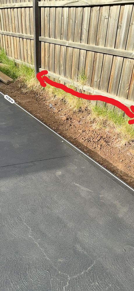

Thanks Mitchell for answering my questions. Regarding the retaining wall / planks, I have uploaded a photo. The area marked in the red (on the fence between two fence post) is where I am thinking of adding another plank of wood to save the fence from soil. Not sure if it is needed or not.
Area on fence marked in red
I definitely recommend putting in a sleeper panel at the back to prevent putting any pressure on the fence. This will also save it from timber rot and moisture.
