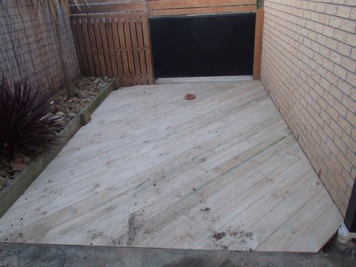

If it's solid you could float a decking boardwalk over it if that's the look you wanted. Would be simple enough to do.These doobies make that sort of project easy as you can just put them in place and then slot the bearer in to get started.
The other option is a sleeper boardwalk and then stain that the colour you want. They are actually super easy to make.

You might like to take a look at some of the modular decking solutions that we offer. There is a decking buying guide and also a D.I.Y. step-by-step tutorial on How to build modular decking. This could be a good option if you would like to go with leaving the path in place and covering it over.
