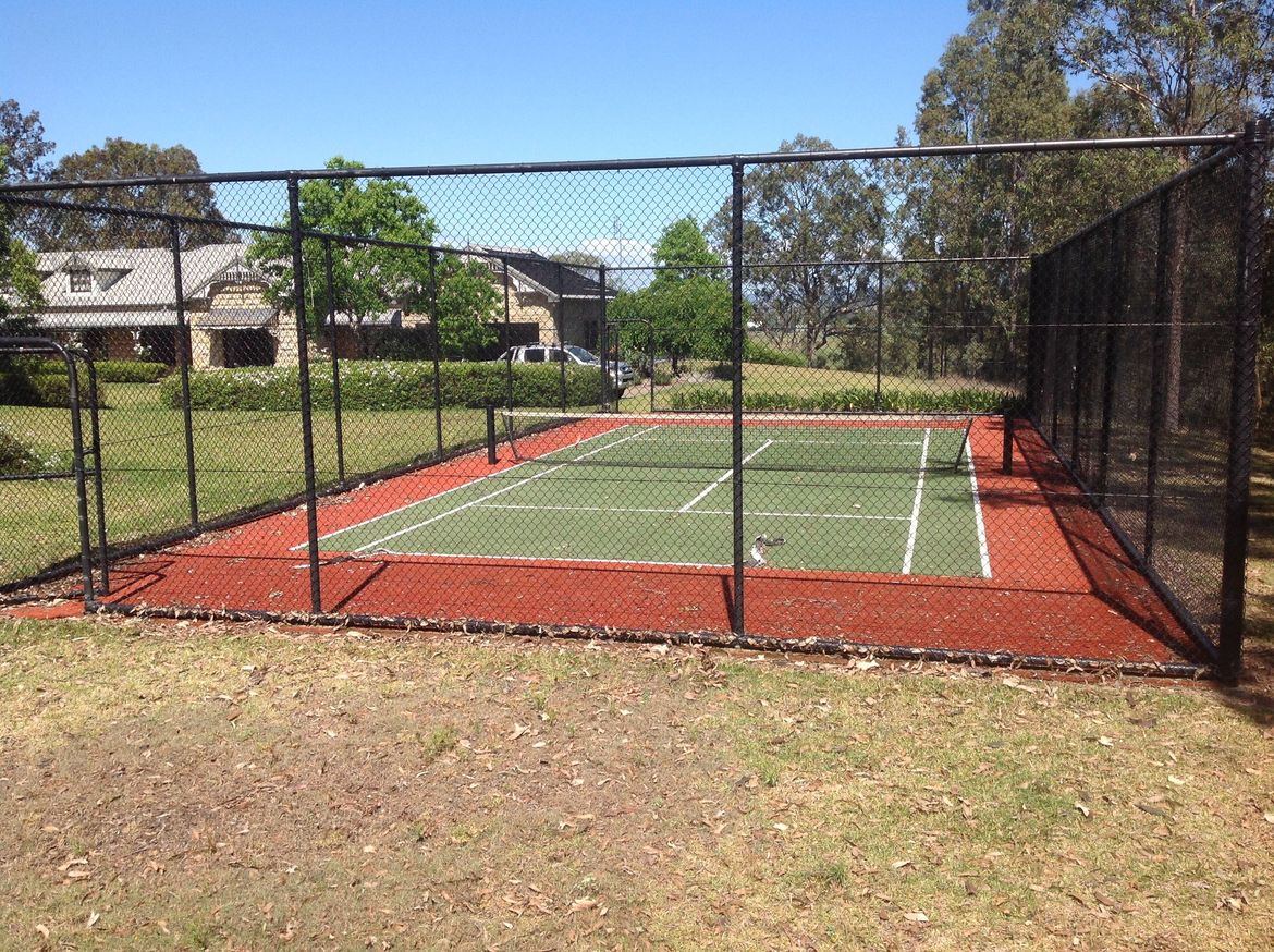

We purchased our final home in the Hunter near Singleton in early 2019.
As the cook in the family I was always keen on growing my own food and wanted a serious vegetable garden. It needed to be fenced (to keep out the kangaroos) and netted (to keep out the birds and large insects). We had a half sized tennis court and after a few games realised that that game wasn't for us.

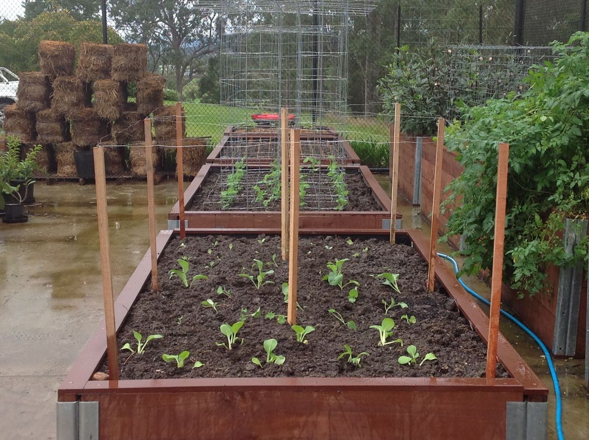

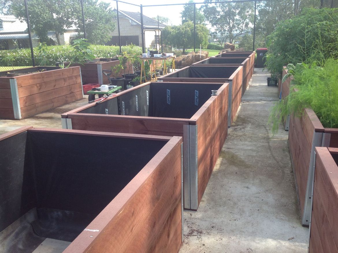

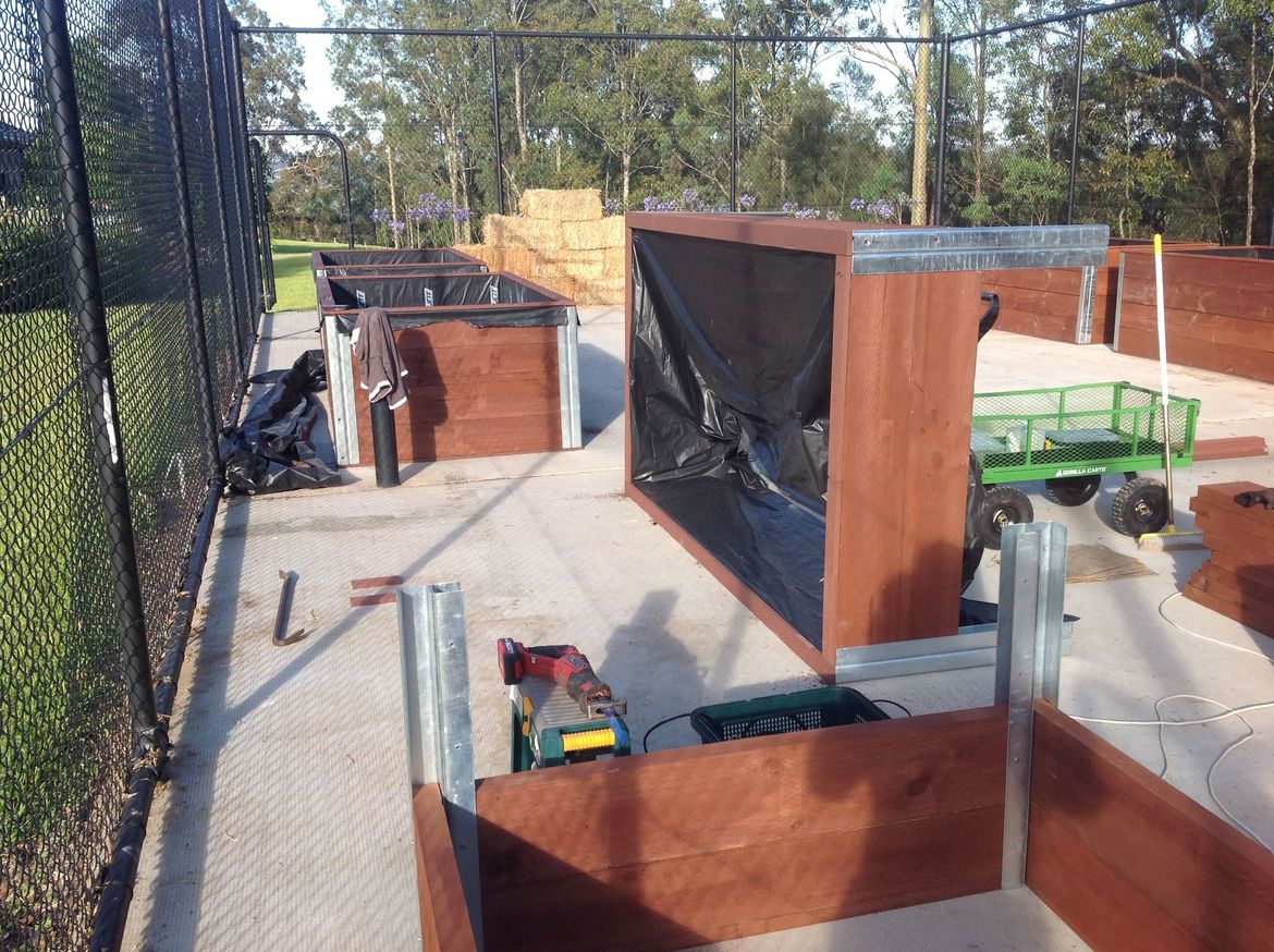

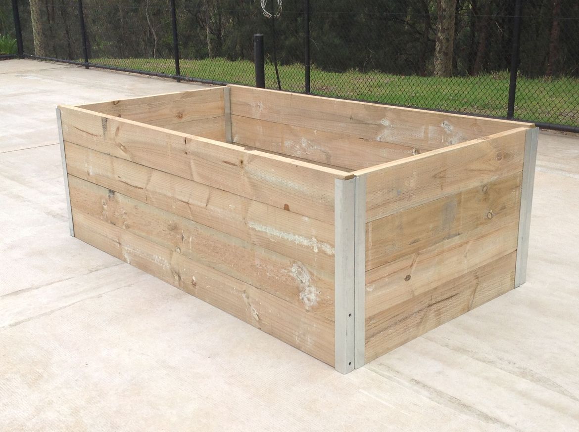

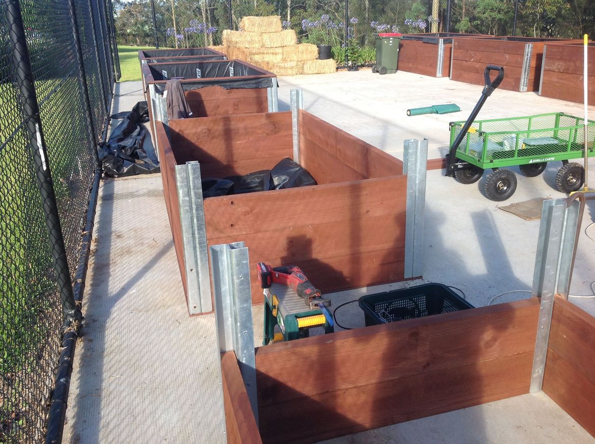

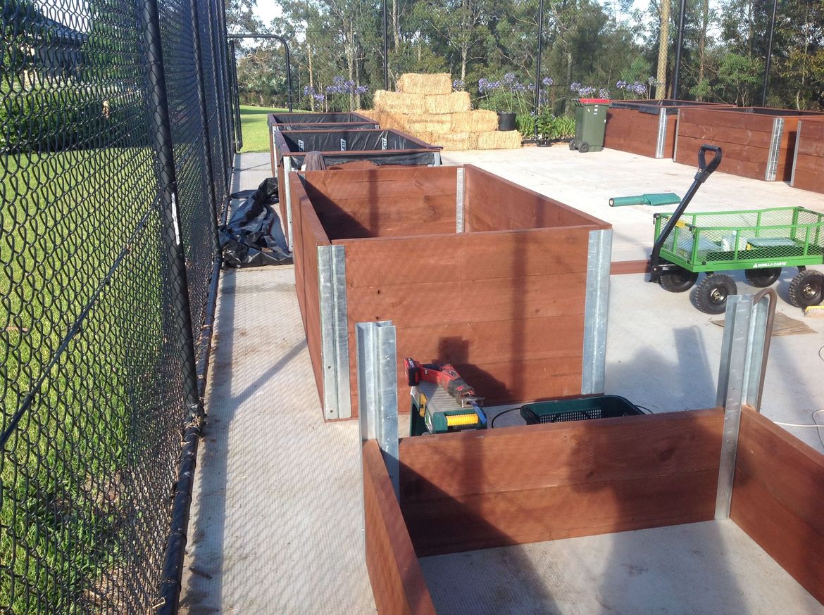

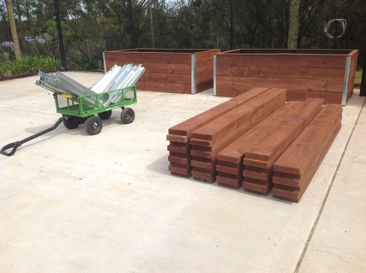

So I decided to transform the space into a kitchen garden. Work began in October 2021 ripping up the Astro turf and leaving bare concrete. Next construction of the garden beds began in 4 stages in December 2021. Most of the garden beds are built with 8 treated pine sleepers 2400 x 200 x 50 mm and 8 sleepers 1200 x 200 x 50mm. These sleepers are stained and secured with corner posts with final demnsions of each bed being 2400 x 1300 x 800 mm.

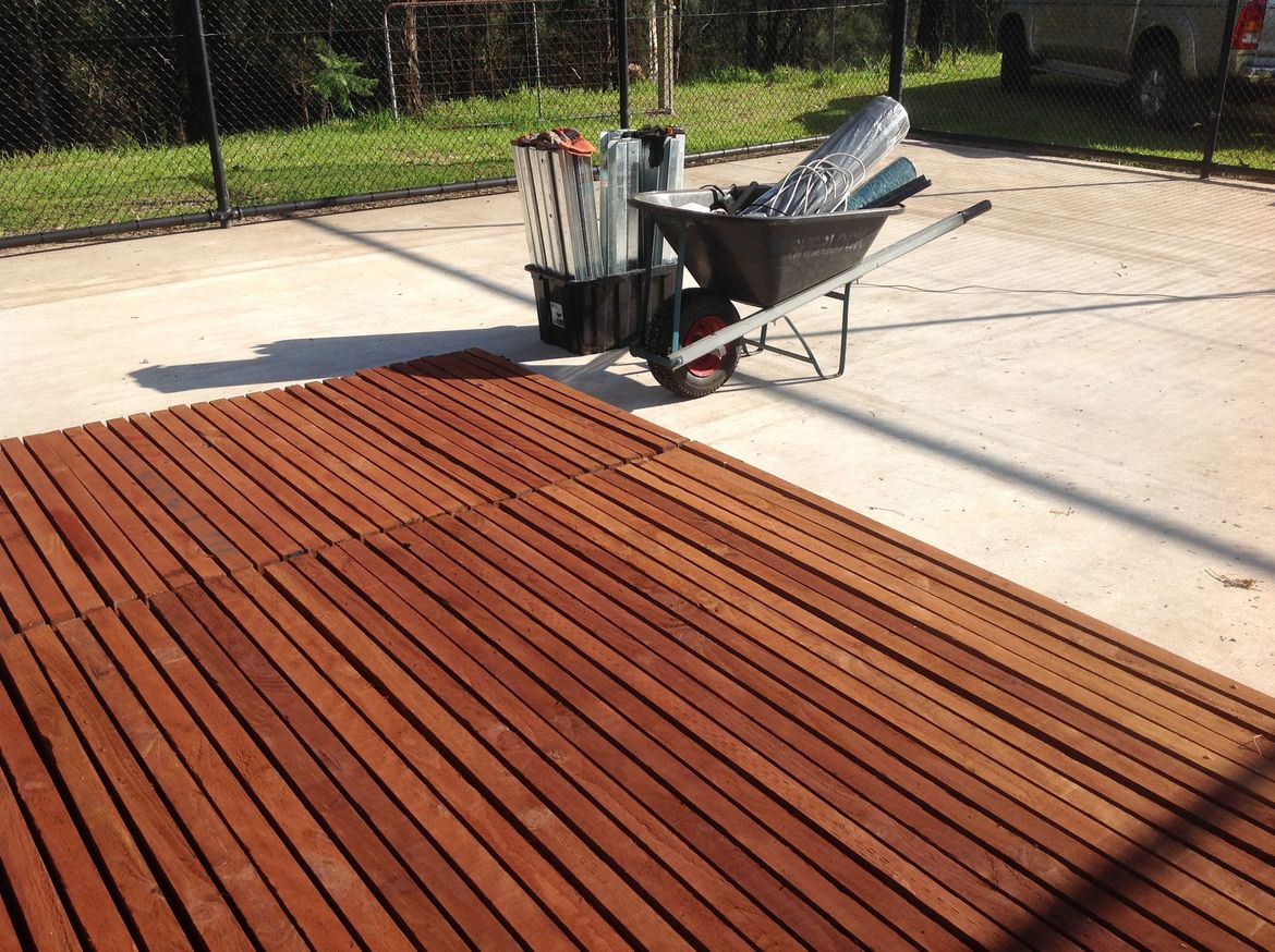

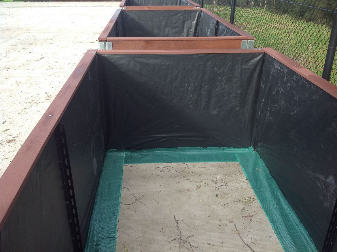

The beds are lined with building plastic with a layer of ecodeck top and bottom. They are braced with some stainless steel rope (to stop spreading on the long side) then filled with layers of compost, soil, manure etc.
I have recently netted the existing fence and over just installed framework to support the layer of mesh over the top of the enclosure. The next step is the netting over the too of the enclosure.
So far 16 of 22 beds have been completed and growing crops is well underway. My aim is to grow just about every type of fruit and vegetables that we eat inside this enclosure. Currently we are self sufficient with about 6 different types of winter and year round vegetables.

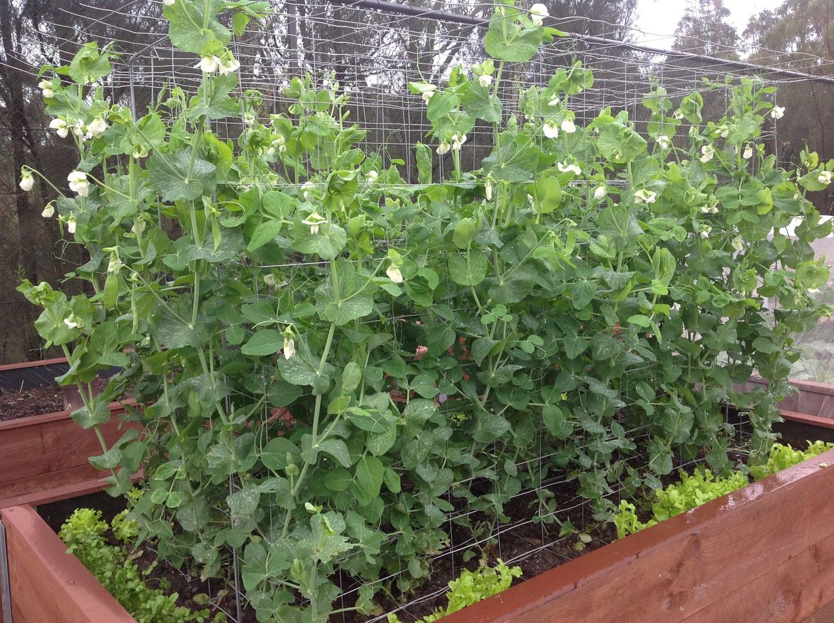

my favourite vegetable to grow is eggplant and they are great to cook with so can't wait for spring to get planting. Asparagus is fabulous once it gets going and mine despite being only 8 months from seedlings are already supplying us with spears. Lettuce is very useful as it grows all year round and if you have the right varieties (not iceberg) you can just pick individual leaves as you need them.
Re: Tennis court transformed into productive kitchen garden
Harvesting lettuce and perennial spinach all the time. Have just started harvesting winter verges winter veggies specifically: kale, bok choy, broccoli, and sno peas. The asparagus has started early (it was supposed to wait a couple of months) and very soon we will have cauliflower and brocolini. Cabbage in about a month.

It's just H4 treated pine sleepers from Bunnings.
the sleepers however are isolated from the solid by a layer of builders plastic and that plastic is held down too and bottom with a layer of Eco deck and lots of staples.
I thought long and hard about drainage and in the end excess water just leaks out of the bottom between the Eco deck and the concrete base. So the timber doesn't touch the soil and doesn't get wet feet.
i have some erosion control matting around the bottom inside of each bed to prevent solid from betting out and the first layer in the bed is just plane sand...
