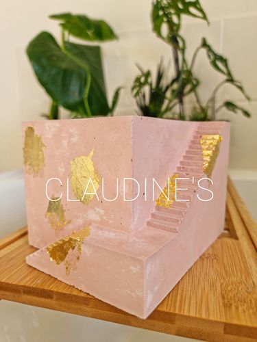

Hi everyone,
I've started making planters and have made my own mix using white cement and sand. I'm still finding that it cracks after drying and sealing so I'm looking for a better cement to use or ratio. I'm looking for a smoother finish (as you can see mine is a bit drier). If anyone can recommend a cement similar to Easy Mix Ivory Cement (as I can't purchase it from where I am) that would be really great. Alternatively, if you know of a better ratio mixture using other white cement, that would be great too.

The ratio I was using was 2 parts cement to 1 part sand. I previously tried 1 part cement to 2 parts sand but the product ended up being too soft in the base and way too much sand coming out of the pot.
