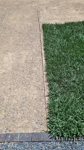

Just thought I'd jump back on here as I did this edging some time ago.
I ended up going with the treated pine sleepers and connecting with metal plates.
I also used bitumen membrane on the bottom areas/main areas where moisture touches.
I did have an issue with one of the sleepers that cracked right through prior to installation (was only around 5 days) but bunnings was fabulous at replacing it for me.
So far I am seeing some cracks from the wood appear on the areas exposed to the sun so will likely soon look at filling those and then maybe staining or painting.
Update on how the back yard has gone so far

Looks good Clean, tidy and it fits!
Would you modify anything if you did it again?
Nice holding up for a year tho!
I would absolutely change some things, however I guess that's all part of the journey!!! Still lots more to do though!
