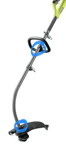

Hi there
I'm going out of my mind with frustration. My Ryobi whipper snipper has two points where no matter how much you tighten the screws/wingnuts etc, the handle and guard will slip and move around the pole. It's out of warranty but I really want to sort this out. I've attached picture where I'm meaning

But no issues till now? No missing nuts? Any nuts/bolts have stripped threads?
Any chance of close-up photos of these areas?

Just a quick thought @DeeS
If the nut/bolt/screw at the handle is not compromised and the plastic intact - maybe a piece of electrical tape wrapped around the metal will provide that tightening diameter required. But why this is happening for you now - I don't know.
Bicycles are notorious for odd diameter steel tube - and I've found electrical tape great for fitting some bicycle accessories.
But I don't know what's happening at the cutting end of your Ryobi.

I've run into the same issue with my line trimmer and despite numerous attempts at tightening the fittings it still slides. I've managed to fix it by applying large strips of rubber band to the pole and sandwiching it between the plastic assembly. My best advice is to use large wide strips not the thin type of rubber band.

@Noyade Thank you for your help. I haven't had a chance to take some photos, but I like your idea about electrical tape. Or like the other poster said about rubber bands

@EricL Thank you so much for your response. Yes I'm thinking I could give that a try. I'm surprised not more people have this issue. Or do they ? Ryobi have a complete different mechanism now on their line trimmers I noticed
