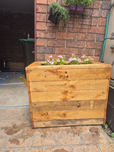

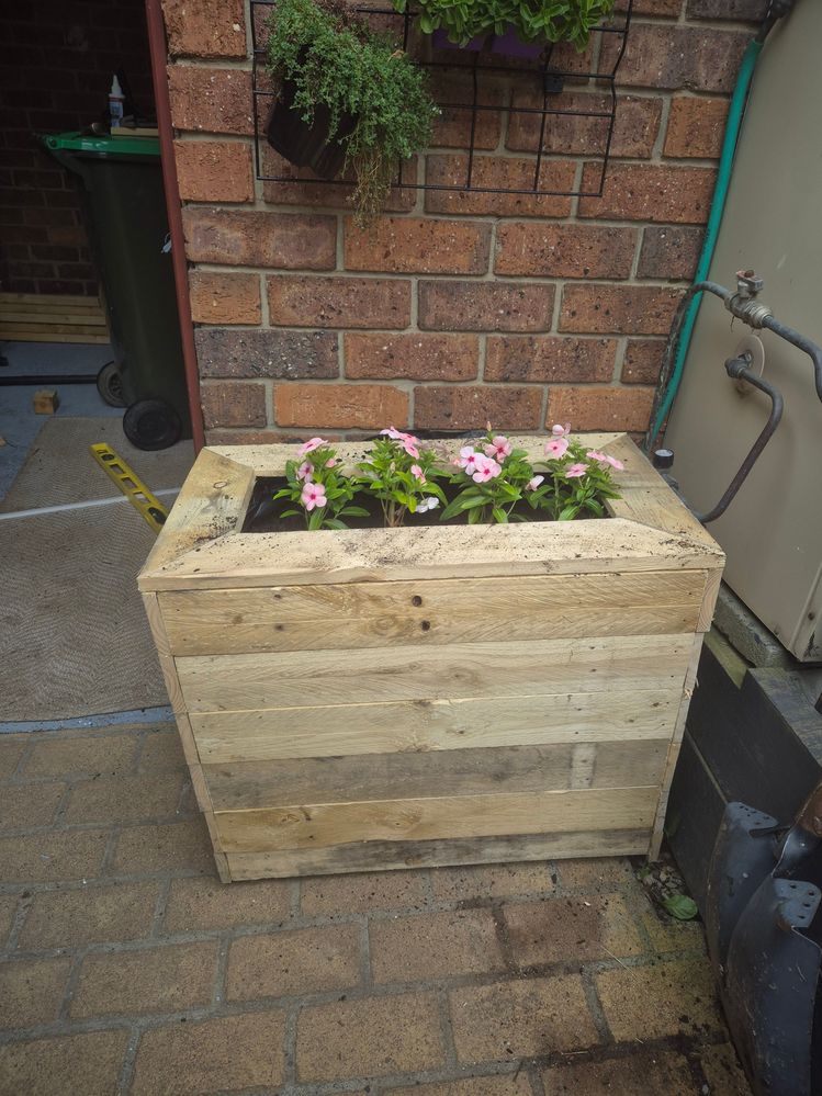

Picked up 3 skids from the trash at the Ringwood and Bayswater stores, broke them down and cut to size with an Ozito Mitre saw.
I had some merbau panels left over from my deck that I used as a base inside the box. The base is held up by some legs I cut and attached to the frame. Banged it all together with some pin head nails and wood glue. The aim was to only use what I had on hand.
I lined it first with weed mat and secondly with plastic liner, both purchased from Bunnings. I fastened it with an Ozito staple gun. I put holes through the liners to allow water to seep.
I'm terrible with mitre cuts and measurements so the topper is a bit out of whack but perfectionism wasn't a requirement.
I will put some spacers under the legs to lift it up to prevent it sucking up rain water.
I'm considering oiling it but I like the natural look. Thoughts?

That is an excellent use of throw away pallets. Your mitre cuts look fine to me, and they fit very well together. If you have some decking oil left in your shed, I propose oiling the surface of the planter box as this will add an extra layer of protection and extend its service life. If you don't oil it, it will start to loose its bright timber finish and start going grey as it ages in the sun.

@ndz1985 , Great job, well done , I agree with @EricL , oil it and coat it it with decking oil too, I made a planter box using pallet material similar to to yours, it warped within in few months out in the weather, it was was left in its natural state, I should have oiled it to protect the raw material, lesson learned 😪

Thanks both. Here is the finished product with 2 costs of oil.
