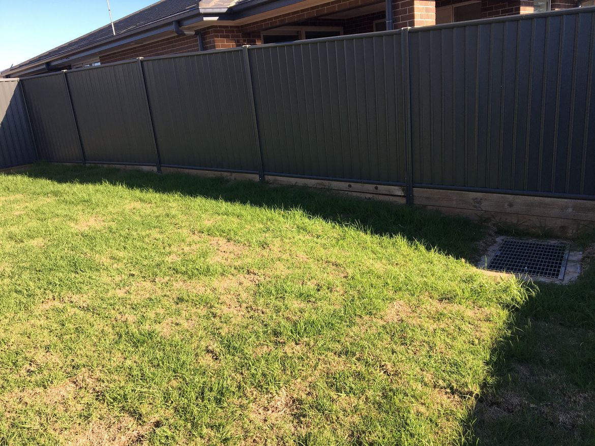

I have a stromwater drain and pits at the back fence of the house (pic attached).
What plants/shrubs, I can and cannot plant. Also, I am looking for ideas to hide those pits.

I have attached a picture of the strom water drainage pits, I was thinking to put a retaining wall at the back and create a veggie garden. Do you think this will be feasible or I will be looking at issues in 5years time.

Hi @bronelchristian,
If you take the leaves and branches on a plant and flip them upside down, that is at least the equivalent amount of roots they will have. So your veggies should all be fine and when picking shrubs just make sure you keep to dwarf varieties. You can, of course, come closer than 10m with shrubs, but I would not plant many large trees within that distance.
For the veggies, you might like to consider a raised garden bed as areas with drainage pits often get water-logged. Small shrubs can also be grown in large container pots and that will allow you to move them around as you fill the area.

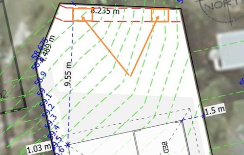

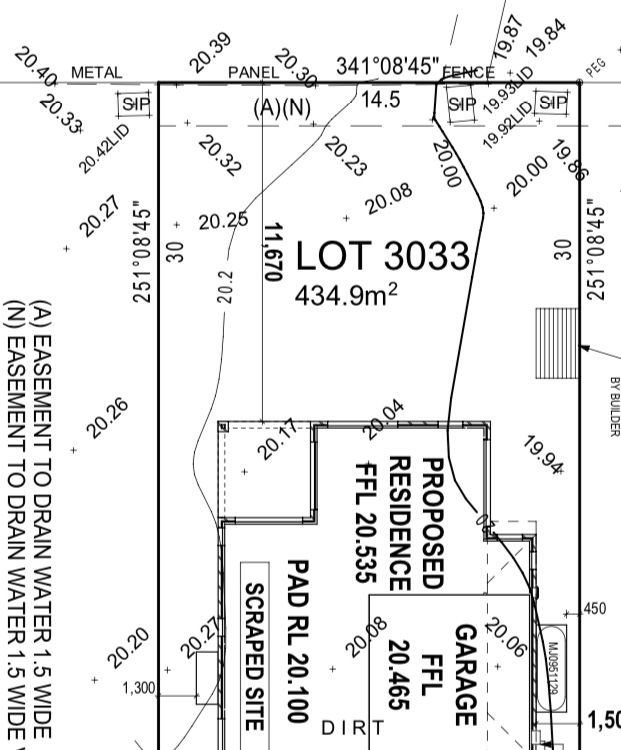

Please refer to the image attached. I'm in the same boat. Can I lift up the pit's height and cover it with something removable and put flower pot in top of the slab? Myland is slightly slopped towards the rear where those pits are. And we're thinking of filling the backyard to make it flat and plany some veggies, flowers. But we have no clue what to do with these drainage pits. What would be the best option you think?
1. Leave the pits alone outside and puah the boundary wall inside.
2. Extend the pit level high as ground leve and use some sort of removable cover and plant veggies on top. Thank you in an advance.

Welcome to the Bunnings Workshop community @binitsanu. It's wonderful to have you join us, and many thanks for your question about drainage pits.
Given that you are planning on changing the height of your yard, it might be best to enquire with a qualified drainage expert on what options are available to you. You could certainly raise the pits to suit the new elevation, but you need to consider the fall on the attached pipes. It would be ideal if you could leave the pits where they are and use a pit riser to extend their tops and finish flush with the new soil.
Were you intending on installing a retaining wall at the rear of the property to prevent the new soil from coming in contact with the fence? If so, it appears as if it would need to be placed directly over the pits. If this is the case, you could consider putting the wall in front of them, and I'd recommend consulting a drainage and landscaping professional before proceeding.
Let me mention @Adam_W to see if he has any thoughts.
