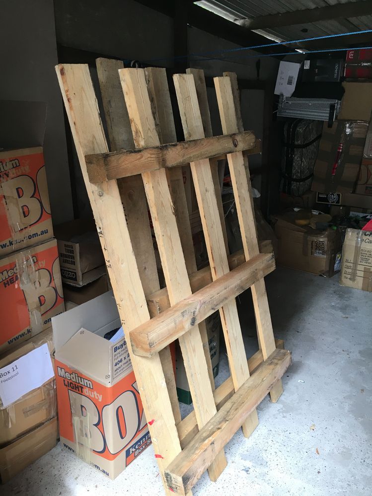

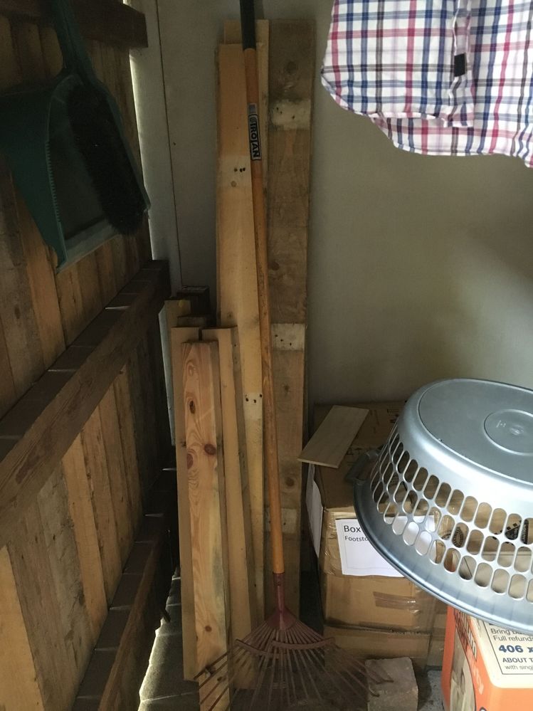

Re-cycled pallet converted into a planter box Pallet Pallet
Sketch
Nails removed Nails removed
Assembly
