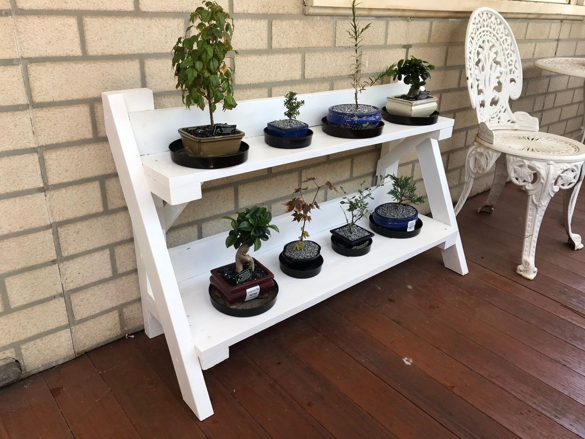

Plant stand
Plant stand was made from a discarded pine pallet.

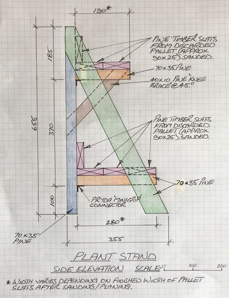

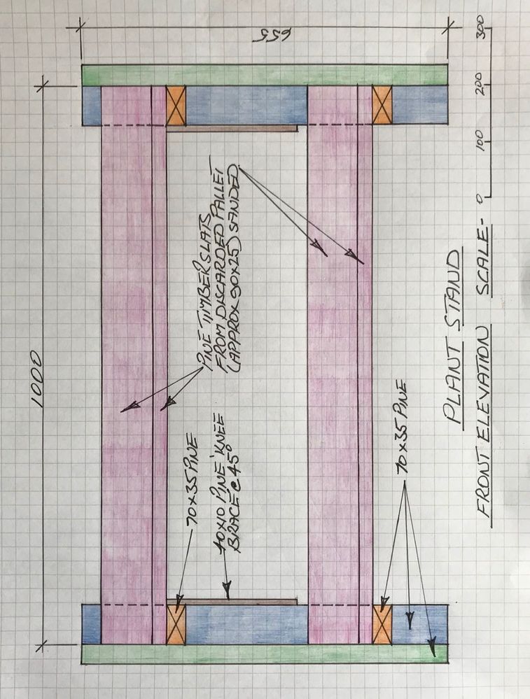

Am I able to get the plans to build a planter stand like yours.

This gives me an awesome idea for my old bookcase.

Welcome to Workshop @Imenz. Fantastic to have you join us and share your first projects with the community. We are really looking forward to seeing more as it seems you have great skills and creativity to share. Your handiwork has already inspired some of our members!
Did you do a rough plan that you could share with another new member in @Electrotarr? I'm sure any further info about the build would be very much appreciated.

I did do some drawings before I made it that I discarded after I made it.  I will whip up another set  and upload it.

@Jason @Electrotarr @@Attached are plans of the Plant Stand as requested.
9ED4BAA0-A980-48BA-BF46-979AECE226CC.jpeg 43E22284-904B-419B-A8DD-390E4B5CBA35.jpeg

Love your work @Imenz. That's fantastic. Thank you so much for sharing.

Ohhhh a special Bonsai stand. I love it 🌿💚 @Imenz
