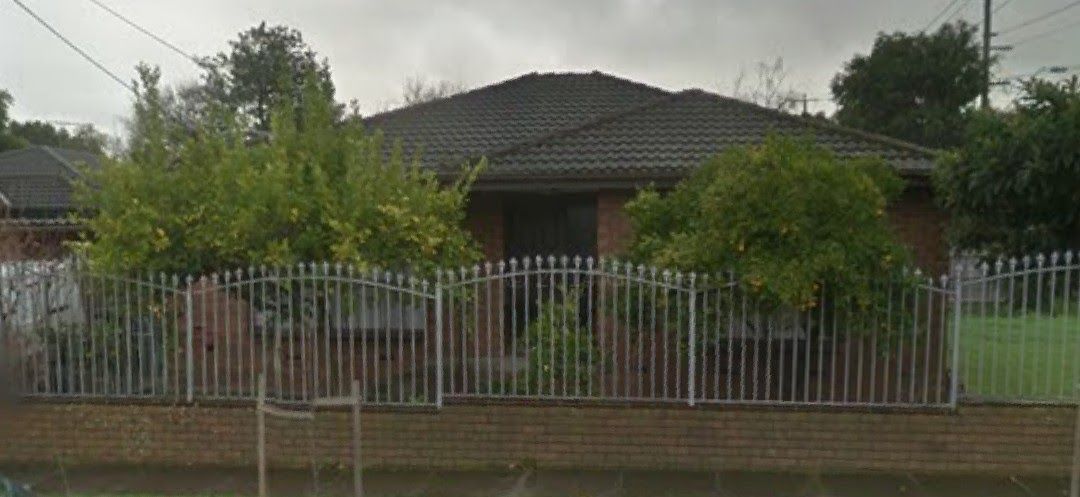

Here are some before shots.

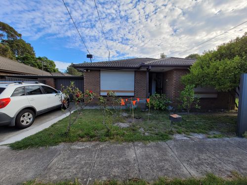

This one was before we did anything at all with the house:

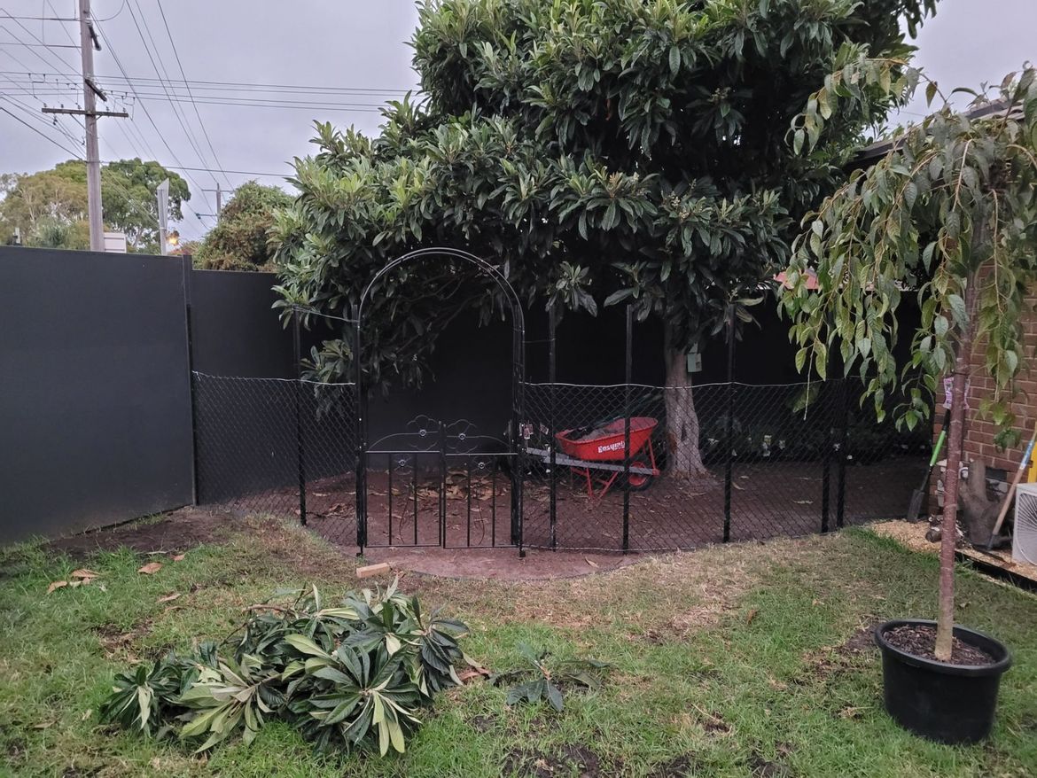

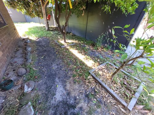

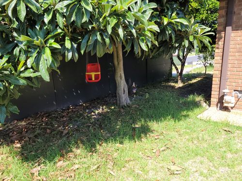

These are the immediately before work started shots. Though I had already removed the lemon tree in front of the window as you can see with the orange flags to caution the hole. This is all the same area from different angles.
For reference as I write stuff out in future, the terminology I use will refer to the unfenced area in front of the window and entrance as the "Native Garden", the area behind the fence as the "Fairy Garden" and the area as a whole as the "Front Garden.

Also, by removing your front fence it really made your home more open and welcoming, good call!

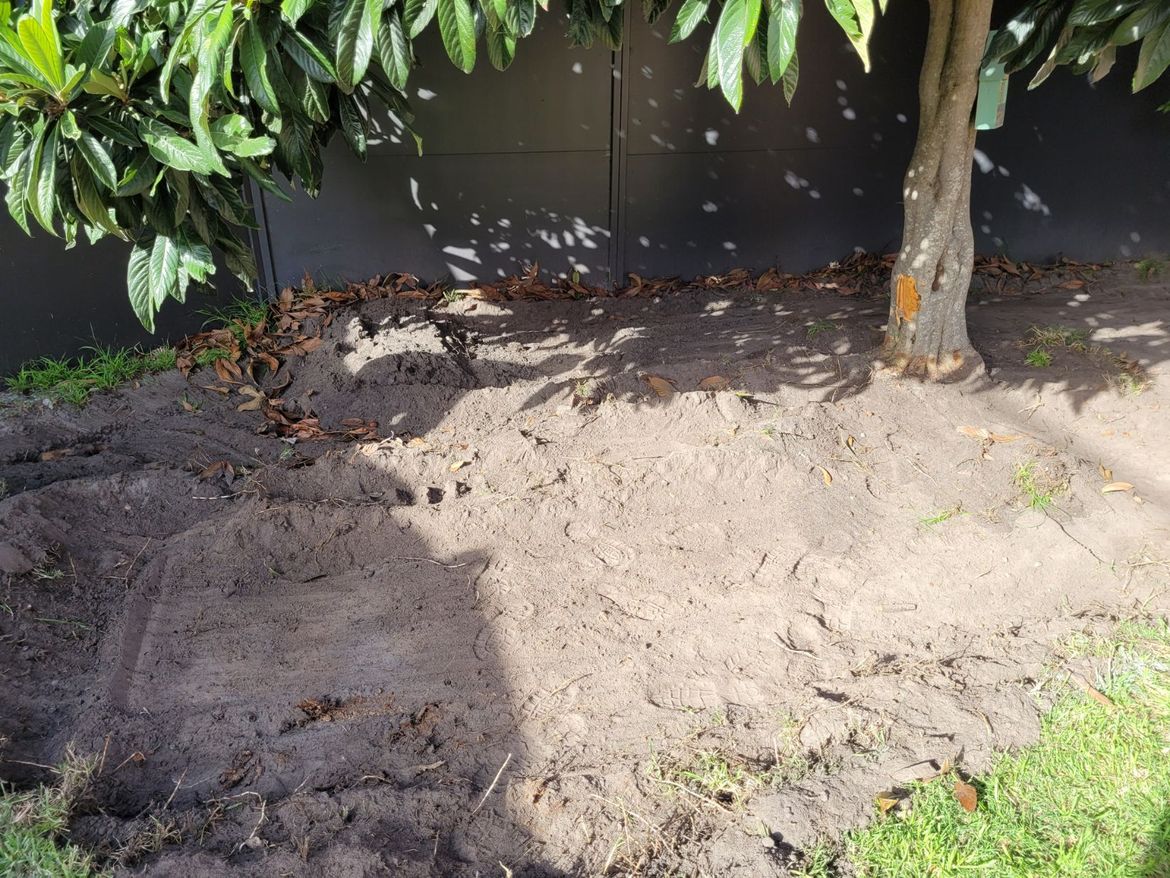

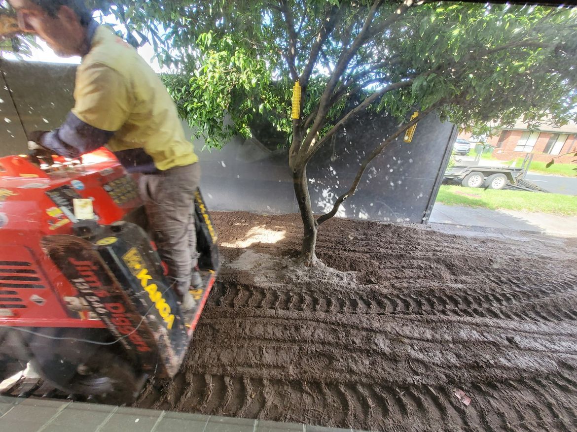

Jims Digger has begun his work

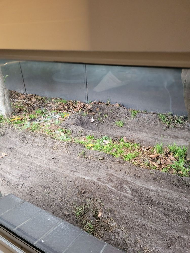

And some more progress

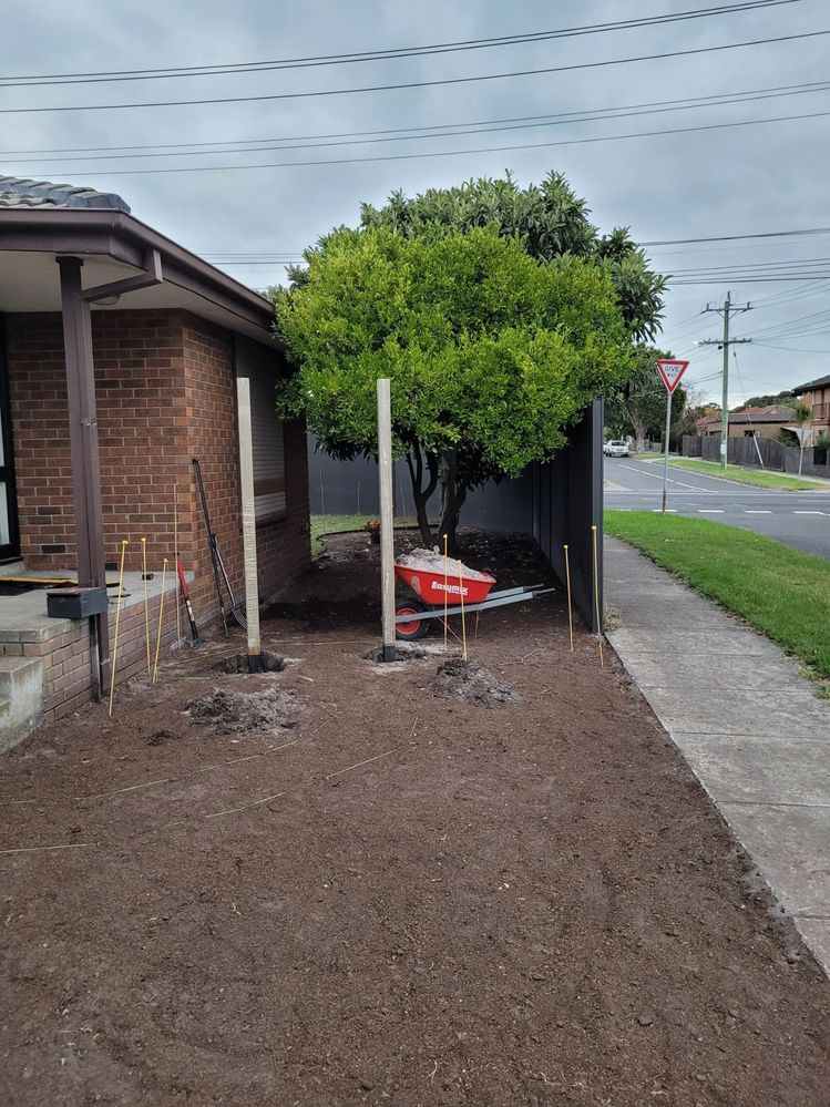

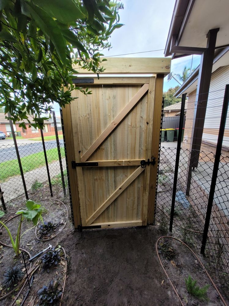

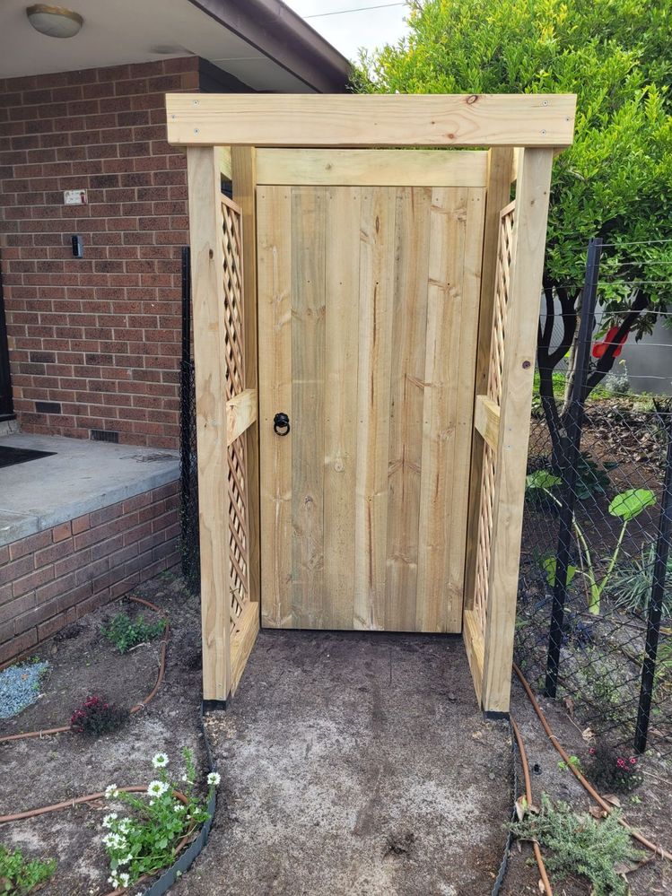

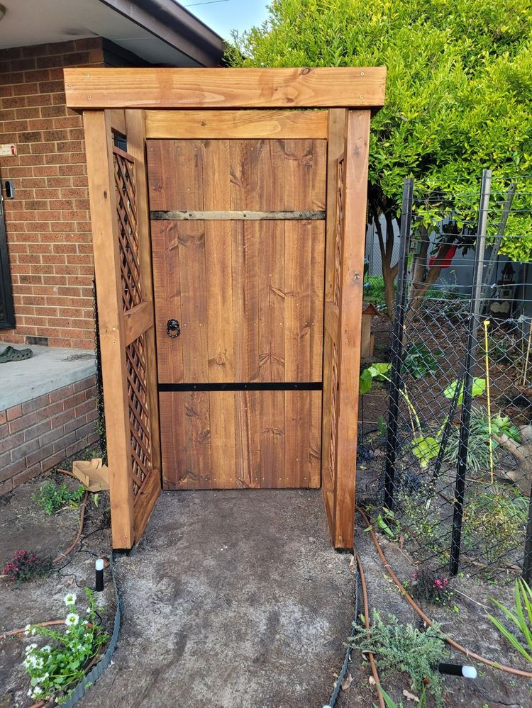

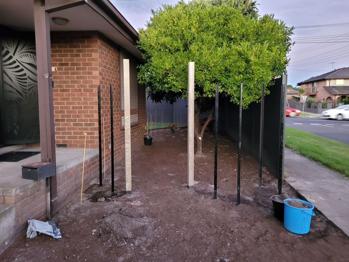

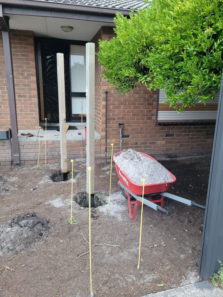

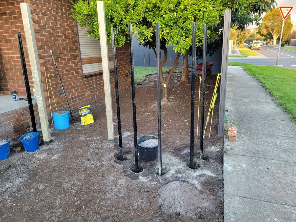

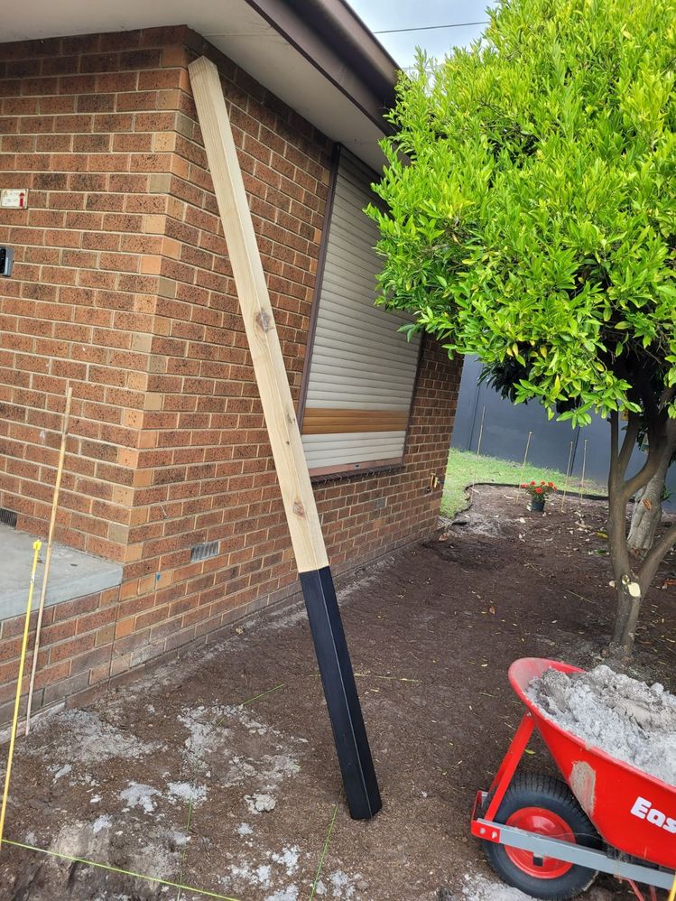

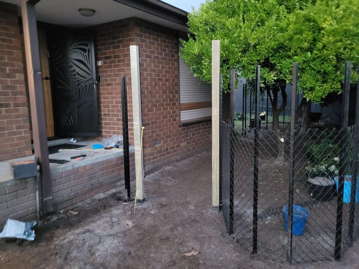

Land all flattened and posts for the entrance gate are put in. I marked a fix point from the top of the post going down to ensure the tops lined up and a used a level string line to align these. The posts are not in a straight line between the fence and house on purpose, as the whole structure with the fence will be curved.

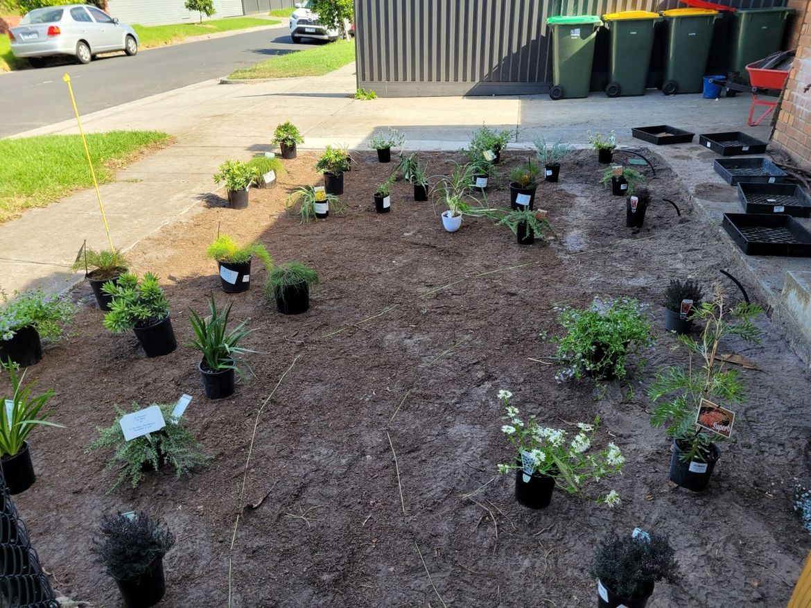

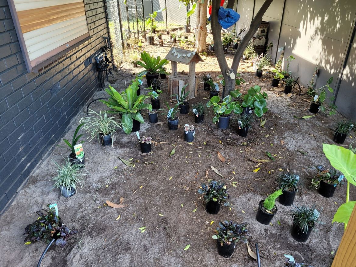

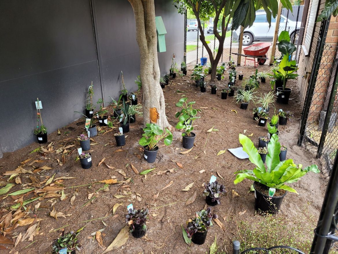

Some more plant planning.

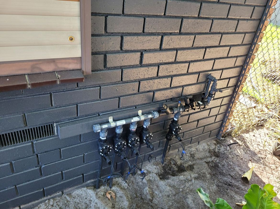

If anyone is interested, the setup above consists of:
5 x Solenoid Valves (1 for Native Garden Drip, 1 for Fairy Garden Drip, 1 for Fairy Garden above surface sprayers - to increase the humidity in summer, 1 for the back deck irrigation which I installed in my decking project and 1 for the lawn)
1 x Master solenoid valve
1 x Pressure reducer with built in filter (used to reduce the pressure to all the solenoids except the lawn one).
1 x Backflow preventer

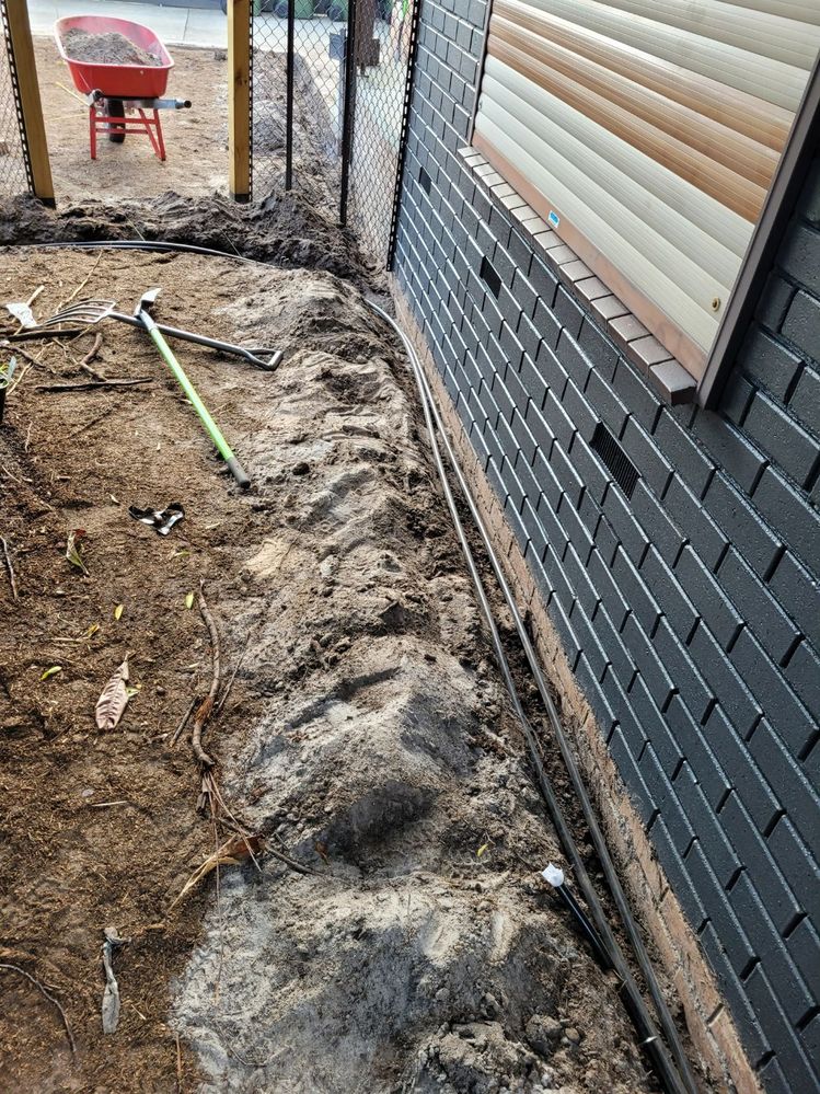

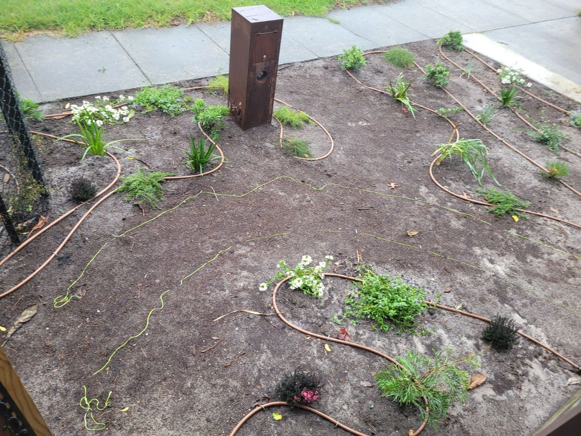

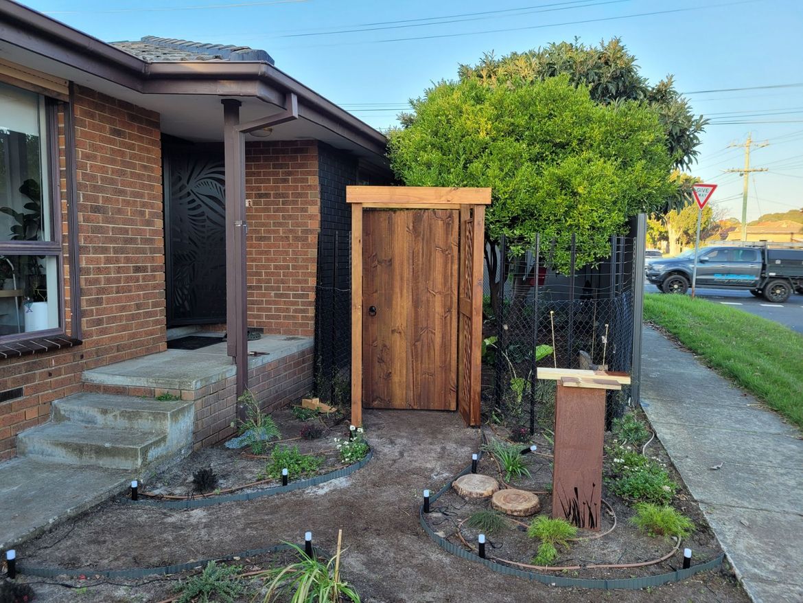

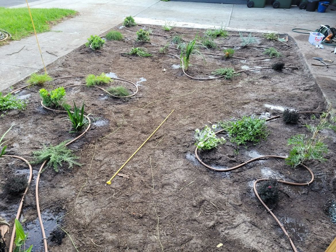

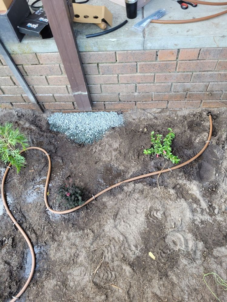

Dripline keeping the path area clean.
In this one you can also see the additional wiring at the top of the fence. You can also see the Muehlenbeckia hedge planted along the fence line that will engulf the entire fence in a year or two to form a curved green wall.

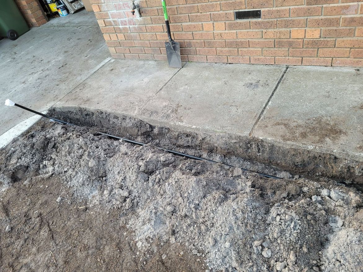

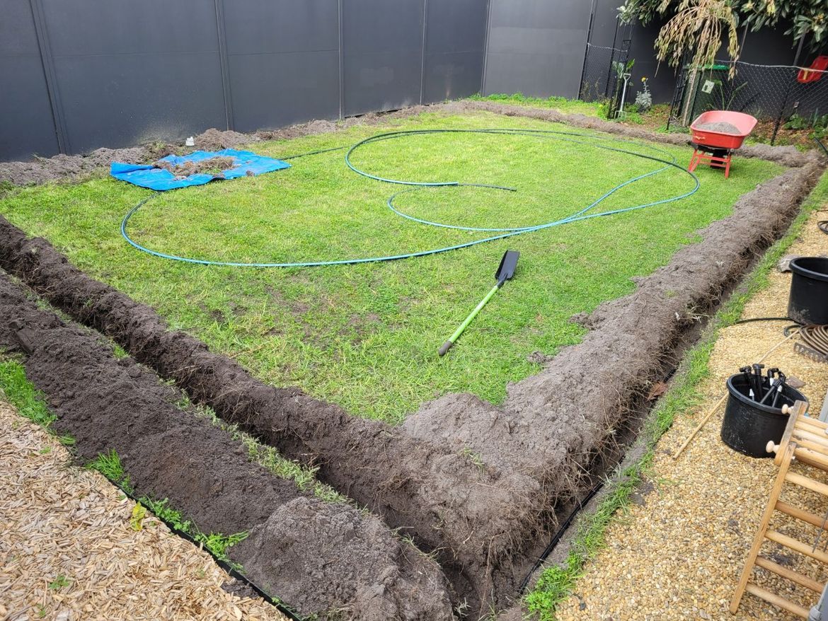

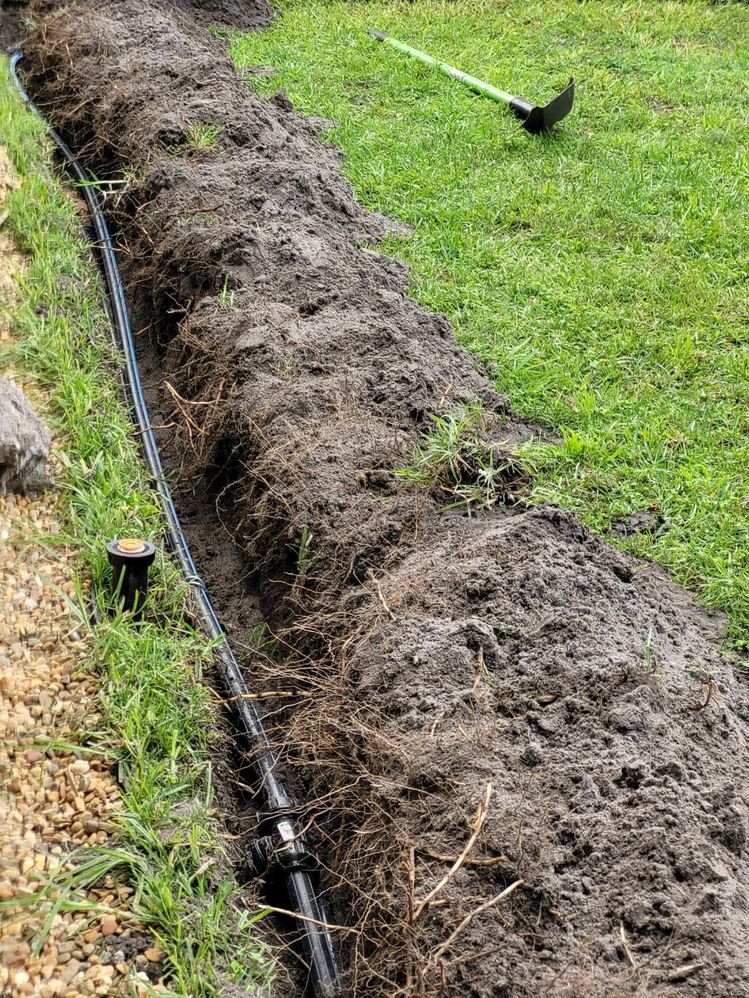

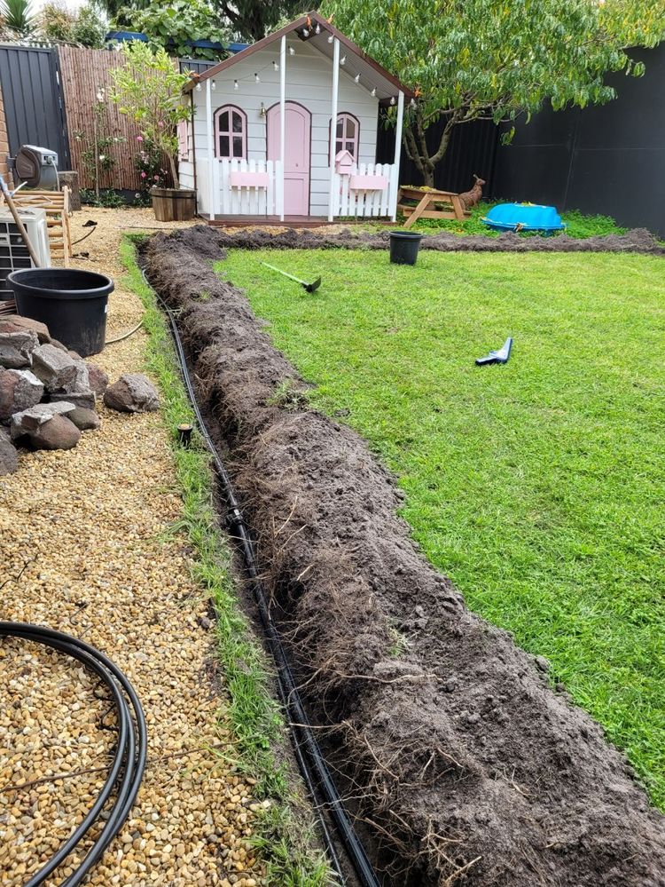

Laying the pipe. I used blue pipe as I am not using any pressure regulation for the lawn, so it needed to withstand town pressure. You can see one of the popup heads I've installed using Articulated Rizers to make height easier and more impact resistant. In hindsight, I'd use the Hunter SJ Swing Joints to make it even easier.
For the popup sprinklers, I have used 100mm popups, and rotary sprinkler heads.
I didn't know much about popup sprinklers, but just assumed I wanted the typical fan spray style sprinklers.
After doing tons of research, I saw that these consume a ton of water (and thus water pressure) and I would've had to install at least 9 but probably 12 sprinklers, and create 2 zones so that they could handle the water pressure.
I then discovered rotary sprinklers, which shoot little jets of water at alternating lengths, and they spin. They consume much less water, are much more wind resistant and therefore I was able to do my entire lawn with just 6 sprinklers and much less water usage meaning only 1 zone.
Here is one at bunnings: https://www.bunnings.com.au/k-rain-4-9-5-8m-rotary-nozzle_p3120744
They can also be retrofitted to existing popup sprinklers and can shoot up to 14m if you buy the right one and have the right pressure. But these were a gamechanger in my plans. Much less trenching required too!

Thank you very much for sharing those photos of your amazing garden layout. I'm really looking forward to seeing the mulch and the rest of the path installed. Suffice to say that it's looking pretty spectacular, this will really look like a garden retreat once all the plants have settled in. That watering system you've installed looks very serious, will you be putting a timer on it or is it all manually operated?

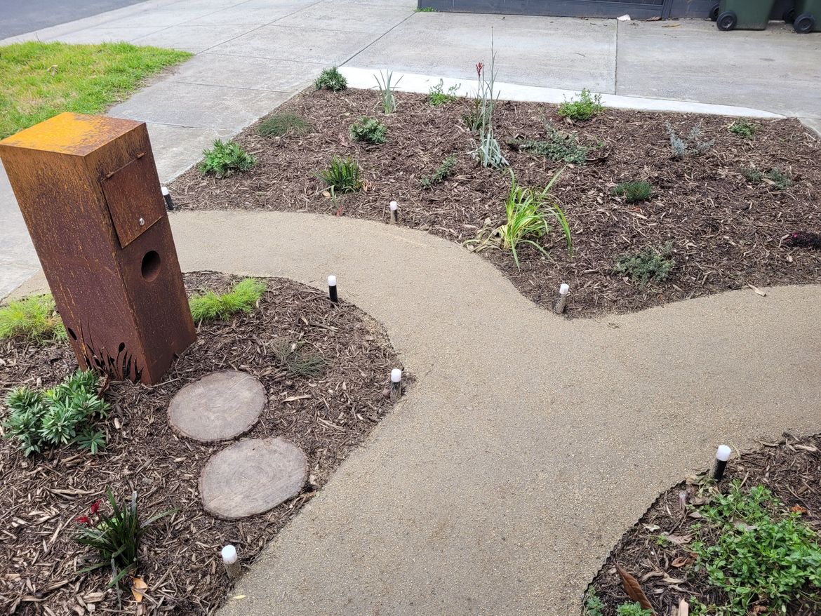

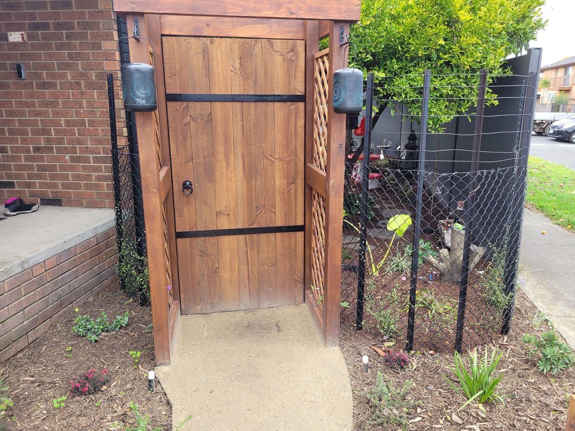

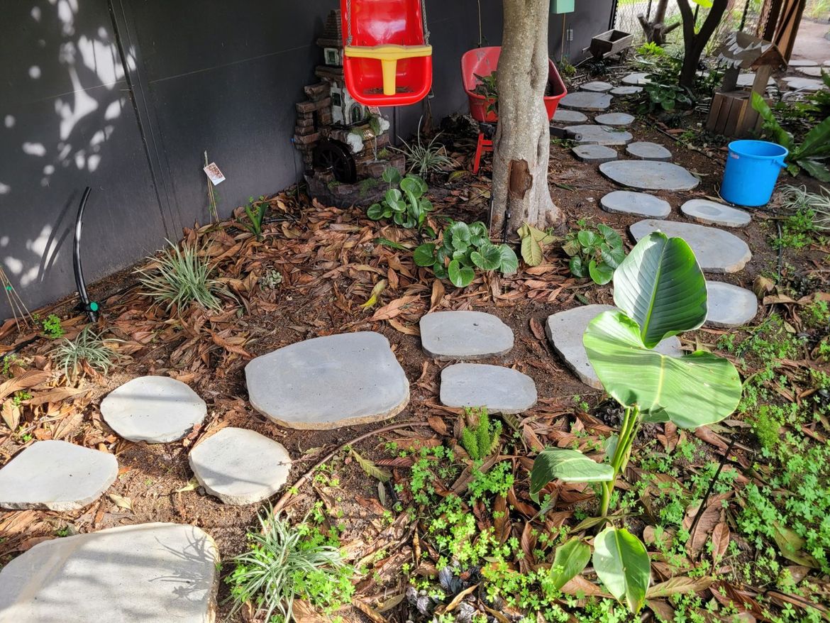

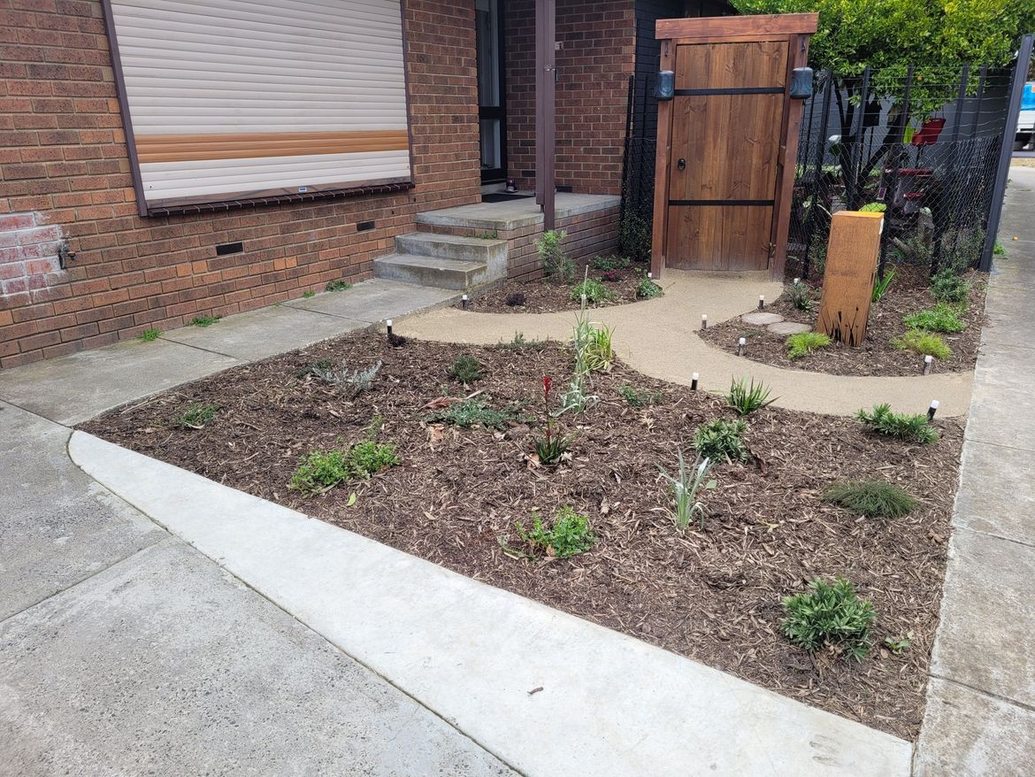

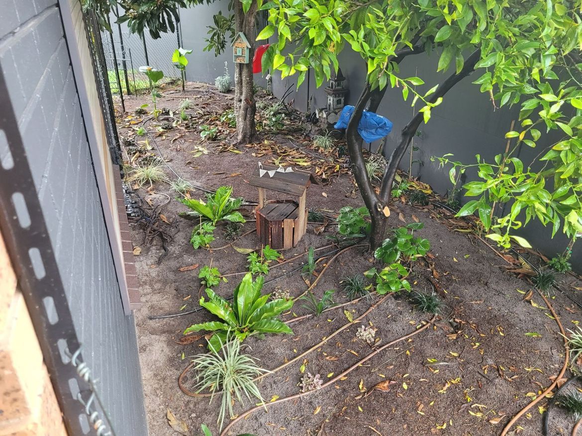

As promised here are the final pics.

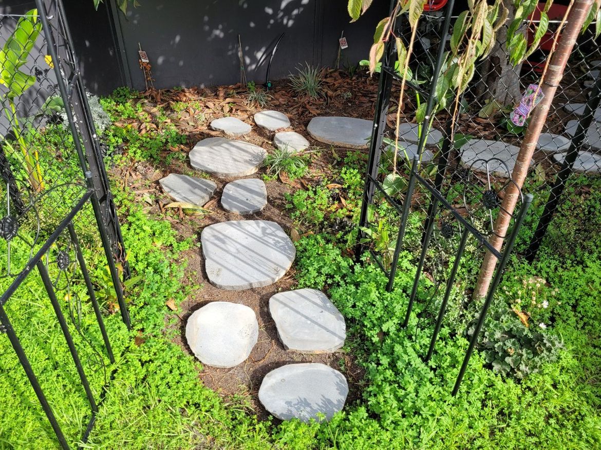

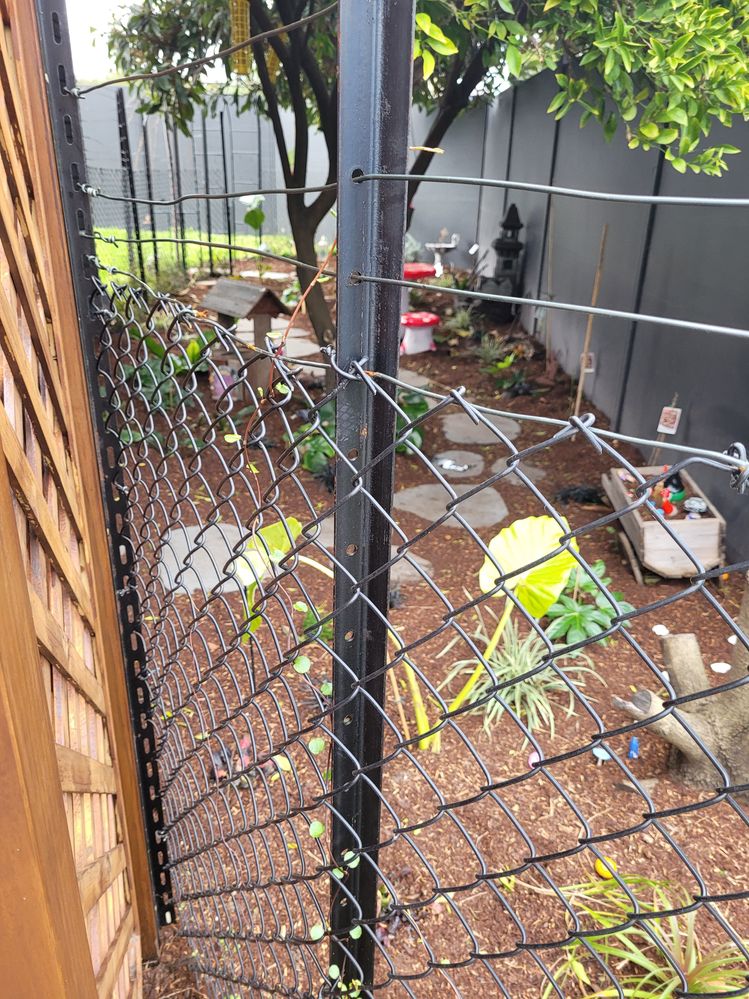

Here you can see the Muehlenbeckia is growing quickly. A vine has already reached the upper supporting wires after just 4 months.

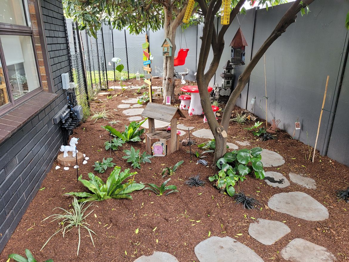

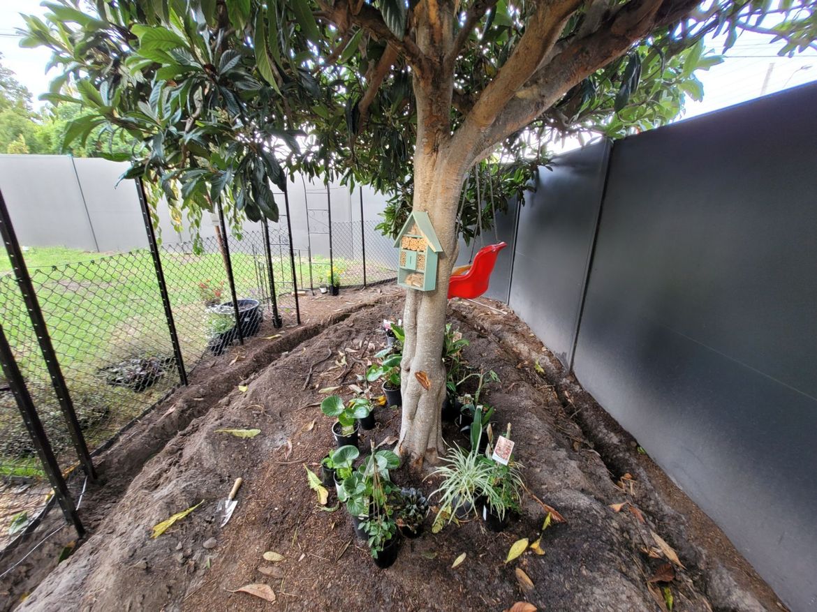

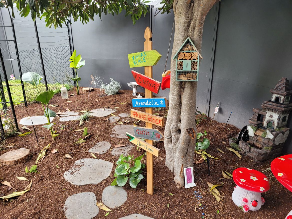

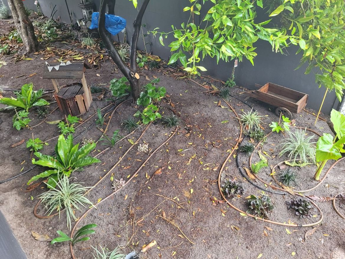

Our Fairy garden which our daughter loves. As the plants grow bigger over the next few years, the magical creatures will become more hidden.
We literally cleaned up all the leaves on Saturday!
Re: Project: Landscaping our front garden
Hi @Itai
Thank you very much for sharing pictures of your landscaping project. It looks wonderful and really gives the entry area a fantastic fantasy vibe when coming in. the fairy castle and the mushroom furniture are a beautiful touch. The bee house is a great idea to invite insects in to pollinate the plants when the flowering season comes.
