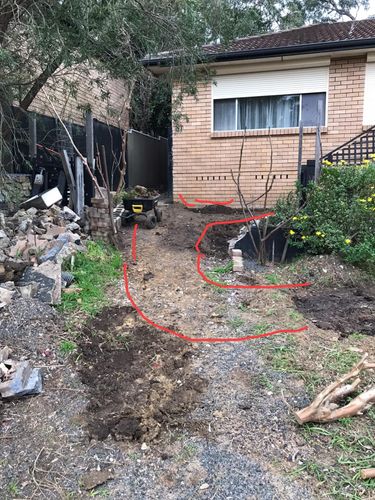

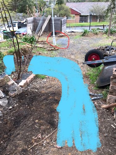

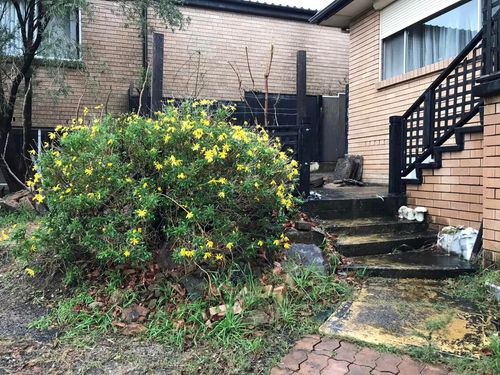

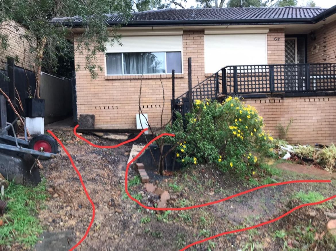

I was mapping out the slope of the yard and where the water generally wants to go. The Fig tree was staying, the daisy bush and money tree could be moved so I had a few fixed points to work with. My first plan was to create a higher levelled area using Gabion walls to hold back the soil from the edge of the path. Then decided to have the gabion wall to hold back the paths edge instead.

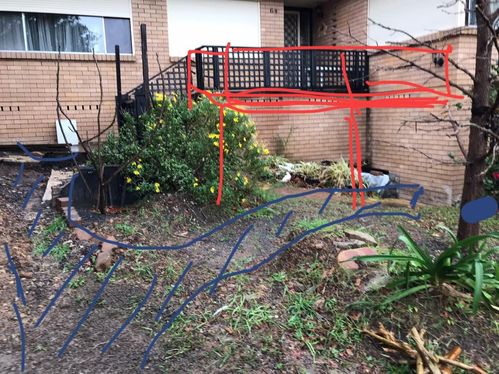

Blue hashtag is for proposed pathway, The red is for a large porch area one day. This is factored into the design of the path so it skirts where the posts would be.
Where the path will go.

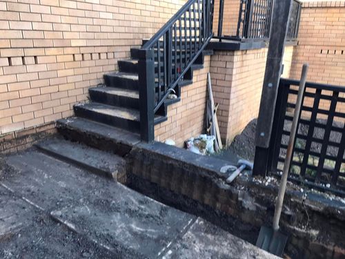

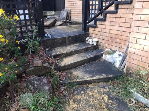

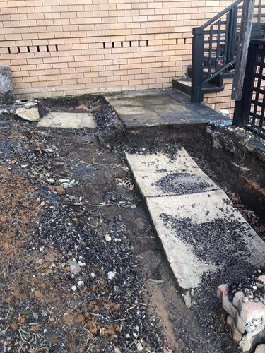

Old pathway, I really liked it but it was broken from the sewage replacement work and also if/when the deck overhead gets built it would be right in the middle of it all.
The temporary fix after the sewage pipes had been replaced. It worked well for a few years but time for this area to be brought up to usefulness again. You can see the edge of the Gabion wall to stop water ingress into the garage
I had been putting off doing this job but it was getting closer to having to do it.

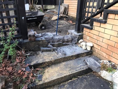

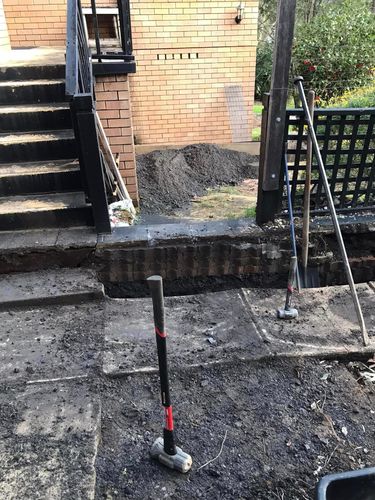

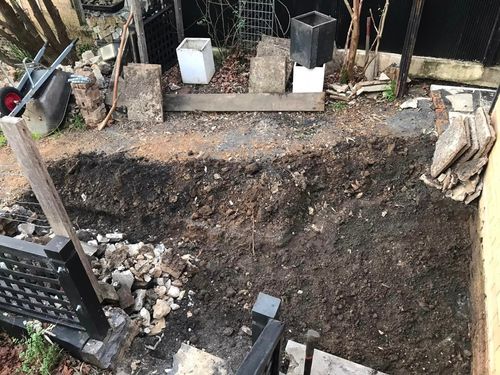

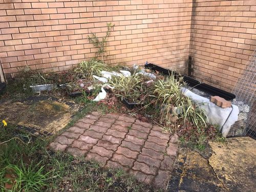

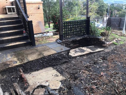

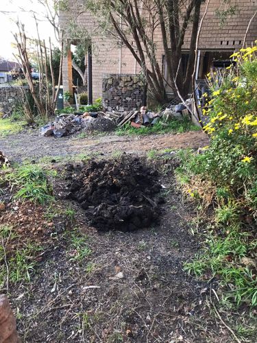

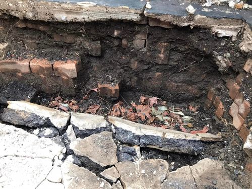

Here is something I wish we renovators did... Remove the old stuff first and not just bury it! lol There was a whole concrete pathway and also garden bed with sandstone edging underneath the colawash for this old patio area. It all had to go.
The problem is how to keep an area useful while working on it, much respect to the RTA for roadworks is all I can say.

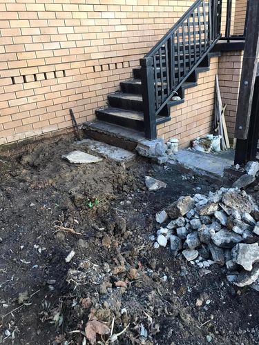

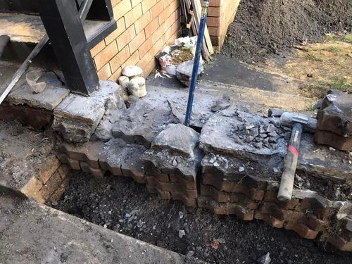

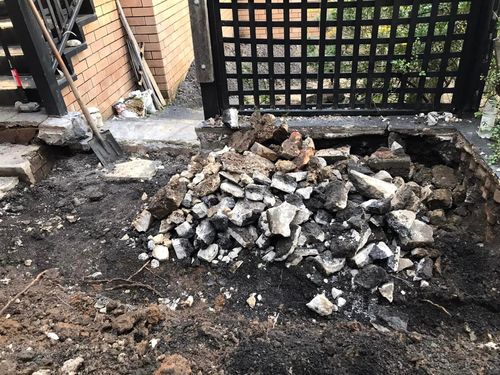

2/4Once the easy coalwash had been removed it was back to breaking concrete again. I will reuse this in gabion walls later.

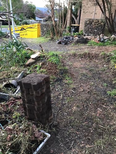

If you look closely you can see stacked wiggly pavers that they have used for the retaining wall They were not even interlocked. No wonder I had cracks all over it.
Trusy tools, pound hammer and sledge hammer both with firbreglass handles as it has less shock strain on my arms.
Always so much stuff to do before you can go forward again.
Crowbar is another friend that was used a LOT
Anyone know of wher you can buy molds for the concrete mushrooms? My Grandfather and Uncle had them way back in the 70's but have not found any since. Maybe I should make a mold from silicon?

So many pavers were within the walls, lucky as I will use them for the new pathway.

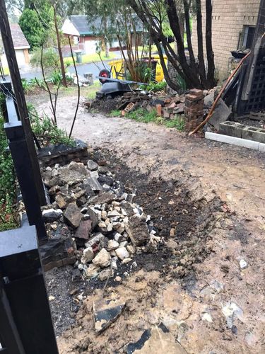

Old pathway broken up, time to sort the slope out for the pathway and surrounding garden.

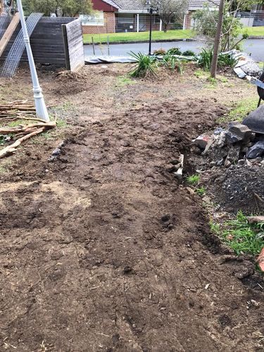

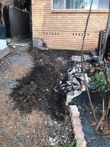

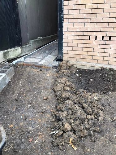

So I used clay to widen the path and also to chanel water to certain sections of the garden.

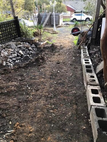

3/4The pathway that I had been using to trundle things up to the back yard was widened and also pretty much set (We always take the shortest route to a destination)
The dark soil is the hollow part of the pathway. I need to build this up.

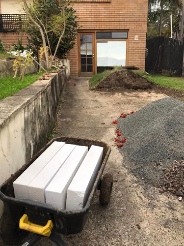

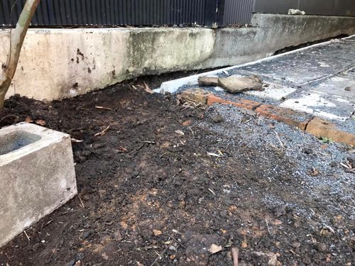

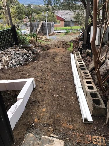

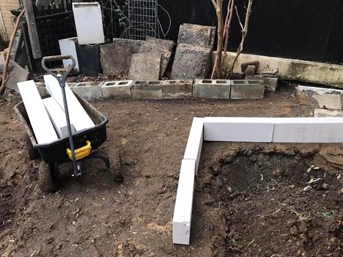

I reused some Bessa blocks as edges and they work surprisigly well.
I also used some straight concrete edging but reversed it to form a gutter for excess water to run down and not eat the gravel away from my path.

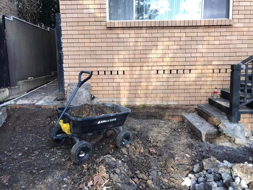

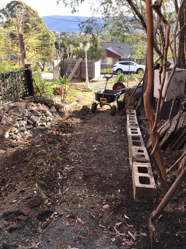

The little trolley that could, best buy from Bunnings! Seriously it really worked well especially on wet clay!
Slowly backfilling the new pathway with clay. Running the trolley back and fourth over it really compressed the clay and firmed it up.
You can see the trolley tracks. It made the job a lot easier.
Starting to backfill the slope down to the existing steps.
The pathway has been built up to the height I wanted. there is an area to the left that will be a garden so its not filled with clay.
New path being set.
I wasnt happy with the width and fall of the path. So made it slope from high on the right to low onthe left. To keep the water from running down the side of the house path down to the holding pond and not cause channeling.

4/4More clay, trolley loads of clay slowly built the path up.
By this point I had realised that I should change the location of a gabion wall to retain the path instead of a lower one to make a flat area. Wayto much soil to shift!
Getting the slope right was done by eye, I did an overall meausure of the drop and then I chopped that meausurement into thirds so I could have a constant slope

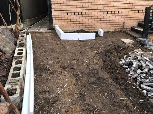

Bunnings had these hessa? style (light in weight that you can saw) concrete blocks on sale for $2.00ea I ended up with a bunch for temporary edgeing
Laying them out to give some form to the path and for the gravel to butt up against.
The gutters to the right, edge to the left. Gabion wall will eventually be to the left but I needed access back to the house soonest.
You can see the shape the path has taken. I was really happy with the clay. There are low points set in the clay to allow excess water to run if needed. The gravel once leveled will cover these so you wont know they exist.
It was hard to decide on the angle of the slope. The side pathway was higher then the level I wanted the steps to be so the path slopes in two directions but also constantly down the hill.
Slowly getting through pile number two of clay and this pile was waterlogged.
The new path down to the front footpath. You can see the edge of the culvert in the middle of the picture.
