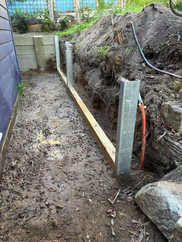

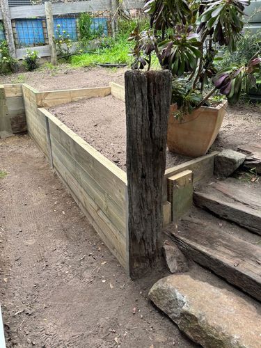

Otherwise, I have removed several stumps that size myself, but never bothered with any form of poison. By simply digging deep all the way around and using a combination of an axe and a long pruning blade on my reciprocating saw to cut the roots. I just dig the blade in deep and cut away, then using a fencing crowbar to pry the stump out.
It's how I got this tree and subsequent stump out in the photos below.

Woooooo Effort plus and I bet you cheered afterwards! And cursed during
Nice solid work and how long did it take?
Thanks again guys... Took a couple of hours (and a fair bit of elbow grease) @Dave-1 since it was my first rodeo - used a pit bar and that made a world of difference!
