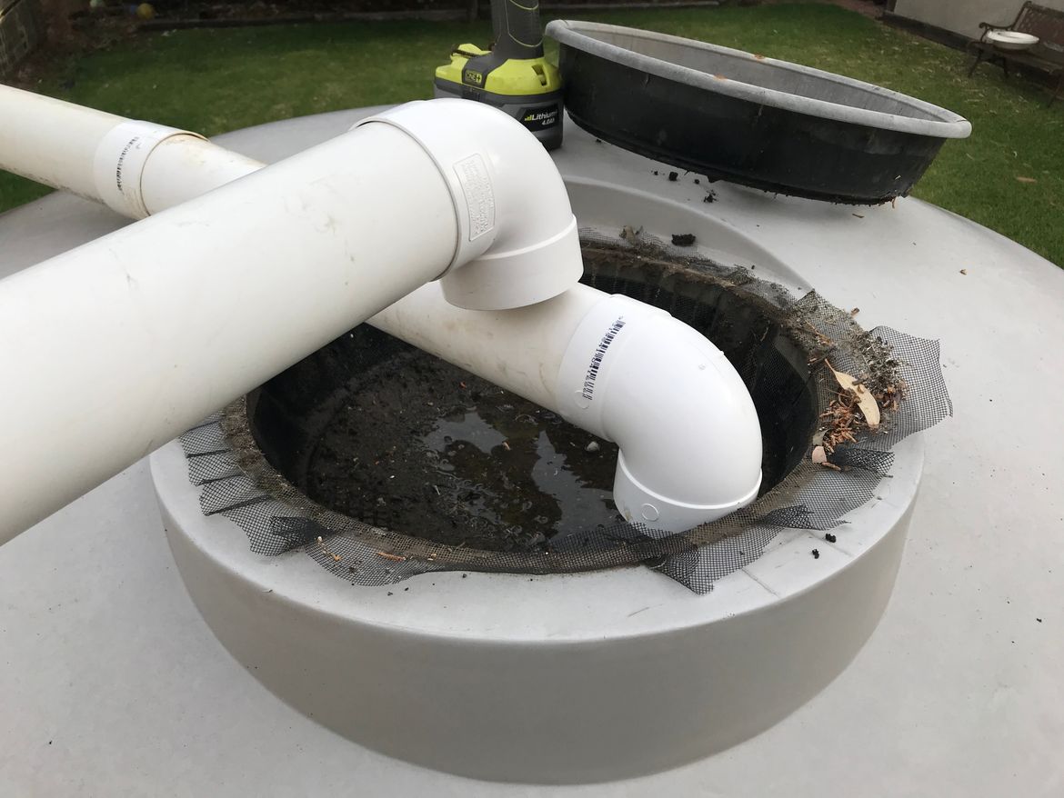

How to stop water tank inlet screen from clogging up
I have a water tank with something like this in the hole in the top to keep mosquitoes out:
https://www.bunnings.com.au/rain-harvesting-400mm-tank-screen_p4816370
The pipes feed water into it, and it's supposed to flow through it, but it clogs up with silt, and in heavy rain it overflows onto the ground. I've pulled off the mesh for now. Is it normal for this to happen?

Hi @pstq,
How often are you cleaning out the mesh? In an ideal world where your roof and gutters are immaculately clean, you'd never get any buildup here. However, in reality, that is simply not the case. There's a whole heap of organic material in the system. If you are seeing this mesh blocked every other week, then it might be time for a thorough cleanout of your gutters, as they could have a buildup of organic material in them. However, this looks to be more slime/algae than material being washed through the system, and I suspect regular removal from the mesh is needed.
I don't personally have a rainwater tank, but with a mesh like this, I'd presume it needs to be cleaned out at least every 2-3 months. The finer the mesh, the more regular the cleanout.
Hopefully, any of our members running a similar setup might like to add to the conversation.

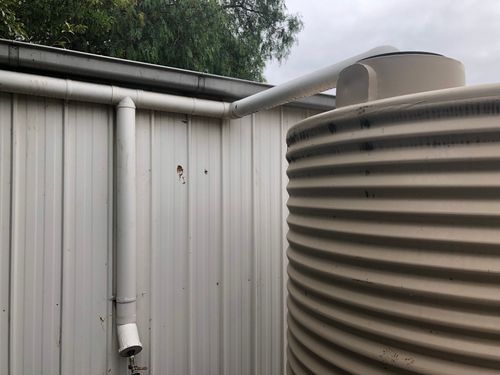

I have a water tank with a run off bypass pipe for leaves and dirt which prevents the majority of dirt/leaves going into the water tank
I found this video online that will show you how it's done.
https://www.youtube.com/watch?v=wOumD-IFfBg
This is my simple setup, I still need too drain out and remove the cap to clean out, I'm sure their is a better way of do this, please see the video attached.
Here is a fitting to make clearing the leaves instead of using my set up. Maybe @MitchellMc can give some advice on installation of the item

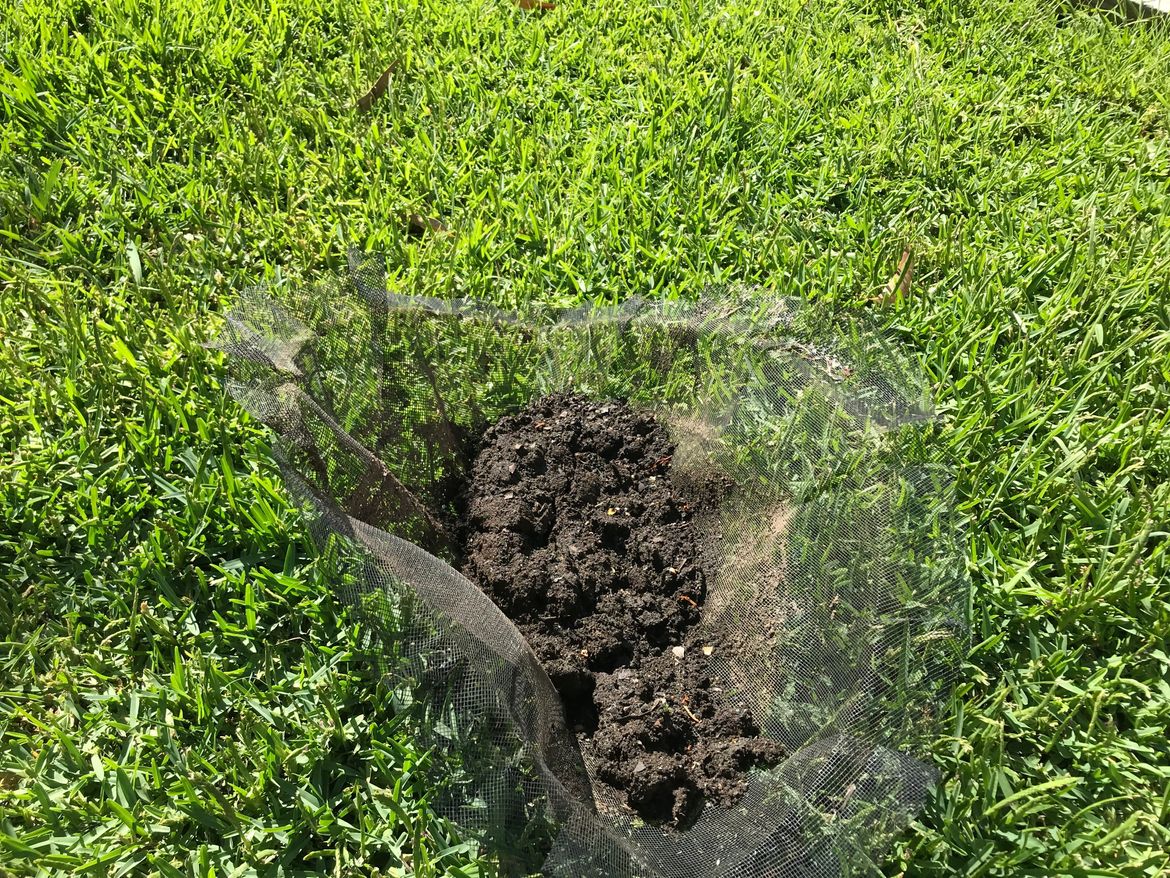

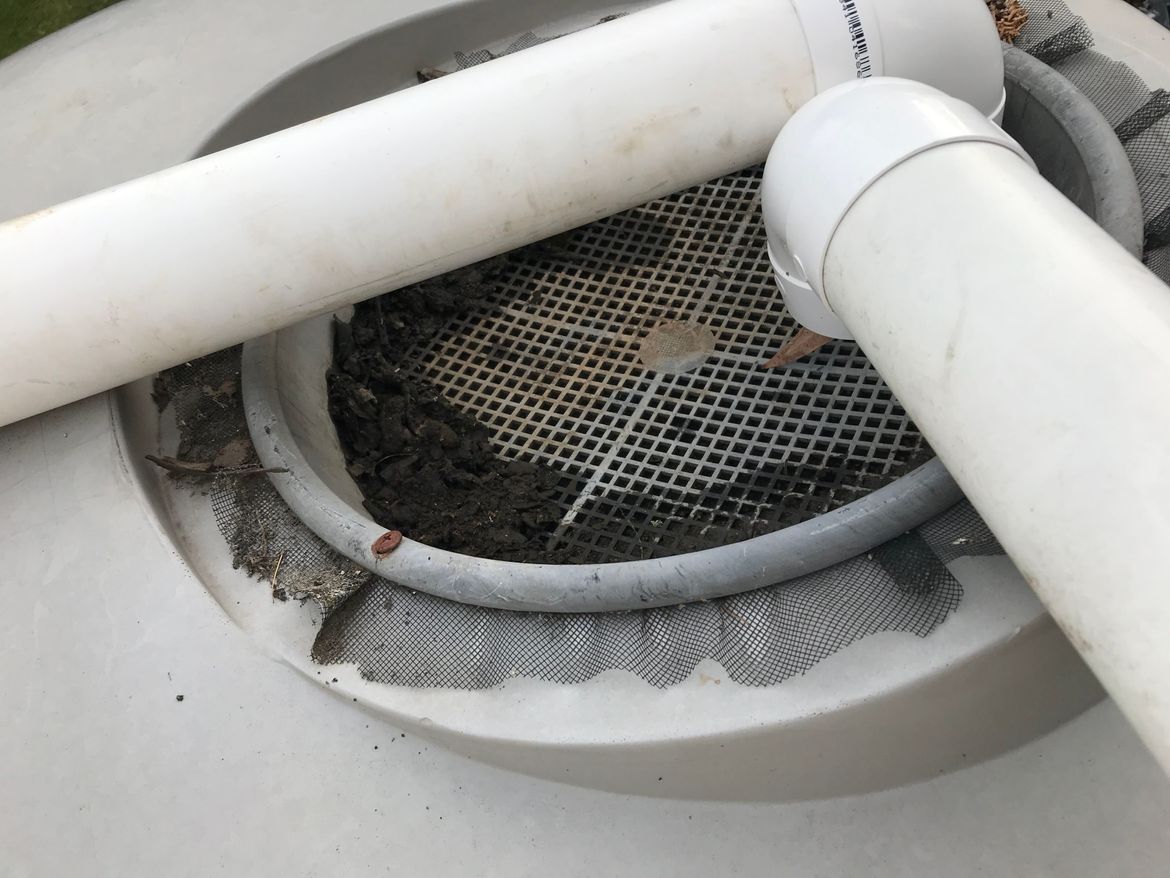

@MitchellMc yes it's clogged with fine silt and maybe algae. I fitted that mesh just 3 months ago, as the original mesh had fallen to bits. (I've had this tank since 2008, but only recently connected it up!)
I'd better clean it and put it back.

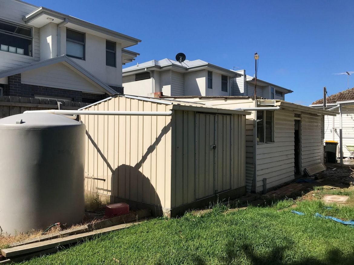

Here's the setup. Water runs from the house guttering onto the verandah roof just visible on the right, then into the garage guttering, then into the guttering of the little steel shed, then into the tank. I could fit the diverter between the steel shed and the tank. There's another pipe from the back of the steel shed to the tank, but maybe that catchment is too small to worry about. Note the the pipe from the shed to the tank is nearly horizontal, so I can't fit the rainhead there.
I cleaned and refitted the mesh. It was actually full of silt. I thought it was just three months accumulation, but it's probably a couple of years. I reused some pipe that ran directly from the garage to the tank with a big sag in it, and it had a ton of dirt in it. Can't remember if I cleaned it out first. Maybe it all got washed out by the rain.
