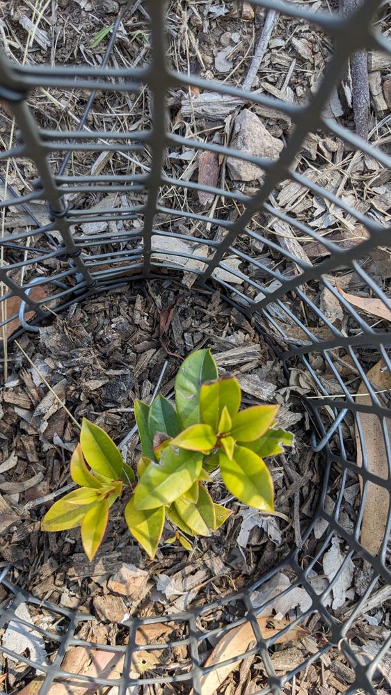

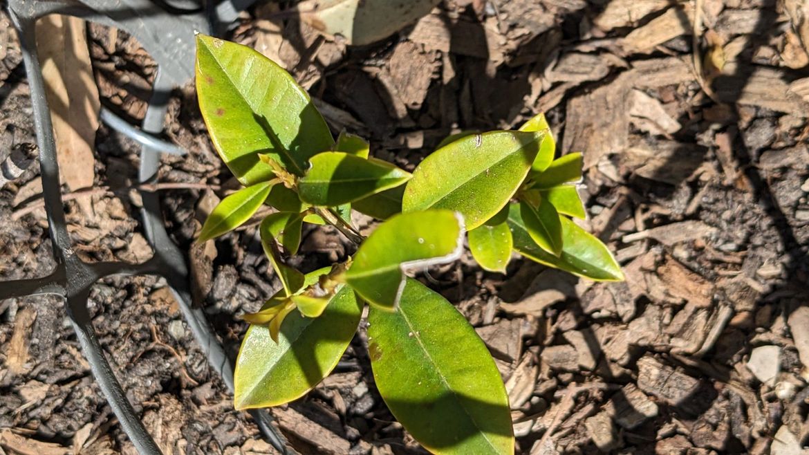

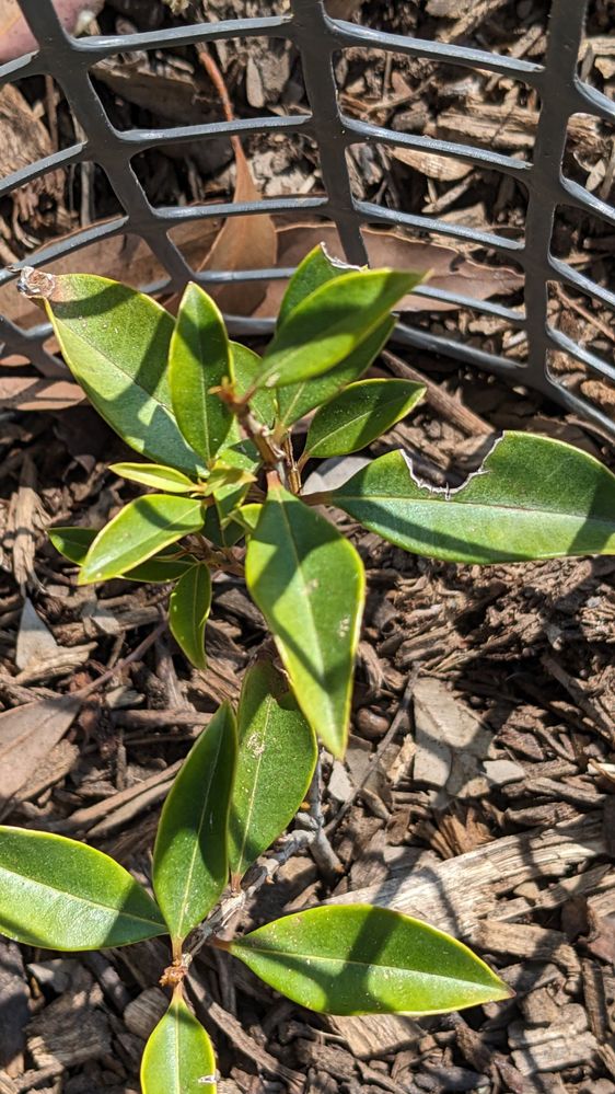

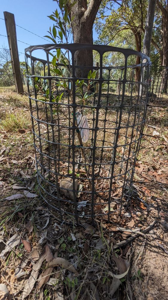

Hi I too have problems with my Lilly Pilly's   planted in a rural setting ..at first my tube stocks were eaten by rabbits!!!!  Then magically the tough little ones grew back now that spring has hit they are not growing !!   They have leaves which appear to be half eaten or little nibbles out of them ... not rabbits as they ate the entire plant before we placed plastic protection cages around them.. Also then went to Bunnings and purchased 4 larger plants thinking the rabbits wont eat those and they didnt!!  yay ... however now they too arent growing and losing their leaves or half eaten...

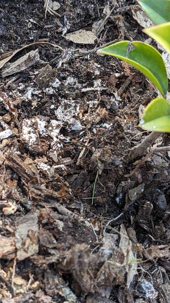

I cant see any lumps, no holes in branches, have looked under mulch to see grubs.. non present... the soil is moist they are in shade from afternoon sun...  ... we have almost 20 plants in all that we thought would grow fast to privatise our rural boundary... very sad.. please help ...
Should I use the neem oil even if there doesn't appear to be grubs?

Looking at the three photos you posted it looks like the first one needs some liquid fertilizer, the second one seems like an insect attack and third one is definitely animal damage. In order to discourage further attacks I suggest spraying the plants with soapy water, the soap residue should give the leaves a bitter taste. You can also spray the surrounding area with vinegar.
In regards to the conditions that you've mentioned, the only other thought that comes to mind regarding your plant's growth is perhaps they need more fertilizer. I propose having a look at PowerFeed 600mL Fertiliser Liquid Concentrate
Let me call on our experienced members @Noelle, @mich1972 and @Adam_W for their recommendations.
