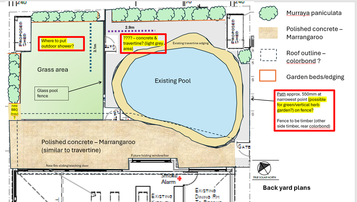

Re: Most effective way to sound proof an open patio
Good question Nailbag - it's more about trying to keep sound from escaping the internal space. I understand it's difficult to soundproof given it's an open space but I would appreciate hearing of every option possible. Please note new images uploaded.
Hi @Mygoal
I guess then you're aiming to keep the noise of entertaining in that area to a minimum in consideration of your neighbours. With such a great open outlook to the pool are yard, anything fixed offering the most sound-deadening will only spoil that. My suggestion would be the same as @JacobZ by using the bistro blinds and shrubs where possible. The blinds are made of a very thick PVC/Vinyl and off course can be rolled up or down as required. A doubling up of the blinds would reduce further noise, but of course at double the price to and they aren't cheap for quality ones.
