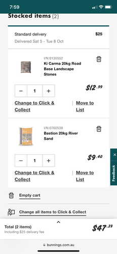

Thanks for replying. Are these the correct base that needs for the base? How many bags do I need for 8 x 4.5 m?
Re: How to remove turf and install artificial grass?
Hi @wendychoo1009,
Those are the correct materials.
You'd need around 1.8 cubic metres of road base and 0.7 cubic metres of sand.

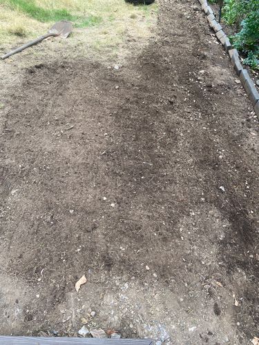

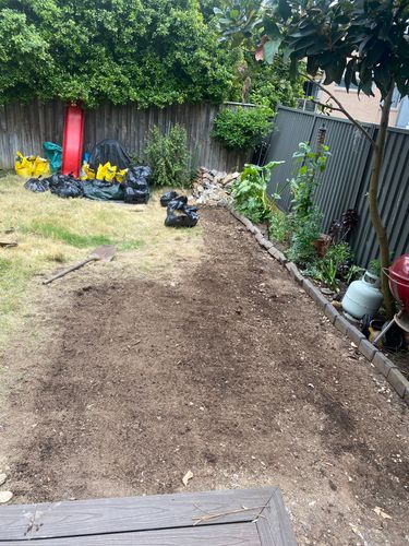

 Hi, thanks for your reply. I am starting my project now. Is this good enough or I have to dig more? Also, could you let me know how many bags do I need. I can’t work out meter cubes as compare to bags. IMG_2665.jpeg
Hello @wendychoo1009
I suggest speaking to the special orders team at your local store and asking for a quote for the road base and sand along with delivery. Getting it by the bag would be too expensive, I recommend getting it in bulk at the store.
