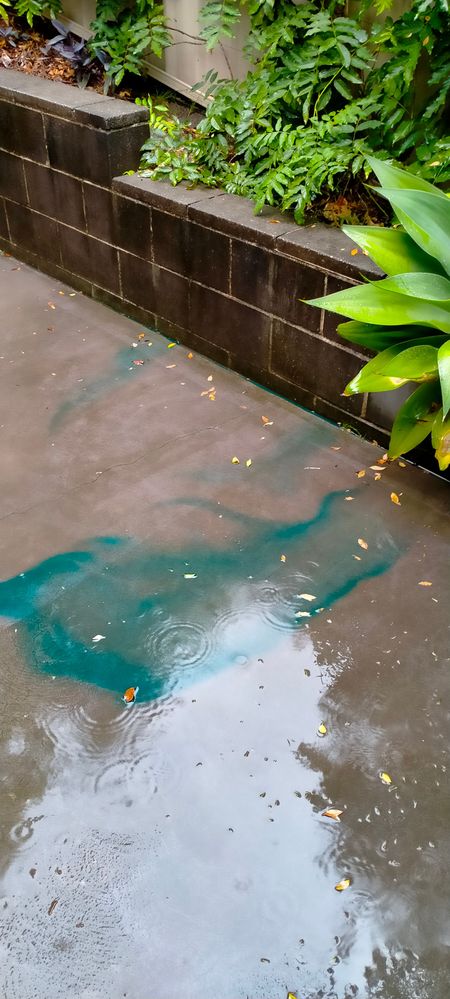

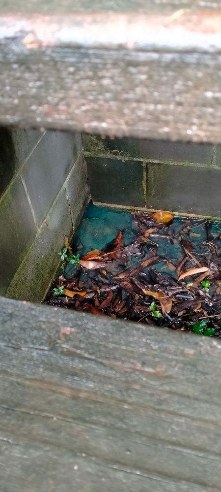

This last rain we had gave me the opportunity to gauge the water problem at the bottom of the steps after the drainage system placed in the backyard above the steps.
The water pools around the base of the steps and has a hump in the concrete slab before the water can run into the drain in the middle of the entertainment area.
Any water unable to get over the hump is pooling and can be there for many days but I noticed that the water lays next to the expansion material between the slab and the blocks.
I also added some colouring in the water before the drain above the steps was laid and it could be seen that water is coming out from the surrounding areas to the slab and from under the steps and under or along the expansion material.

I decided to test my theory.
I got my long wood hand saw and was able to remove the expansion material between the blocks and slab and the next day after a rain the slab was dry.
It seems that the water has run along or between the slab and blocks to the garden area by gravity.

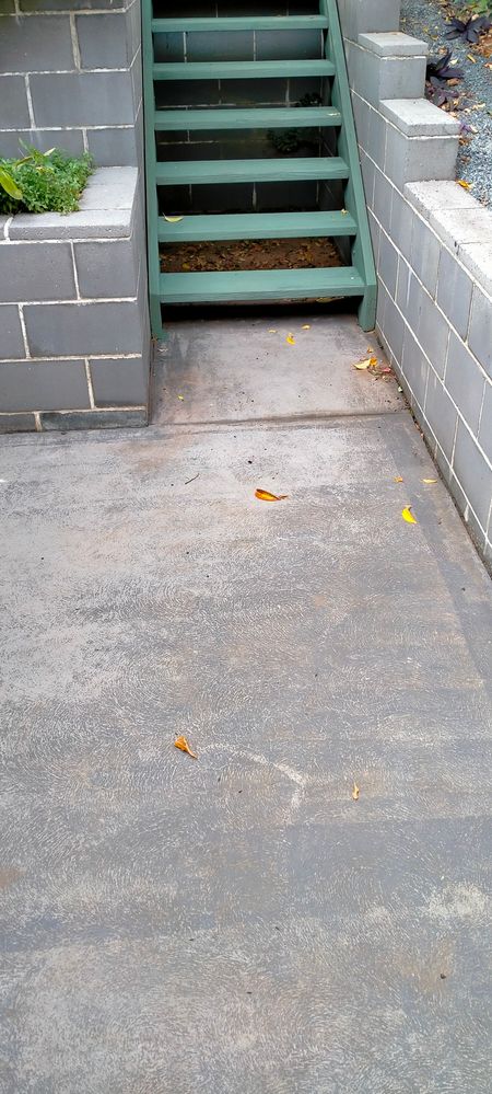

This is the area after the rain, cleaning, painting and the expansion material being removed.
The day afterThe day after
A couple of notes about using the saw. The concrete slab is around 100mm thick but I was able drive the blade 200mm into the cavity as I want to run the drain across the front of the steps and down the block wall but was given many reasons not too but I may rethink this.
What do you think Eric or should I just leave in alone as it seems I have achieved my goal.?
Which brings me to my next goal. I wanted to solve or reduce the water problem as much as I could which I have not seen any muddy water since the drain above the steps and the water there has been clear at the bottom of the steps and now the pooling is reduce or gone!

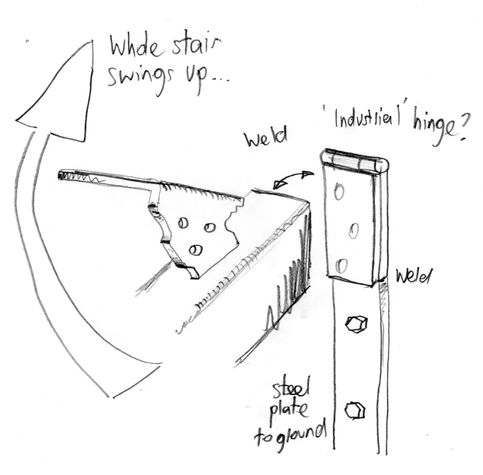

Your steps look good - but in the photo, is it still a problem to clean leaves and debris from behind? Just a mental exercise really, but I liked that product you mentioned earlier. However the maker won't give a price unless you become a member or e-mail them.
Just a Public Holiday thought.Just a Public Holiday thought.
Anyway, I was wondering if they could be 'hinged' - then lifted and propped - for easier cleaning behind them?
Just coffee and idle thoughts. 🤔

Hi Noyade
The steps are very heavy and while you could hinge them I would think shoving the broom between the steps would be much more easy and only take minutes.
My partner suggested a leaf vacuum cleaner.
Maybe you could hinge a step, I share your passion to think beyond the normal!
