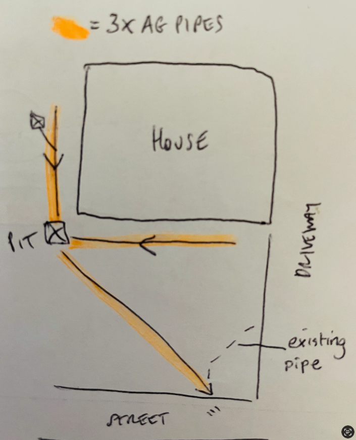

Hi @Noelle - I was hoping for some more advice. I have painted the front facade and I am up to stage 2 - the ag lines.
I have attached my plan. I will have an ag pipe down the side of house, across the front of house meeting at a pit which will then run to the street.
Being different brands, do you know if you can attach the Vinidex Y Junction to the Reln slotted, socked ag pipe?

Thanks for sharing your drainage plans for your garden. I'll have to double check for you regarding the compatibility of Vinidex and Reln drains. In the meantime, I suggest having a quick look at this guide - How to install garden drainage by @Adam_W and this discussion - Drainage to fix a muddy lawn by @Ben.
Because your proposed drain system is complex and involves proximity to your house wall, I recommend hiring a registered plumber for the task. Engaging a professional ensures adherence to run-off regulations and proper connection to your stormwater drain in compliance with building codes. However, you can still save costs on this project by handling tasks like digging and concrete cutting yourself.

Good news! I've been speaking to my plumbing specialist at the store, and she's double checked and has confirmed that the Vinidex junctions will work with the Reln extendable agi pipes.
Thanks for confirming!
