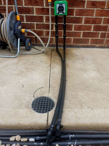

This is the head assembly at the tap with 3-way outlet, timer and then pressure reducer/filter:
Note: WIFI hub installation can be tricky if you have mesh router.
I have marked poly pipes with Z1 and Z2, after laying them down, for me to remember which pipe I am putting the fitting on (I made a mistake of putting two dripper holes on my zone 2 pipe which I have to plug later).

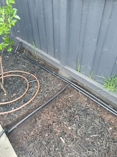

I am using 19mm poly pipe as my main lines for zone 1 and 2. This image below shows pipe going to shrubs with 4mm pipe and dripper at the end.

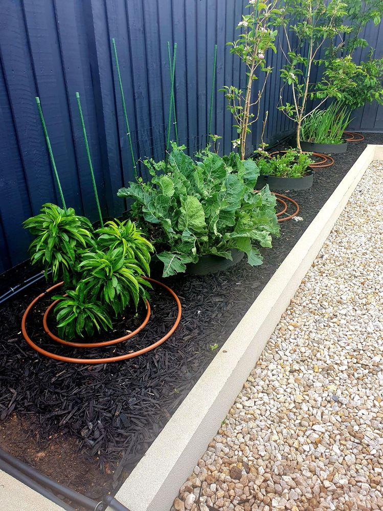

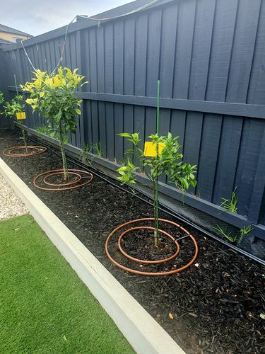

It then runs along the south garden bed, where zone 2 is supplying water to fruit trees with 13mm drip line rings.
In round vegetable patches I made a 13 mm poly pipe ring, attached it to 19mm main line and then put 360 degree variable flow sprayers on that 13 mm pipe.

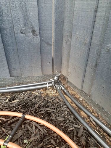

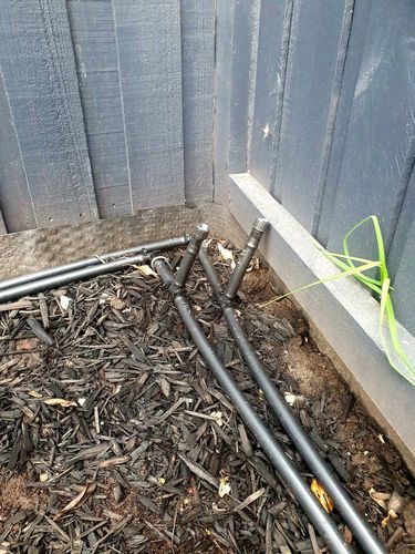

Two 19 x 15mm Single BSP Female Poly Threaded Tees are placed in corner for flushing water when needed.

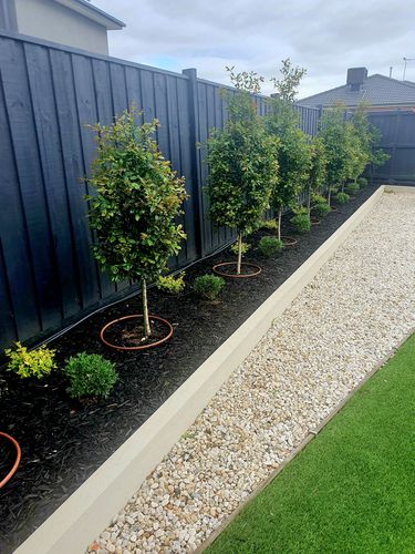

It then continues along western edge in same configuration (zone 2 supplying water to Lilly Pillies with 13mm drip line rings and 4mm drippers from zone 1 supplying water to shrubs.
In the corner again, two 19x15m BSP tees for flushing.

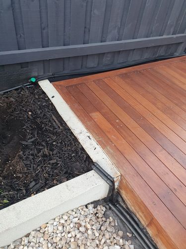

On northern side of the border, same configuration continues.
At the end of the northern bed, pipes are coming back to connect at the start (making a loop).

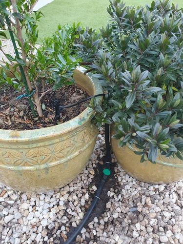

But also zone 1 pipe continues along the side fence to water Photinias in the containers. I put valve on that line in case I need to shut it off sometime.

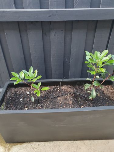

 A pipe, from zone 1, was brought in from north west corner to supply water to three large pots. At the end I have drippers attached inside the pots.  

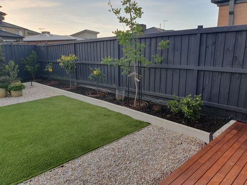

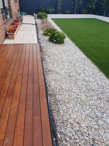

This is how it looks like finally:
I am running it for few days (manual and automated) to test. If all goes well. I will put mulch to cover the pipes.
