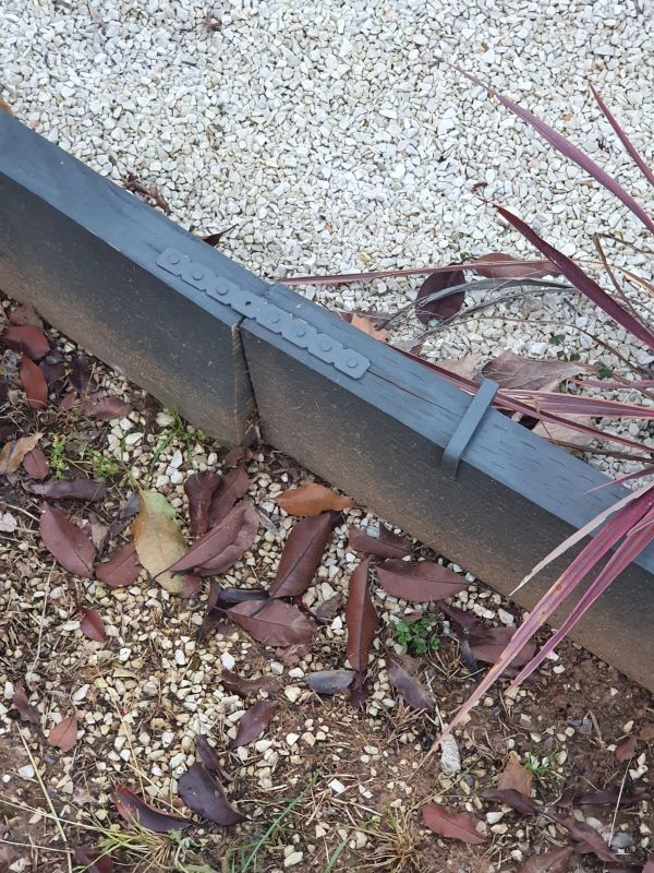

I noticed this sad attempt (note the warping after only 3 months) on a nature strip walking to work earlier this year...
Re: How to make sturdy wooden edging?
Hi @Noyade,
sad attempt indeed. Looks like the builder opted for a nail-in bracket and connected the sleepers on the top only with no part below ground level. That is doomed to fail after some time. They should join the Workshop community!
