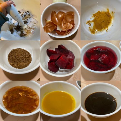

When I make my next batch and yes I am definitely making more as I find it very relaxing lol I will be introducing natural food colours like beetroot, coffee, turmeric, brown onion skins.

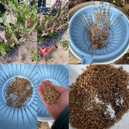

I grow heaps of Basil in our Garden mainly to provide plenty of Nectar for the foraging Bees , Native Bees and the Beneficial Insects. Basil flowers for several months so it is a great way to attract Pollinators into your garden.
Now as we head into Winter my Sweet Basil and Thai Basil is still growing but starting to go off with the cold nights, so I want to save the seeds and share them for Spring planting.
I cut off the stalks and pulled off the old flowers and seeds in the dry husks. Rub them between my hands to release the tiny black seeds. I used a colander inside a bowl to catch the seeds. I didn’t discard the husks as there are still seeds sitting in them, they were used as well.

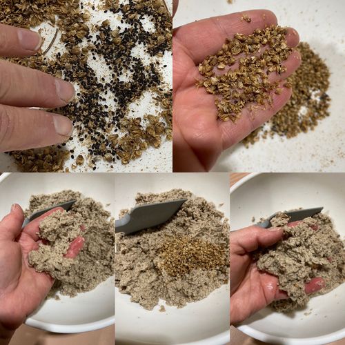

Back inside now with my seed harvest. I added seeds and husks to the pulp in a bowl and mixed thoroughly by hand. Do NOT add seeds when blending they will be damaged.
Also , don’t overload with too much seeds, try and think about when the seed papers are planted and germinate, you don’t want them overcrowded.

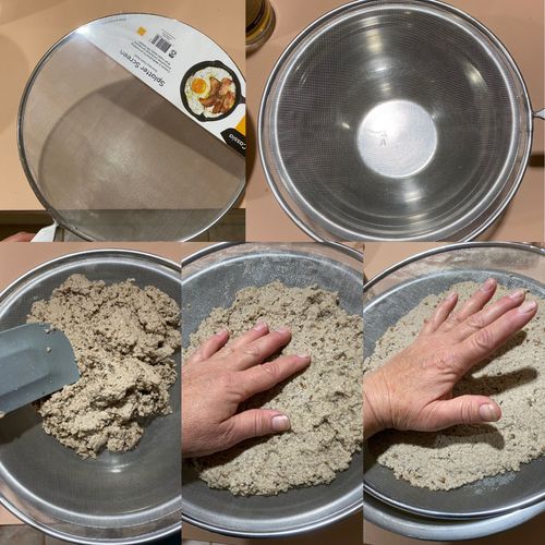

Now to start making your paper.
I found using a splatter screen very strong and sturdy. You could certainly make one using an old photo frame, glass and backing removed and a piece of steel mesh attached using a staple gun. I’ll leave that up to you.
I divided the pulp mixture in half. Place the screen over a bowl to catch the excess water.
I found the easiest way to spread the pulp out is to use your hands. Working carefully as the pulp needs to be spread out evenly. I used to palm of my hand to press it down.
Please note : The way I have made my seed paper is probably the thickness of a finer cardboard , actually pretty much like the egg cartons. I’m very happy with that. The pieces look like crackers. All good. You can make it into a thinner version but the technique will be different. This is a very easy way, especially for beginners.

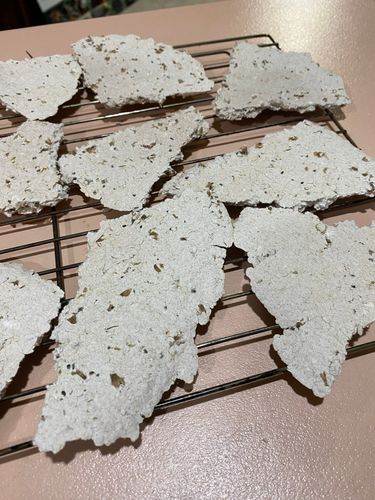

After the workout , carefully remove your paper and take it outside undercover I a protected area, place it on laying down flat on the table sitting , raised off the table so it will have airflow all around it.
I was not confident to hang up on the washing line incase the paper tore.
Depending what the weather is like when you make your paper, it may take up to 48 hours to dry completely. Now remember my paper is slightly thicker so it could take longer. Because we got rain, I bought the paper back inside and placed it on a wire cake rack thing and put it in the oven on the lowest temperature setting and door wide open on the top rack. Dried it off completely in approximately 15 minutes . Kept close by to keep an eye on it. All good.

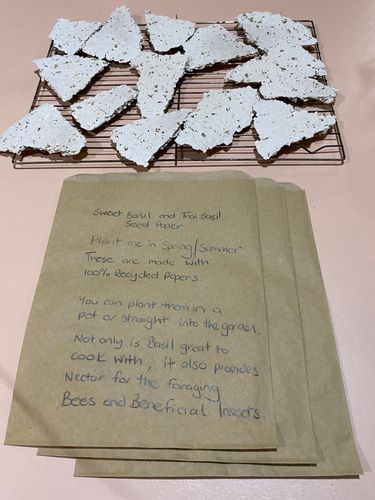

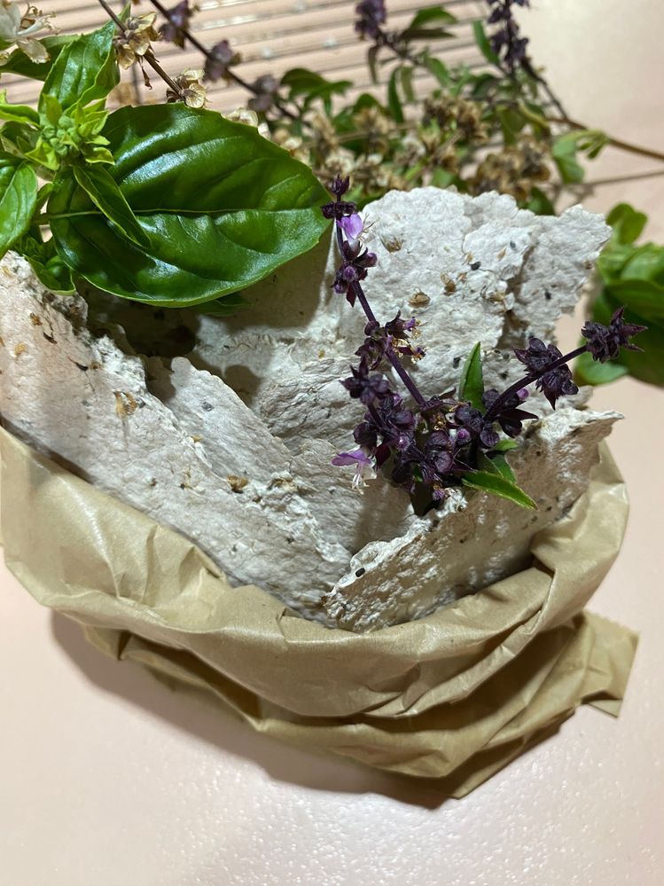

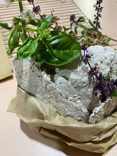

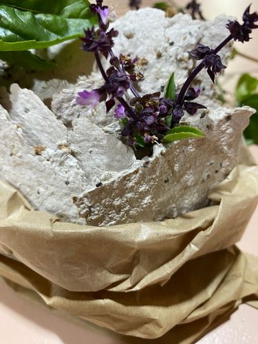

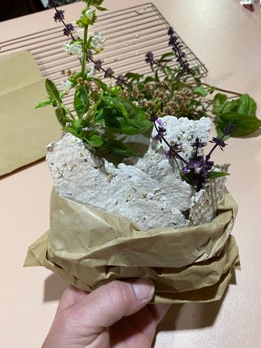

Completely dried out now, I broke my Plantable Seed Paper into crackers lol. I wanted to keep it natural and you can see the torn frayed edges. I’m going to give these away.
Step 9
9/10
Step 10
10/10
Placed in brown paper bags ready to be gifted.

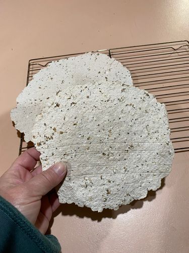

Well it’s been an interesting experiment and definitely takes practice !!!
The first way I made the Seed Paper was easy and great for a beginner like me.
Today I had a practice run with a large bucket, more pulp and a different technique.
The results are in and geez it was harder than expected BUT I won’t let that put me off trying again.
It’s certainly a good learning experience and it did not cost me anything , so nothing to lose.

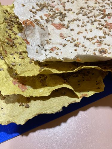

This time I wanted to try and make a thinner paper.
YES it worked if it was only paper, no seeds added.
NO the dried flowers, husks still holding seeds didn’t press in at the paper is so thin.
YES for the tiny black seeds that did press in.
YES the embossing worked well using rough side of paper towels.
NO the beetroot colour did not work. Probably not enough for the amount of water.
NO the coffee did not work. Again, probably not strong enough.
YES the Tumeric worked and very dominant colour.
NO the brown Onion skins did not work due to not enough. I did cut up finely the papery skins to add some texture.
Making the finer paper you definitely need a larger amount of water and pulp in a larger wide bucket as you need to dip the screen in and out a few times to spread the pulpy liquid evenly which was quite tricky.
It was harder to peel paper off the towels being so thin it was tearing.
Anyway regardless of how it went, it’s a good learning process and it definitely takes practice.
These won’t got to waste, I will plant them out in Spring. I will upload a couple of pictures Katie.

Completely dry now. They look like giant papadums with bits on them 😆😆 not fancy pants, they will still grow and waste paper recycled, can’t complain 🌿😄💦
