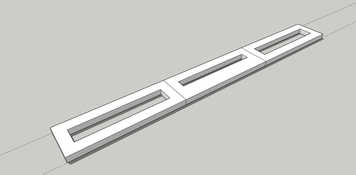

Re: Advice needed to lay brick raised flower bed

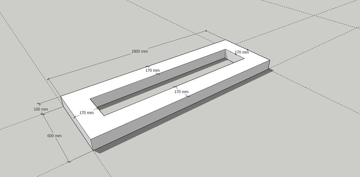

Thanks for updating us with the details of your plan. I've drawn up a quick sketch of your raised garden bed with seating based on @tom_builds recommendation of an open cement foundation. Please have a look and tell us what you think. Just to give you an approximation 4 inches is about 100mm +. Please note that the sizes indicated are for reference only, please adjust them to your needs.
Please keep us updated with your progress. We look forward to seeing your raised garden bed with seating assembled.
If you need more advice or information, please let us know.

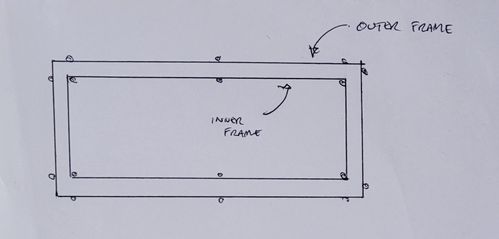

Hi again @Brunnie_Rich,
For pouring the foundation I would create a box inside a box like in the diagram below and then pour your concrete into the space between them. You will need to stake the frames, on the corners and along the width of the outside of the outer frame and the same on the inside of the inner frame to stop the frames from moving when pouring the concrete.
For foundation thickness 100mm is solid, although to build the frame you will probably find 90mm timber easier to get your hands on and for the purpose of a garden bed a 90mm foundation will be fine.
For the seat following something along the lines of @EricL's drawing is a good idea, that way you can either build a wooden or brick framed seat area. A strip foundation works best when load bearing walls run directly over it, which will likely be the set up of your seating area so no need to approach that area differently to the garden beds.

Hi @EricL ,
Thanks for the diagrams, really helpful!
My one question at the moment would be whether this would be advisable to use gravel underneath the concrete, or if it's ok to lay the concrete directly on top of the soil. (The soil is pretty well compacted)
Hi @tom_builds ,
Thanks for this diagram and advice - using less concrete would be preferable so this sounds like a good direction, I think I'll use this method.

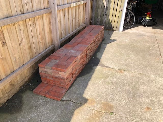

One extra question I've thought about whilst typing, is about the height of my bricks and the stability of retaining the soil.
I'm looking to recycle bricks reclaimed from the previous use (see attached pic). They're half sized bricks (in height, but the footprint is the same as regular house brick) and I intended to go about 8 high max (measuring 40cm, then adding 1cm of mortar in between would make it approx 48cm high total)
Is this height ok in terms of stability? Eg. could there be too much stress from soil volume to crack the walls (i'll also be looking to render these and paint white)?
I was envisaging laying bricks in a single line in the usual manner.

At 48cm high, I don't believe you'd experience any issues with stability, but @tom_builds might like to give his thoughts as well.

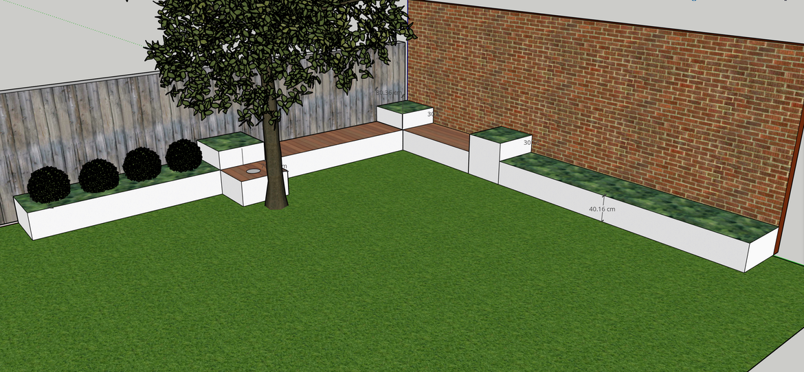

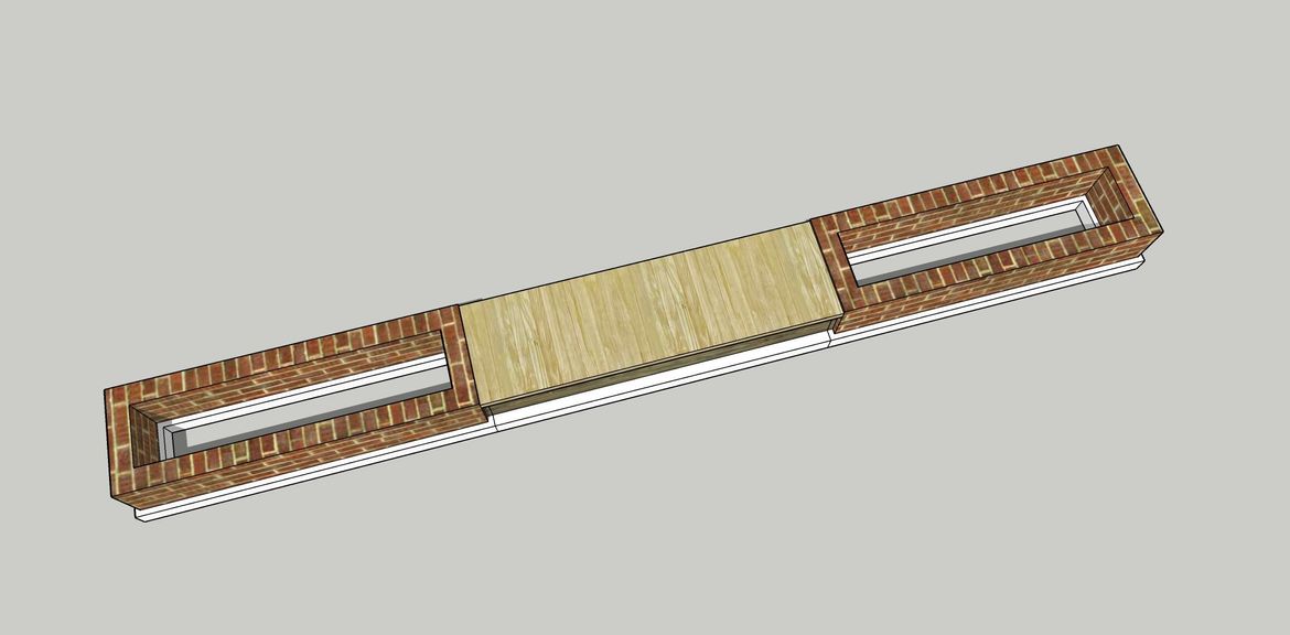

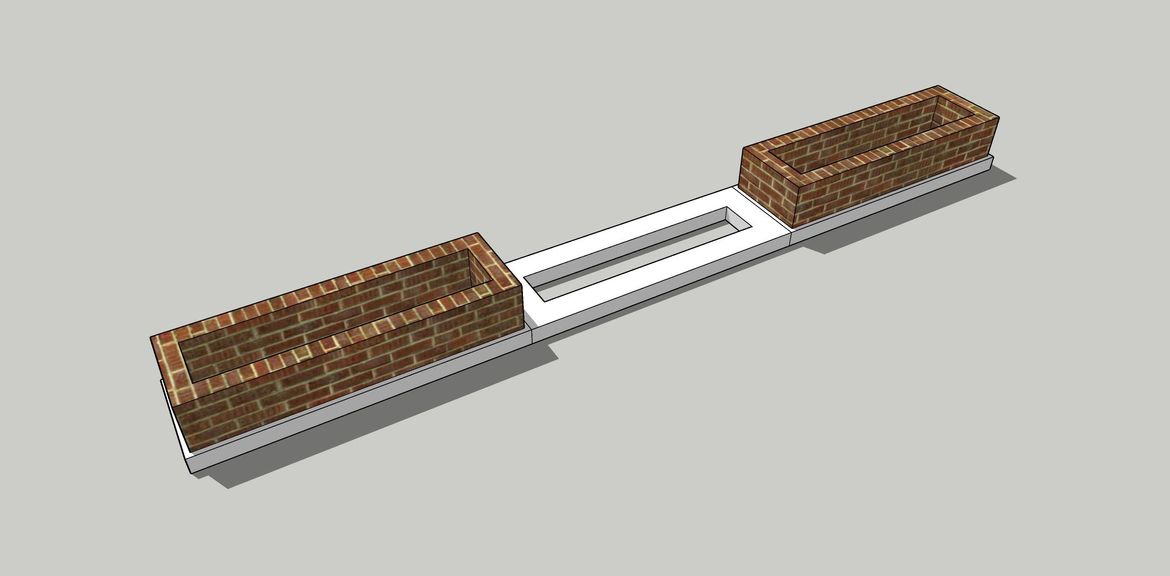

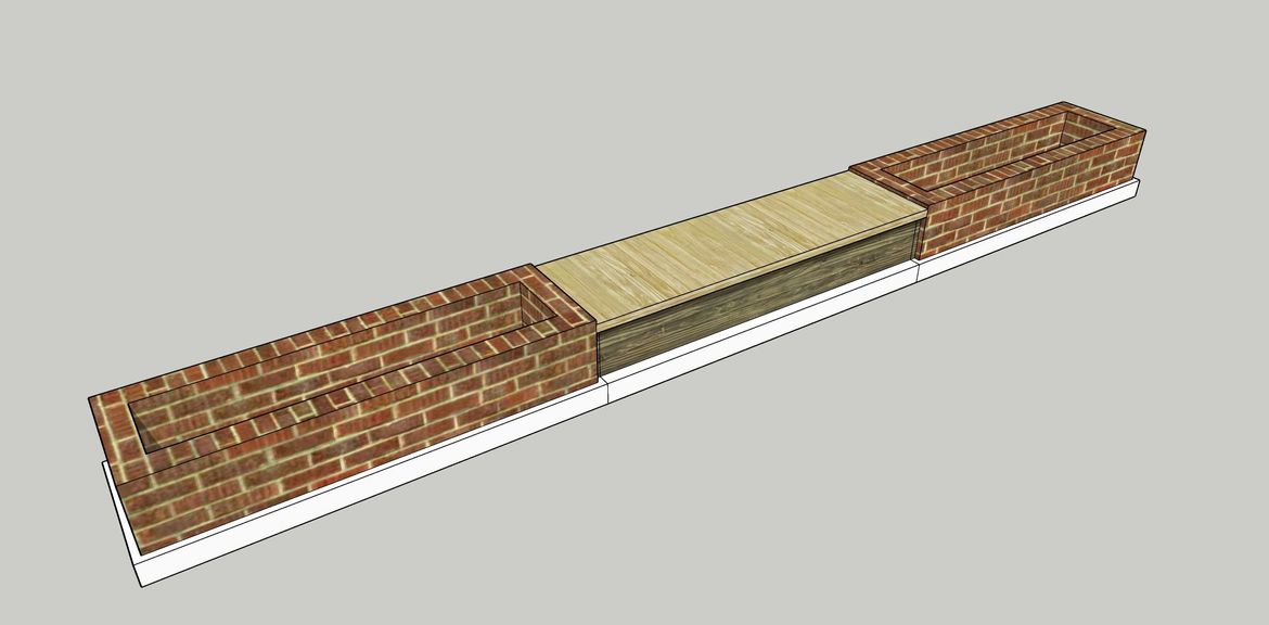

I've uploaded a sketched model of what I intend to be building in the space. I'm hoping to complete the seating area independently of the raised beds either side, so would be laying those concrete foundations separately over time.
