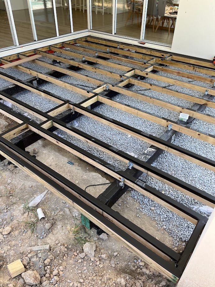

Hey all, I am looking for ideas on how to fix a drainage problem I have. As you can see in the photo this area gets “flooded” whenever there is heavy rain. A Deck will be built in this area and ideally there should be minimum water sitting there as possible.
So looking for idea on how to address this issue.
Thanks!
