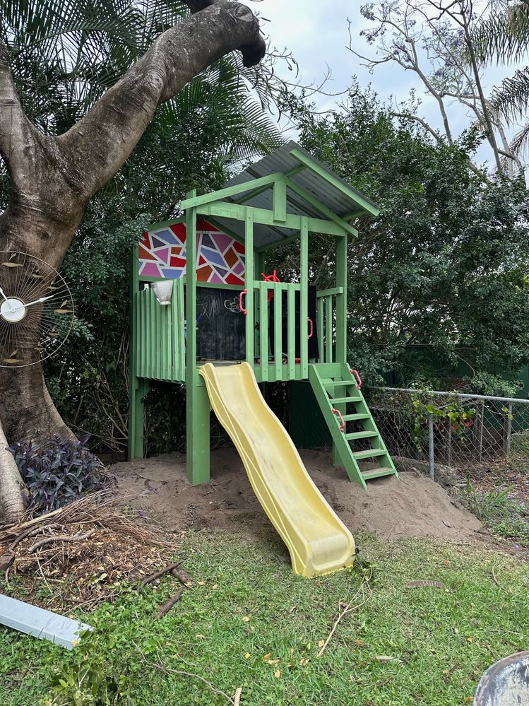

I did a little treehouse for them in the UK which was a fun build - should have taken a snap of the steps I build between the tree and the shed, took hours 😂:
They got gifted a pretty decent cubby house on stilts here, so extend that with stairs to a platform on the tree beside it is the idea 😅 - probably one for me to start a thread on here! The cubby I'll need to build onto -
