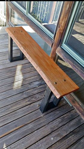

I want to build a garden bench like the one in the photo and I already have a sturdy top sleeper and wondering what wood would be recommended for the legs?
Any other advice would be great. At this stage I’m just planning to sand the current sleeper and then oil it and then attach the legs to it.

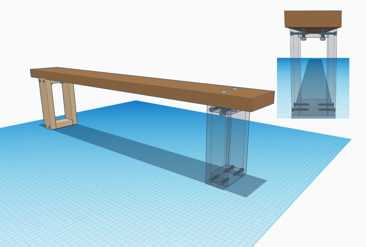

It appears that the legs on the bench in the image were created with something similar to 90 x 35mm H3-treated Pine. The legs would be a very simple construction, screw four sections together and bolt the top on. I've created a rendering below for you to illustrate better.
Be advised that to use a sleeper for a bench, it should be treated in something other than an arsenic-based preservative. Also, remember your PPE when working with timber, including a dust mask, safety glasses and gloves.

Cup head bolts would be the way to go, @totocol. Make sure to grab some long enough to pass through your seat and the leg frame.
