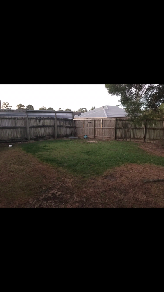

I started with a bare desolate space and turned it into our little piece of paradise.
C103B73B-3D92-47D1-B3B6-61F84DB24865.jpeg2218EC6F-5581-42EF-A948-4105A3C97016.jpeg95F3AF87-AF83-4CCC-8D33-03C8C261BE41.jpeg0697F3D6-AE8B-4410-AE26-8C8D8F114366.jpegA2BD7A73-5B80-419E-9509-4112365A4937.jpegThe blank canvas !The blank canvas !148E4BFC-7E35-42C6-B471-50B9C59FD152.jpegBEB951D8-6651-4854-B707-BDA45B15D194.jpeg64996FCA-4296-4A37-B6D7-7447EA642A0F.jpegAEB5F26F-98F1-4078-8EDB-1E0BEB50F432.jpegAA56FF2D-4BB9-49DD-8712-F6D43B8F1F56.jpeg42DC759A-1960-4731-B0BF-0DA2EC40498D.jpegF9F7B208-BA4B-4EBA-B6A0-48F28C0DE1A9.jpeg

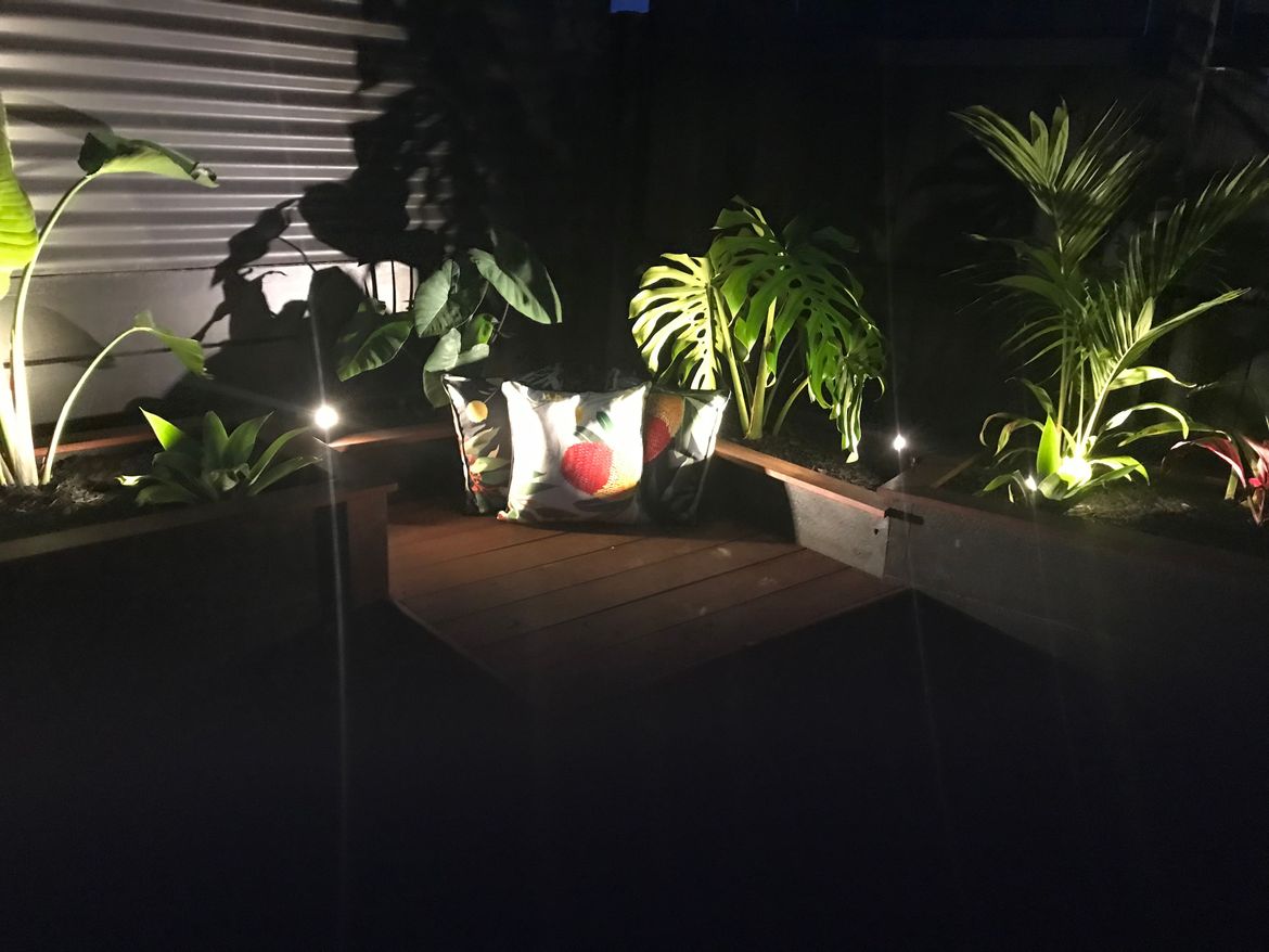

What a fantastic garden transformation, it really feels like a piece of paradise. I love how you disguised that overflow pit opening into a clever sitting area. The plants have really softened that harsh fence line and the installation of the lights just finishes the entire look. How long did it take you to finish the project? Did you run into any other difficulties while revamping the area?

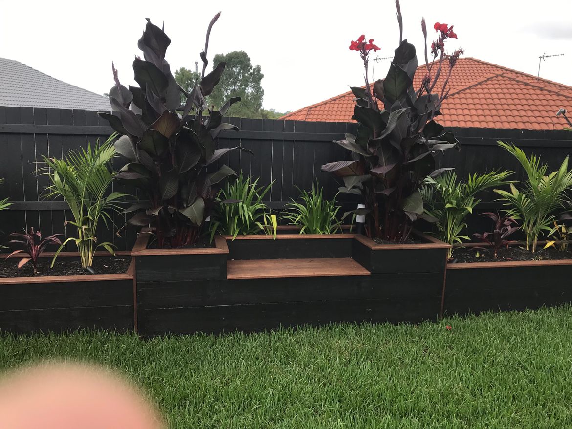

It took me about 6 weekends, juggling kids and other commitments, to complete the boxes , I was a bit slow as I have never done anything like this before. All the soil and mulch had to be brought in by buckets as the side access was limited it took some time!
Getting the boxes level caused a few headaches, and getting the angles on the all the cuts was a massive challenge as it was all new to me ,and also a bit scary using a drop saw for the first time, the knowledge I got from the Bunnings team was so valuable to me ,they must Have been sick of the site of me.

So Nidge, how did you line your boxes?  Does the soil go all the way to the ground??

Typically, weedmat makes a good liner, or if you want to retain the finer particles of soil as well, use geotextile fabric. I'll be keen to hear what @Nidge used on their project and if the soil goes all the way to the ground.

Hi , the soil goes all the way to the ground, to keep the weeds away I put a layer of cardboard at the bottom.
I also used some polycarbonate roof sheets to line the sides of the boxes to prolong the life of the boxes and to keep the soil from contacting the wood , I only used these as I had them left from the old roof I took down, I also painted the wood.

Let me tag @merim999 to make them aware of your recommendations. Thank you for that extra information about your raised garden bed. Although the sleepers are treated for direct contact with soil, the extra protection of putting in polycarbonate sheeting will definitely extend the life of the timber.

A little overkill I agree , it saved a trip to the tip ! There were many things I read about H4 treatments and I thought why not use them. On the seating area I used sienna pine as there was going to young kids sitting here at times eating.

That was an excellent choice in using the sienna timber as it is treated in copper azole and is safe for direct human contact.
