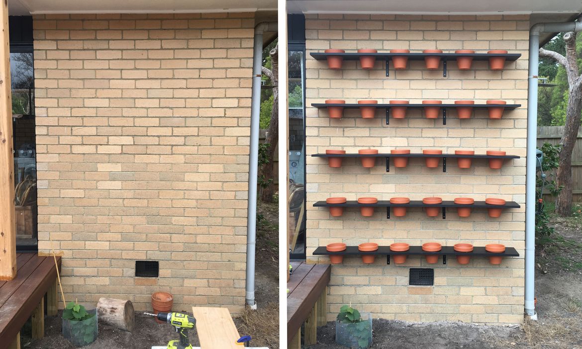

This wall is at the rear of our house, it’s part of an extension built sometime during the 80s. Since we recently built a new deck we’re spending more time outside and this plain wall has become a bit of an eyesore. It needed something.

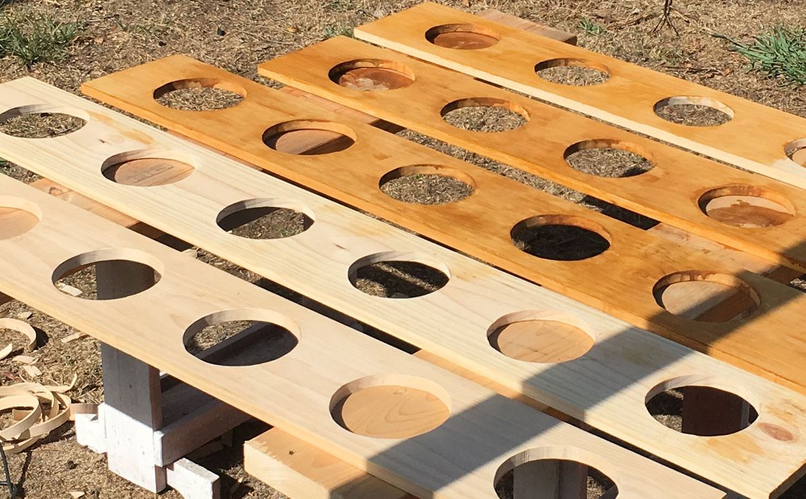

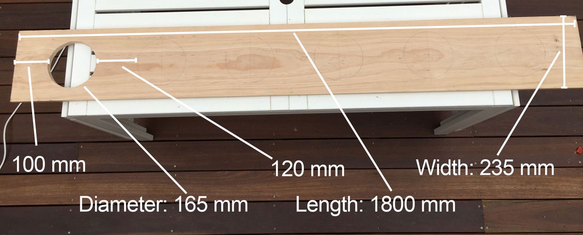

‘Measure twice, cut once’ they say. I tried that but I still messed it up. Turns out the pot that I was basing my measurements on was a slightly different diameter to the bulk lot of pots (30 in all) that I bought. So, the 30 holes I cut with the jigsaw? Wrong. All wrong. I ended up having to make them all a bit bigger to accommodate the slightly larger pots. Lesson learnt.
So I started re-cutting the holes. It was at this point that I snapped my one and only jigsaw blade while re-cutting the first hole. No back up blade? Yep, another rookie mistake. I’m now an expert with a jigsaw and I have a big packet of blades so I’ll never run out mid-way through a job again.
You can check out the measurements I used (above), hopefully it saves you some time.

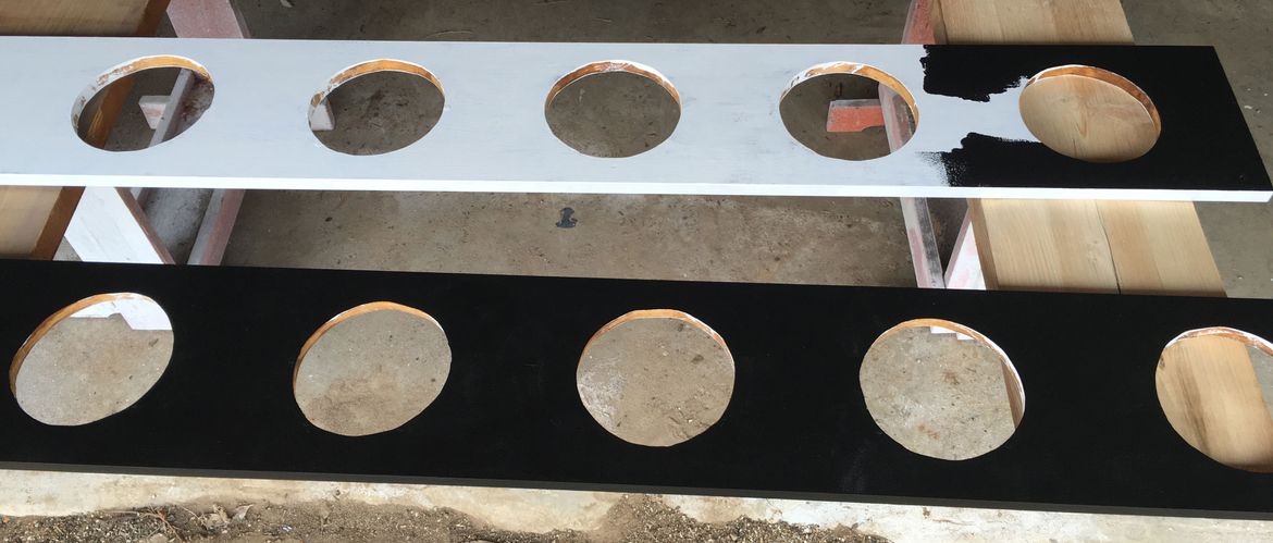

Recently I oiled our deck and it turned out pretty good (just don’t mention the drips down the side). So I figured I’d oil the shelves – what could go wrong? Plenty.
First, I bought a cheap brush (mistake No.1), then I rushed the job (mistake No.2) and ended up with drips and some areas darker than others. It looked bad. I knew it looked bad because when I asked my wife what she thought she just kind of nodded, smiled and walked off. Never a good sign.
So to cover my gaffe I undercoated with an oil-based undercoat then carefully applied two coats of satin black paint with a roller. An expensive roller.

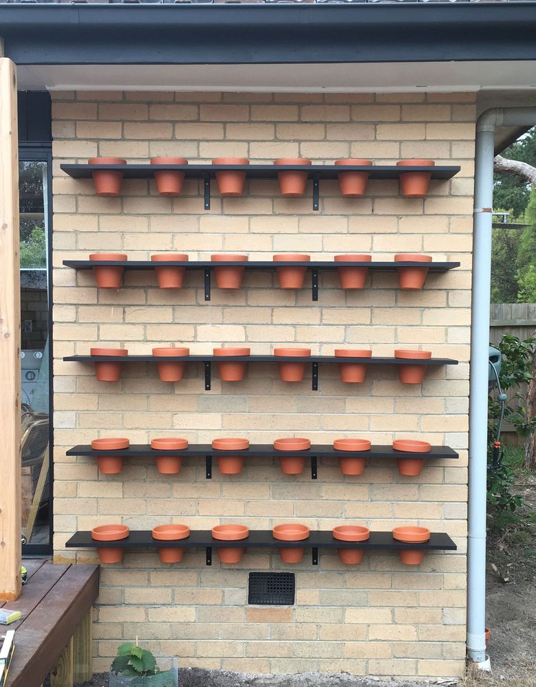

The finish was much better, check it out in the picture below.

Next step was to screw the brackets to the brick wall. I used a 6mm masonry bit, two to be exact – half way through drilling holes I managed to snap the first one. It’s still embedded about an inch in the wall. I also used some 5mm plastic spaghetti and some 75mm screws.
The trickiest part here was getting the brackets lined up in a straight line. To do this I clamped a couple of stakes either side of the first L bracket to ensure the one above it was held securely in place while I drilled the holes (see below).

This is the best looking vertical bed I think I've seen and it's inspired me to give something like that a go. Terracotta is fantastic to start seeds off as well, as it keeps warm after the sun's gone down, but they do tend to dry out quickly for the same reason. I could see a simple watering system working here and a spray of water would really add to the effect on a warm evening. Strawberries and chives would be fantastic; they have shallow roots and it's nice to reach over from the deck and pick them fresh for brekkie. I also love the fact that snails would have trouble pestering your plants. Nice job!

I do have a small concern though. Timber being what it is, and the mounting brackets placed where you have them, particularly with the pots gaining weight with dirt/plants/water, those boards will slowly warp over time and sag at the ends. For a few dollars more for 10 extra brackets, I would put another bracket at each end of the boards and it will stay looking a top job for a whole lot longer.
