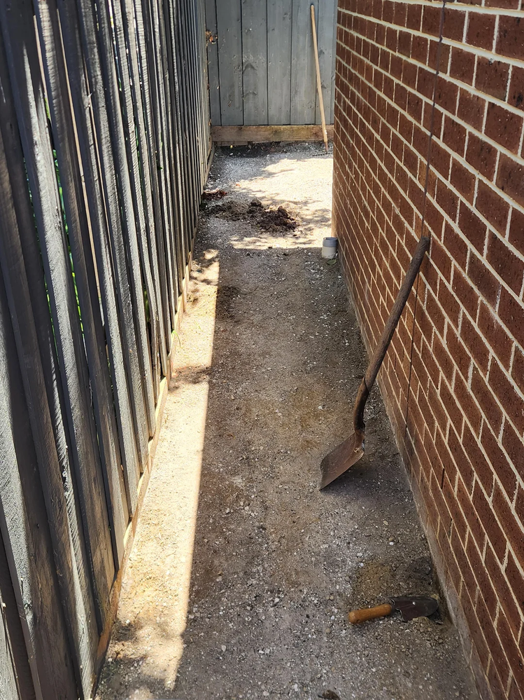

1. Water never pools there, but is there anything I need to do to make sure it's safe for plants? When I dig a hole into the dirt there is the slab foundation that seems to slope outwards from the slab towards the fence. I'm guessing this is on purpose to assist with drainage away from the house?
2. I'm not sure about soil against the bricks? It seems in the second picture they have done soil directly against the render of the house? So is it OK?

The soil in this area may not be ideal for planting, so it's important to make a few adjustments to ensure proper drainage and avoid any moisture issues near the house. First, I recommend removing about 100mm of topsoil to lower the level of soil beneath the bricks. This will prevent water from pooling against the bricks, which could lead to moisture-related issues like dampness or damage to the wall.
For the paver area, you should compact the ground where the pavers will be laid and set them on a mortar base to ensure they stay stable and even. After placing the pavers, you can backfill the gaps around them with quality soil, providing a good base for your dichondra ground cover. This setup will ensure the soil doesn’t sit directly against the bricks, reducing the risk of moisture wicking into the house, which could cause problems over time.
Regarding the existing soil against the render in the second picture, it's generally not recommended to have soil directly in contact with the wall, as it can lead to moisture accumulation on the walls. Lowering the soil level and ensuring proper drainage will mitigate these risks and help maintain a healthy environment for your plants while keeping your home safe from water-related issues.

I've just started digging some holes to get an idea of things.
I've tried to dig below the lowest brickwork and have hit concrete?
Basically what you see in the picture is very rough concrete
Is this typical? I fear this will ruin my plans!

Afternoon @wearingshoesinv
That "rough concrete" is the foundation of the house :smile: It generally extends out by at leats 20cm from the wall if not 30cm depending. So many time I have hit tha but putting something too close to the wall  :smile:
You could always remove the soil to that level and use that as your basline level?
