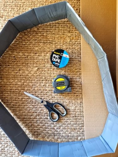

You need to make the stepping stone template. Cut a piece of cardboard 10cm high and as long as you wish (this will depend on the size of the stepping stones you want).
Wrap the cardboard in the duct tape and join both ends together. Do a few of these so you can do a few at a time. I made five and reused them a few times.

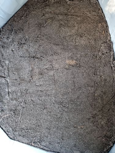

Prepare the area. I placed mine under a the tree in a bare dirt patch so there wasn't too much prep for me although I did flatten and compact the ground with a homemade tamper. You may also need to use sand or gravel here although I didn't my soil is quite sandy.

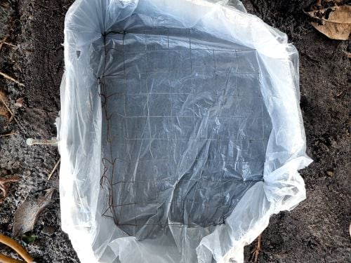

Place a template in the shape you are wanting. Cut a piece of the plastic drop sheet and lay inside and peg template down. Cut chicken wire to size and place inside.

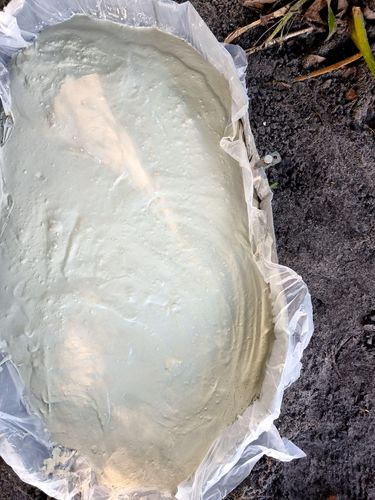

Mix cement as per instructions on bag. Depending on your drill you can buy a mixer attachment or you can just mix by hand. Pour cement and level the best you can, remember you want them to look natural so I did this by hand and didn't make it too perfect.
Tip 1: Use safety gear while completing this
Tip 2: Think about the colour of the steeping stones you want and use a cement that will help align with your vision.
Tip 3: White cement goes off quickly so do not let it sit too long before starting the project. Some of my steeping stones took a lot longer to get the look I wanted because of the lumps.

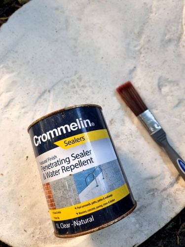

After waiting a week take the template away, give the top & edges a light sand and seal.

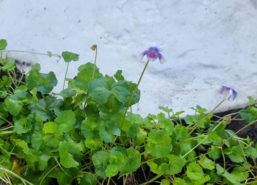

I have started planting native violet & dichondra around mine.

I had not thought of sealing the steps, but your idea is fantastic as it will extend the life of the concrete by preventing mould and mildew from infesting the body of the step.

Yes working out how to do the form work was the longest part of the process. I had been researching how to make concrete steeping stones for a while and it seamed all the form work I had seen was too structured or from a material I couldn't find in australia/order online. I even looked into if I could use garden edging but again it gave me less opportunity to make them a unique shape which I think makes them look more natural. I remember thinking cardboard would be perfect but it would get wet and break from the cement, that's when i come up with the idea to cover it in duct tape.

The white stepping stones and colour pop of the bromeliads looks great. You will have to share an updated image once the native vilot grows out.

Native vilot has taken off now, every so often I touch up the stepping stones with lime wash to make them look fresh & white again as some of them discoloured from the tannins in the leaves.
Still so happy with the outcome, exactly what I wanted for a fraction of the cost.
