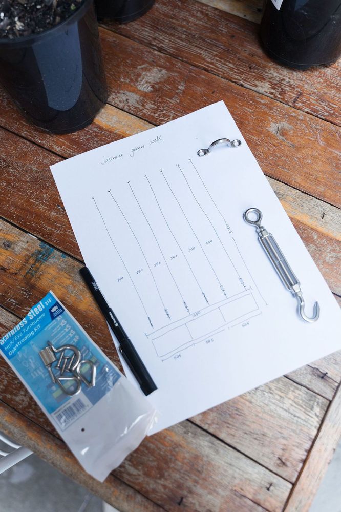

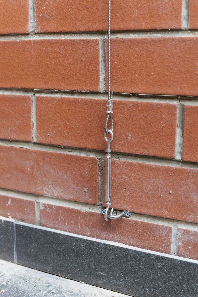

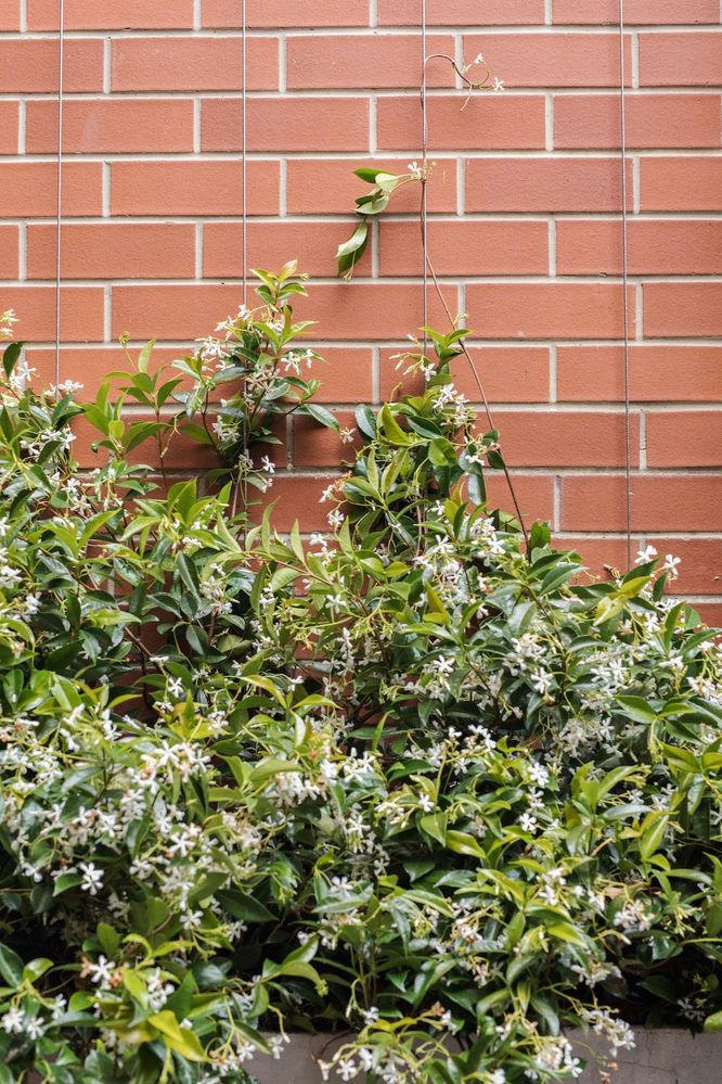

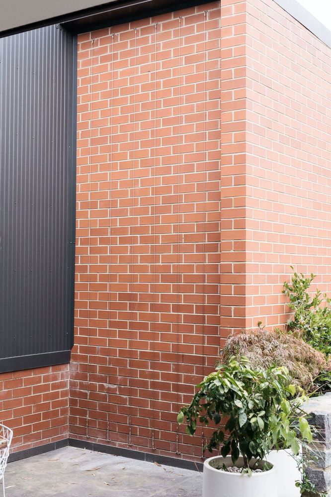

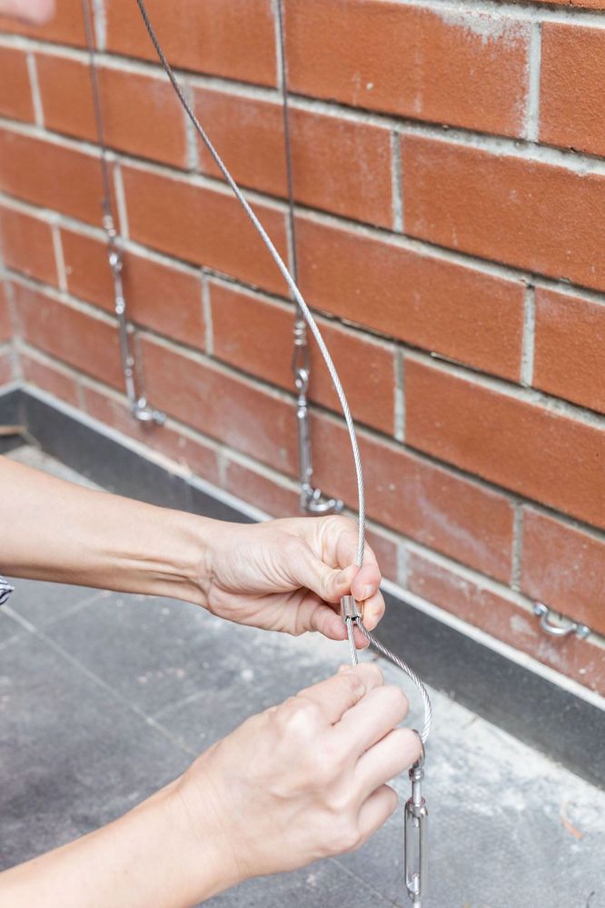

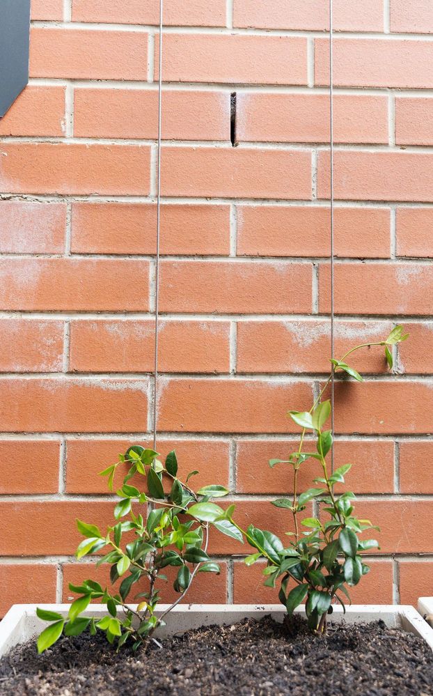

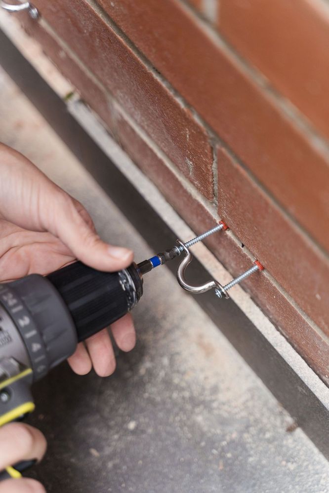

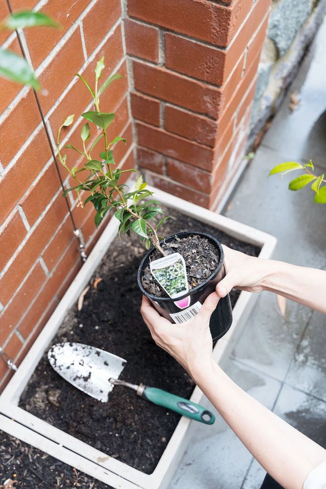

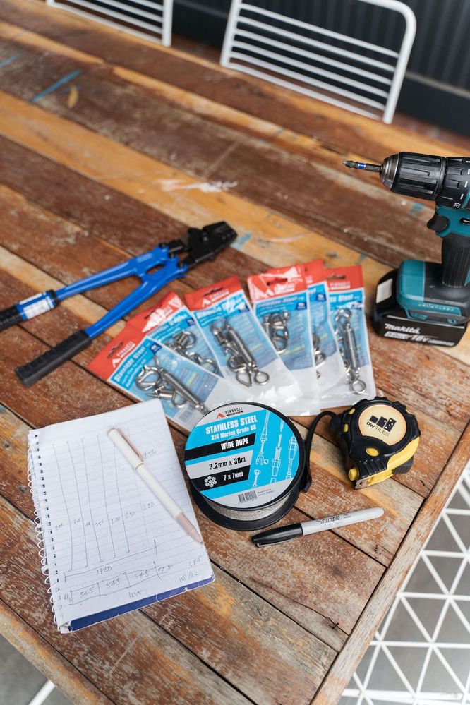

Newly-planted-jasmine.jpeg These are the materials I used These are the materials I usedFirst I sketched up a rough plan, 6 wires spaced equally apart Then I cut the wire to length, allowing approx 20cm more to loop the balustrade fixings Then I added the balustrade fixings And secured these to the wall using the brackets from the balustrade kits And secured these to the wall using the brackets from the balustrade kitsHere's a close up of how it fixes to the wall Here's a close up of how it fixes to the wallAnd this is the final result And this is the final resultI then added some pots in front and planted my jasmine I then added some pots in front and planted my jasmineIt's taking off and I can't wait until the full wall is flowering It's taking off and I can't wait until the full wall is flowering

This is lovely! Did you have to pot them on the ground or just on the rectangular container of the photos? How long did it take you to get to the level of plants you've got?

I potted the plants into the rectangular pots as this is a tiled outdoor area. If we had a garden bed, I wouldn't have bothered with the pots though :wink:
The plants took about 5 months to get that height... although in winter I expect the growth will be a bit slower.
