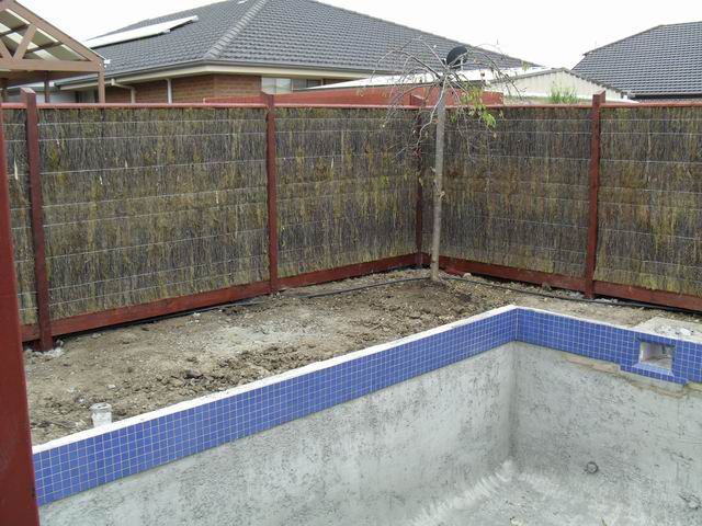

Looking into putting up a Brushwood fence and wondered if anyone out there had done it before??
main questions was with the framework. was it better to use timber or Galvernised Steel?
Exposed timber posts put still keeping the rails out of sight
Best methods for securing the brush

I've seen both timber and metal frames. Prefer the timber look if the frame is exposed.

I've watched those two old boys on YouTube. GalvSteel seems to be the way to go talking to people, due to keeping the moisture out. Just not much of a metal man myself.
I do like a touch of Timber framework in there with the Brushwood, my olny doubt is there been a visible frame work to be seen on one side, due to the rails on the fence frame. Would be a bit expensive to double side it. Will keep digging.

If your going to cover an existing steel fence, just use a25mm thick brush cover sheet rather than a 40mm full weight brush panel.
You can cut into the panel just don't cut through the seam, breaking this will make it all unfold.
Cable ties would not be strong enough. I would use wire instead. Maybe also have a horizontal wire running across. Top middle and bottom.
Brush panels are normally screwed and tied into their framer work.
Make sure your existing fence id starting enough to hold the weight. Brush panels are very heavy

Do you have any further advise on how to install 8 3x1.8m panels of Brushwood screening along an existing colourbond fence? What is the best way to attached the screen to the fence. Thank you.

Instead of fixing the screening directly to the fence, I'd recommend installing guidewires onto the Colorbond fence and then attaching the screening to that. Position the guidewires at the same height as the wire used to hold the brushwood together. You'd need at least three, and they are best placed at the top, middle and bottom of the brushwood. The wire can be attached to the fence with Tek screws. Make sure to pull the wire tight between the Tekscrews, which you've fixed into the fence's upright posts. Wind the wire around the Tek screws several times to hold it in position. Once the guidelines are in place, you can attach your screening to them with netting clips. The clips will go around the guidewire, and the wire used to hold the screening together.
This might appear to be more work, but once the guidelines are in position, it will be a sinch to fix the screening in position.
