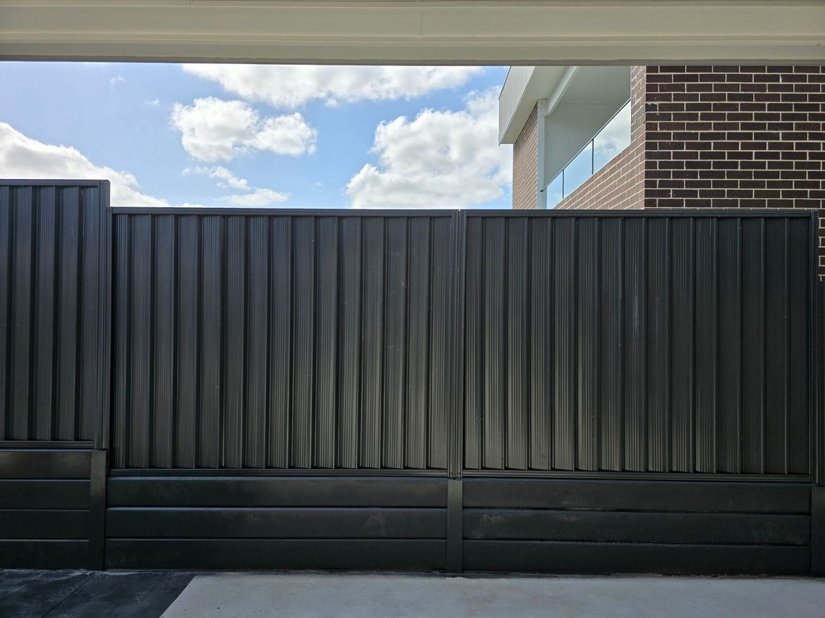

I'd like to install a fold-down clothesline to the fence shown below:
It's a colorbond fence which sits on concrete sleepers. The width of the sleepers is 2.4m, and the distance between the edge of each post is approximately 2400mm as well.
I've found a clothesline that I like, and the distance between mounting holes is 2260mm.
Now, I appreciate that while the fence panels themselves will hold the weight of the clothesline, adding a few loads of wet clothes is basically a disaster waiting to happen.
I also don't particularly want to install mounting posts bolted into the concrete slab below either.
What I'm thinking of doing is inserting timber strips - perhaps a 90mm x 22mm decking pine piece into the rail in front of the fence panel, screwing that into the rail, and then screwing the clothesline mounting bracket into the pine.
Any thoughts on whether this will work? I'm worried that although the timber pieces will help hold the clothesline up, the shear forces through them may cause the rails to bend and eventually fail.

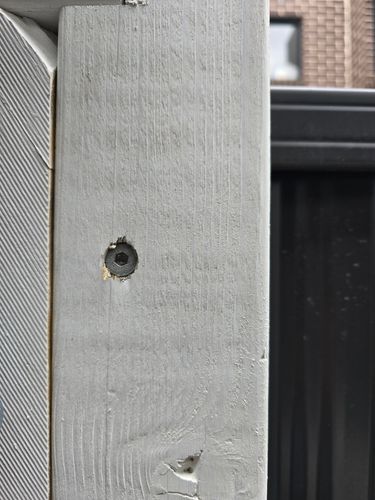

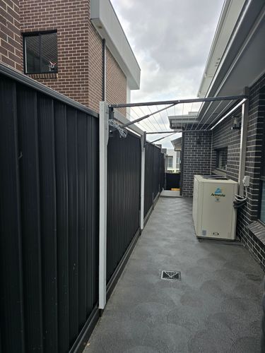

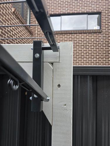

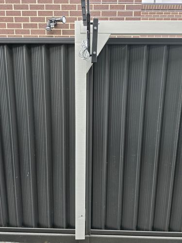

Thought I'd post an update on this mini project.
I created a frame using some left over H3 treated 90x45 pine. Cut out some notches on the posts so that the horizontal beam could rest on them and added triangle off-cuts to add rigidity and surface to screw the clothesline frame into.
Primed everything, and was about to pre-drill and screw everything together when fortuitously the carpenters arrived to do some work. Got them to nail the frame together using their Paslode nail gun (I so want one but have zero need for it), and then they also helped me attach it to the fence posts using bugle screws.
Need to apply final coat of Monument paint to finish it off.
Happy to report that it's very sturdy and has been getting a workout with lots of bedsheets and quilt covers in the recent hot sun. Also approved by SWMBO so happy life.
