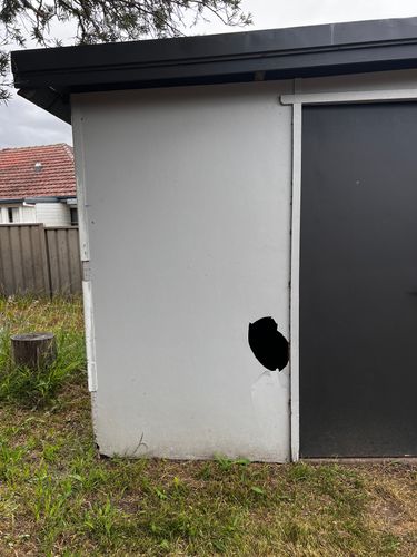

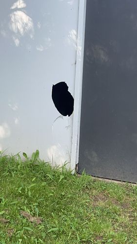

 I’ve had the hole in my shed wall made out of fibre cement an I’ve contacted quite a few people who won’t touch it because there might be asbestos, is the anyway of patching this?

The first thing to do is have the shed tested for asbestos before you attempt any repairs. If it is confirmed that the material is not asbestos, you can use the following methods:
To patch the hole in your shed wall I suggest using 2400 x 450 x 4.5mm Durasheet FC Lining. Cut the FC sheeting into a square shape just slightly larger than the hole. Use Selleys heavy duty Liquid Nails on the side of the FC sheeting and place it over the hole. Remember to apply only on the sides of the patch as there is nothing in the center to attach to. Push the panel firmly into place and use Tarzan's Grip 5m Super Strong Duct Tape to hold the panel in place while the adhesive cures.
Because you are using heavy duty duct tape, you can choose to leave it in place until the weather strips it off. If you have any leftover paint in the shed, I suggest painting the patch for extra protection.
The other option is to replace the entire panel.
However, once again please prioritise your safety. It is essential that you have the shed tested to know what you're dealing with.
