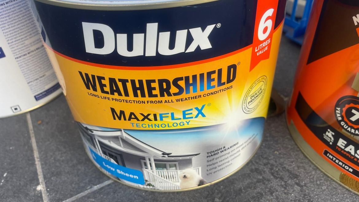

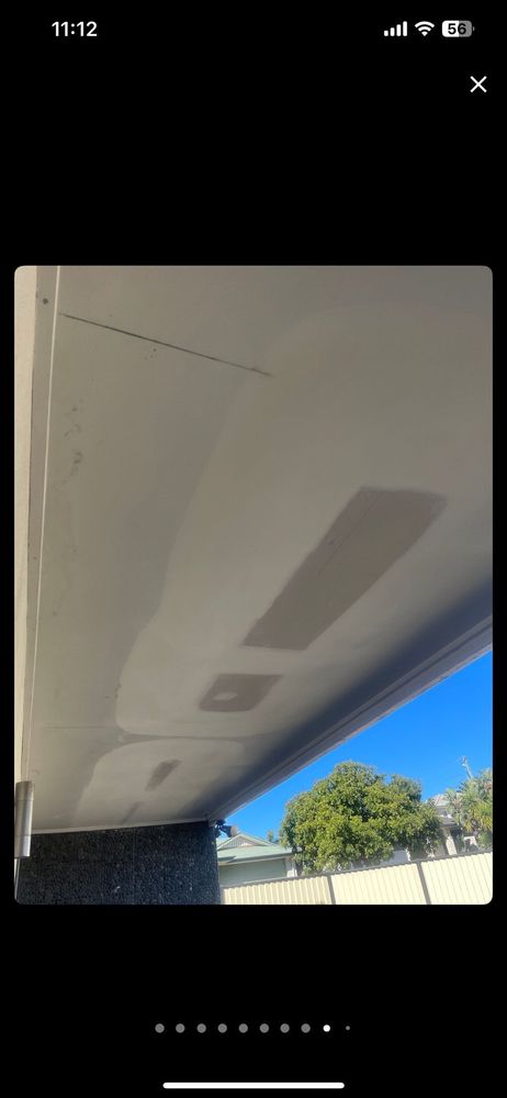

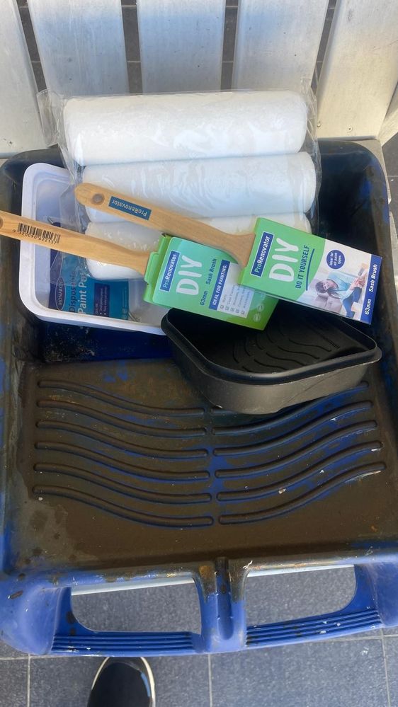

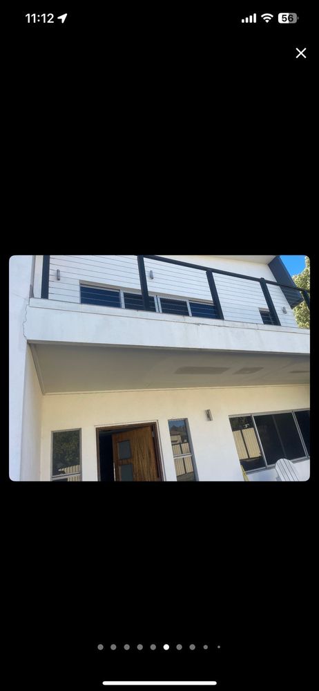

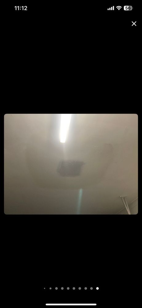

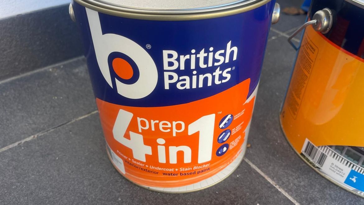

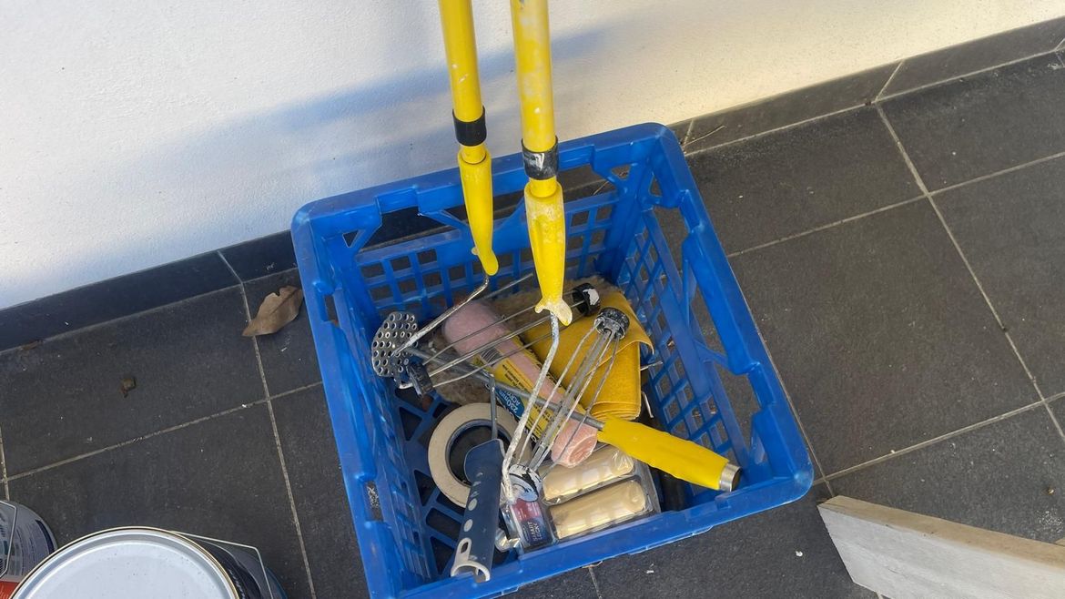

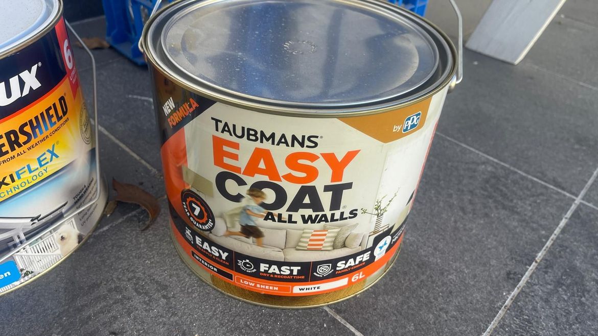

Hi, I'm going to paint the ceiling under the balcony (outdoor) need my front door, and the ceiling for my garage, these are what I bought from bunnings and some tools as well. Can I use what I have for both ceiling? and what's the order sequence to apply these products. If I need anything extra, please advice so I can get them today. Planning to do the job on Saturday this week. thank you much for your help.WhatsApp Image 2024-07-31 at 11.00.07_f79c2191.jpgWhatsApp Image 2024-07-31 at 11.00.07_1fd79c2a.jpgWhatsApp Image 2024-07-31 at 11.00.06_1d9f0322.jpgWhatsApp Image 2024-07-31 at 11.00.06_30083ec5.jpgWhatsApp Image 2024-07-31 at 11.00.06_ff20900a.jpgWhatsApp Image 2024-07-31 at 11.13.45_6c1a91de.jpgWhatsApp Image 2024-07-31 at 11.13.48_4d4d420d.jpgWhatsApp Image 2024-07-31 at 11.13.49_2a449a66.jpg

Looking at the pictures you've posted it appears you have all the necessary equipment to paint your ceiling. However, I suggest adding a few bags of drop sheets to protect your floor from accidental paint drips and spills. Your picture includes the Taubmans Easy Coat and the British Paints 4-in-1. The British Paints 4-in-1 is a primer and is the first coat placed on the surface. Whereas the Taubmans Easy coat is paint designed for interior walls. Where will you be using this paint inside the house?
The Dulux Weathersheild can be used on your ceiling for your balcony outside and inside your garage. My best advice is to make sure your ceiling is clean and free of dust before you start painting. Please remember to give each coating enough time to dry off properly before putting on the next coat.
