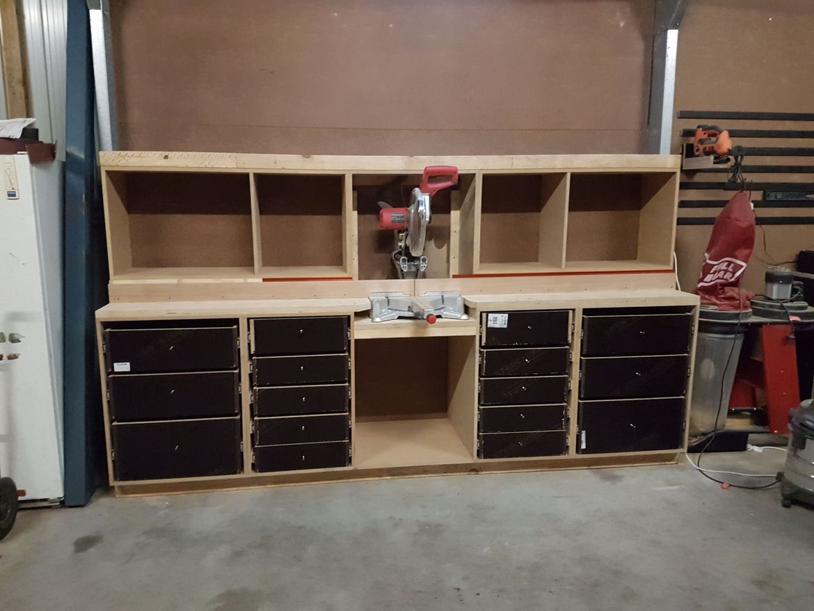

Here is a build that I did in my garage. It is made mainly out of 18mm MDF. I have attached a before and after photo. The vertical draws are to hold 1lt paint/stain cans. It has plenty of storage.

That's a serious setup you've created yourself there, I'm very impressed and a bit jealous. Did you use Formply for the draws instead of the MDF?

Yes I used the NON structural formply for the draws and ply for the draw bases. The draw fronts are MDF with 2 coats of High build spray putty, sanded smooth and then 3 coats of gloss black. It came out super smooth and might have to much shine for the garage.

Awesome! Where did you get the T-track?

Gday mcandrew, I got the T-track from Hare and Forbes. Think it was about $30 for 1.2m piece, so I got 2. Pretty easy to install with a router.

Tell me what are the 6 vertical sliders on either side of the dropsaw? How do you use them? I need to do something similar, so other people's successes are always a good guide!
