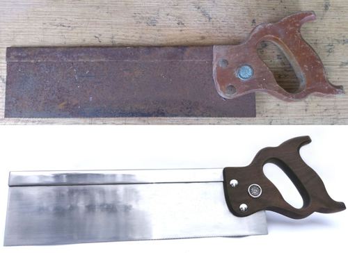

I just read about some guy wanted to remove rust from his fathers old tools, well I used to make, restore and repair furniture, i worked from home and I used old tools. A quiet a few I still have but not used in many years about 26 year in fact. I would also pick up some from garage sale but in a lot of cases rusty, the best I found that killed the rust was Molasses, you could buy it at most hardwares, famers feed their cows this stuff in the old day. you mixed it with water then leave it 2 or 3 hours or a day, on really bad rusty tools may be 2 or 3 days. And it was cheap, did a briliant job on rust, make sure you treat the tool after with kill rust or some rust preventive after you have finish cleaning everything up. I hope this helps anyone who love old tools and uses them like I did.

Thanks very much for your brilliant tip about using molasses to clean rusty tools. Some years back another community member here, @Super_D, posted some great photos showing what a terrific result he got using molasses to clean one of his father's rusty tools.
